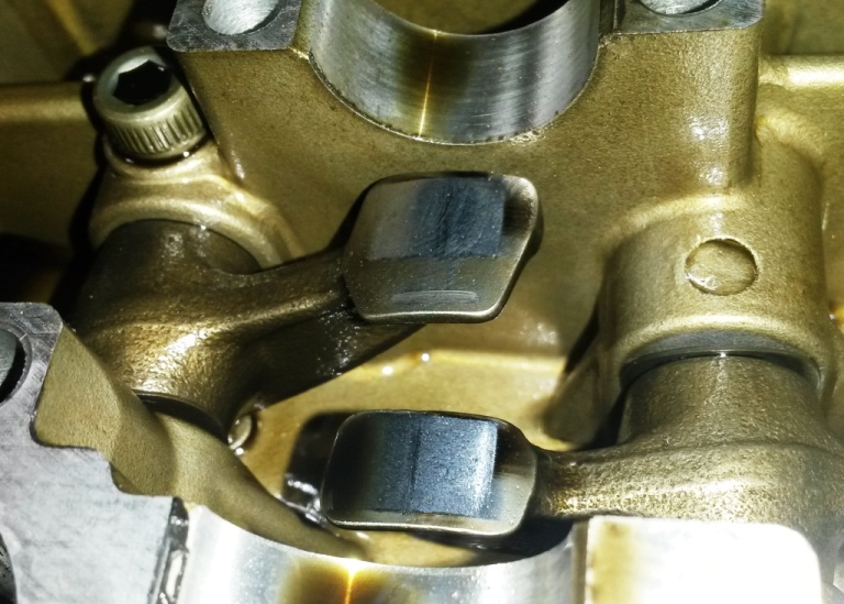

What i noticed is a snapped Cam Chain guide and scouring on rocker arnm where the Decompression pin hits it "momentarily"

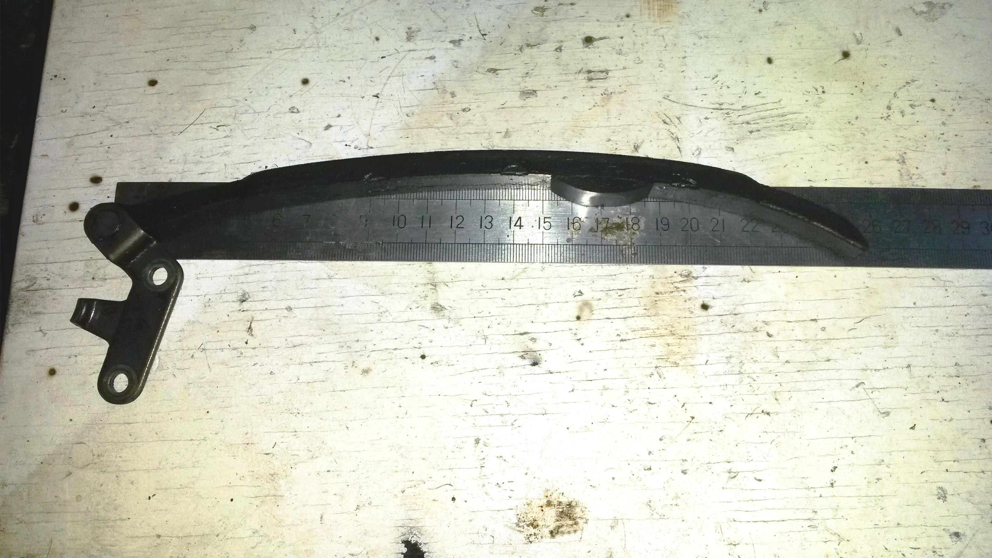

First picture is the snapped Cam chain, I measured it and got 25.3 cms, does anyone has a new/used and measure it for me so I could determine how much it s shortened and if it was the cause ?
Could it be the cause after all ? :?
Could it be that the auto decompression pin is not retracting back, i noticed scouring marks , picture below.
Is this normal I ride the bike almost every day so I start the MZ twice daily every day(deco only works on startup hence an idea of usage)

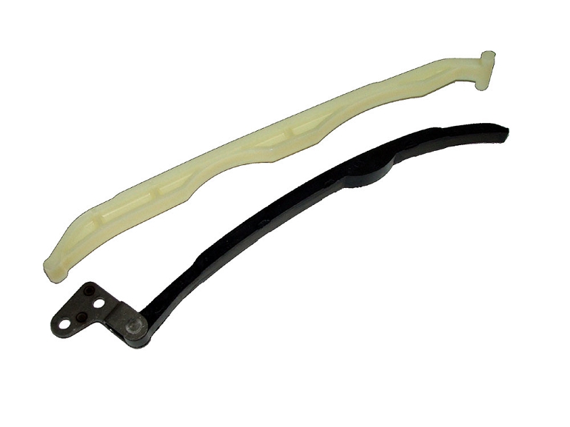

The chain guide appears to be normal length and the decompression pin has to hit the rocker arm to perform it's function. It only retracts once the engine fires and the rpms come up to idle speed. Did you check the valve clearances? They can make an awful lot of racket.

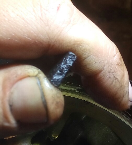

Thanks edf, no I did not, I should have. On the other hand take a look at this pic since the tip looks broken. I don't have a new one yet so I can't know for sure.

Lots of pics on the web to compare with. Looks pretty close to full length from where I'm sitting. ;)
