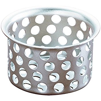

Don't get me wrong, I have nothing against a loud bike if it sounds right to my ear. My hopped up engine with full race exhaust, oversized valves, and high lift cam makes a hell of a racket when you get on it. It sounds like a pro level 450 dirt bike but on steroids. LOL
A baffle in the center pipe on the silencer might be the answer to removing the bite but keeping the thump. I had a v-twin for a while that needed some exhaust note tuning when I bought it. The aftermarket pipes were loud with no baffles but the bike preferred the back pressure of the baffles, which sounded like crap. So I did some reading and discovered that some people were using a particular sink drain strainer. No shit! It worked too. Made the bike sound like a big ole Harley with high dollar aftermarket pipes, and provided the back pressure that the bike needed to run right. Just need to drill a 1/4" hole in the inner exhaust pipe where you want the baffle and bolt it in with one bolt. There might even be some holes in there already for the gases to move around through the packing. Worth a try if you aren't happy with the sound.
