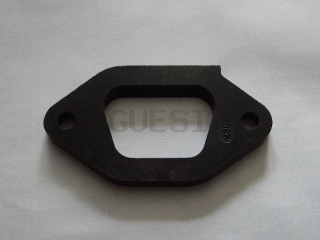

Does your intake gasket look this way :
https://www.guesi-motorradteile.de/pic_ ... CI0091.JPG
you have a 19 PS cylinder.(for carb 28N1-3)
If the hole is oval, it is a 17,5 PS cylinder.(for carb. 28N1-1)
