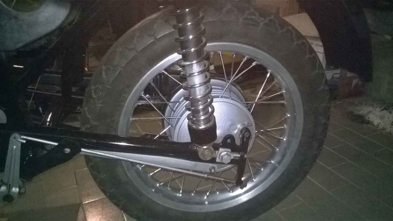

On your 3) & 4), rebuilding the wheels may help. Just a little teaser from my side:
