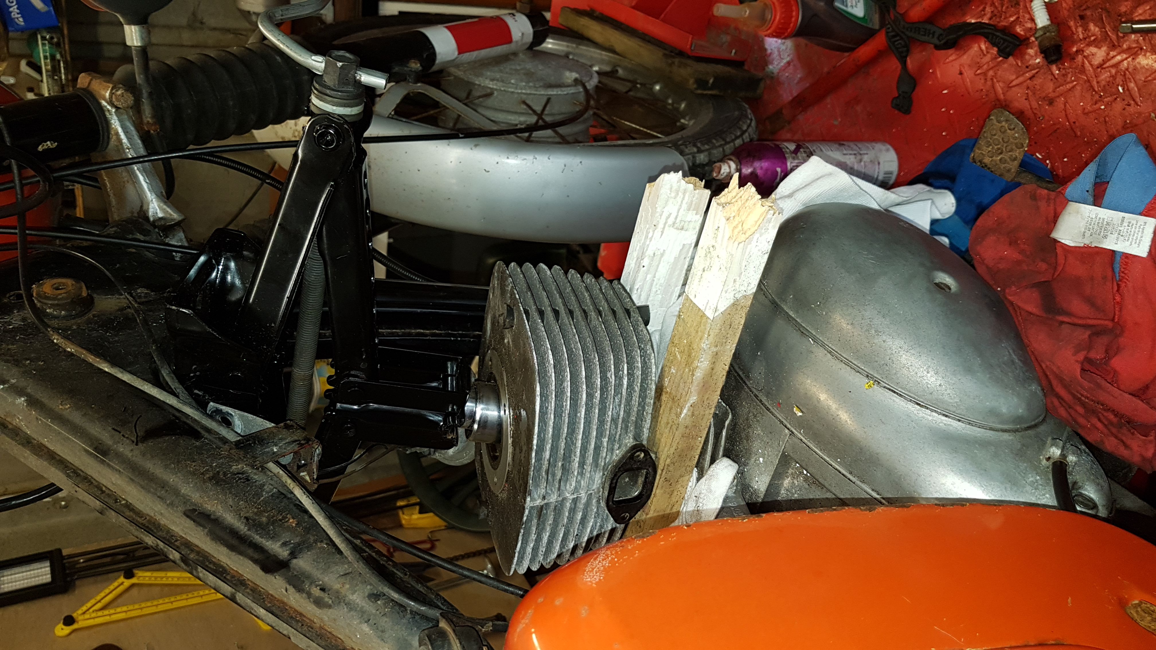

Postby shaunlacy » Sun Apr 08, 2018 5:46 am
got the scissor jack off my Landrover and created a screw - still no movement, blanked inside the barrel with a wooden insert so as not to damage barrel & piston!!!! AAAAAAgh!!!!
Properly seized

Re: Piston Seized in Barrel
Postby shaunlacy » Sun Apr 08, 2018 10:58 am
Broke Jack! other half furious lol! oh well, next idea . . . . .
Postby dirtsurfer » Sun Apr 08, 2018 7:54 pm
I would have thought something else would give before your jack broke. Whip the engine out of the frame and start pounding. Tell her you love her
Postby shaunlacy » Mon Apr 09, 2018 10:27 am
Hi, definitely not TDC, it dropped about 3/4 of an inch onto blocks, If i thought I could get e replacement barrel I'd cut it off but they look rare as rocking horse .....
That jack lifts my Landrover, so at least two tons of force applied before it buckled . . . scratches head . . .
On the plus side just been out for a good long ride on another bike so am chilled now, will look at it later in the week!
Postby dirtsurfer » Mon Apr 09, 2018 4:00 pm
shaunlacy wrote: . .
A good ride helps to clear the mind
Can you see where the bore is scored? If so you could drill some holes in the crown of the piston close to the side. Then inserting a narrow cold chisel or use a dremel to work away at the piston and rings in the bound area :smt022
