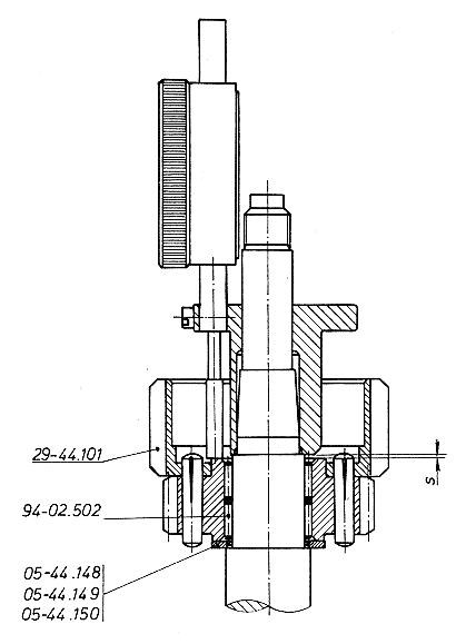

Postby manumensa » Mon Dec 14, 2009 8:23 pm
Hello beerbunny
Washer
"The axial clearance should be measured only when the crankshaft, the clutch plates or have sliding thrust washers to be replaced, or the clutch makes a loud noise at iddle speed".
Axial clearance "S" 0.05 - 0.1 mm.
Maybe need more than 10Nm, video for ETZ 251 said 90Nm.
Saludos/Regards.

Postby beerbunny » Tue Dec 15, 2009 8:47 am
Hi Manumensa and thanks for the suggestions; interesting diagram of the thrust washer. It isn't that, though. Martin at Burwin (London), who has a great deal of experience of the T250/1, having dealt with them since 1976 or so, thinks it's probably the clutch body, so I'm waiting for a replacement to arrive. We shall see.
My mistake with the torque setting; should have read 10kpm (98nM). Apologies
