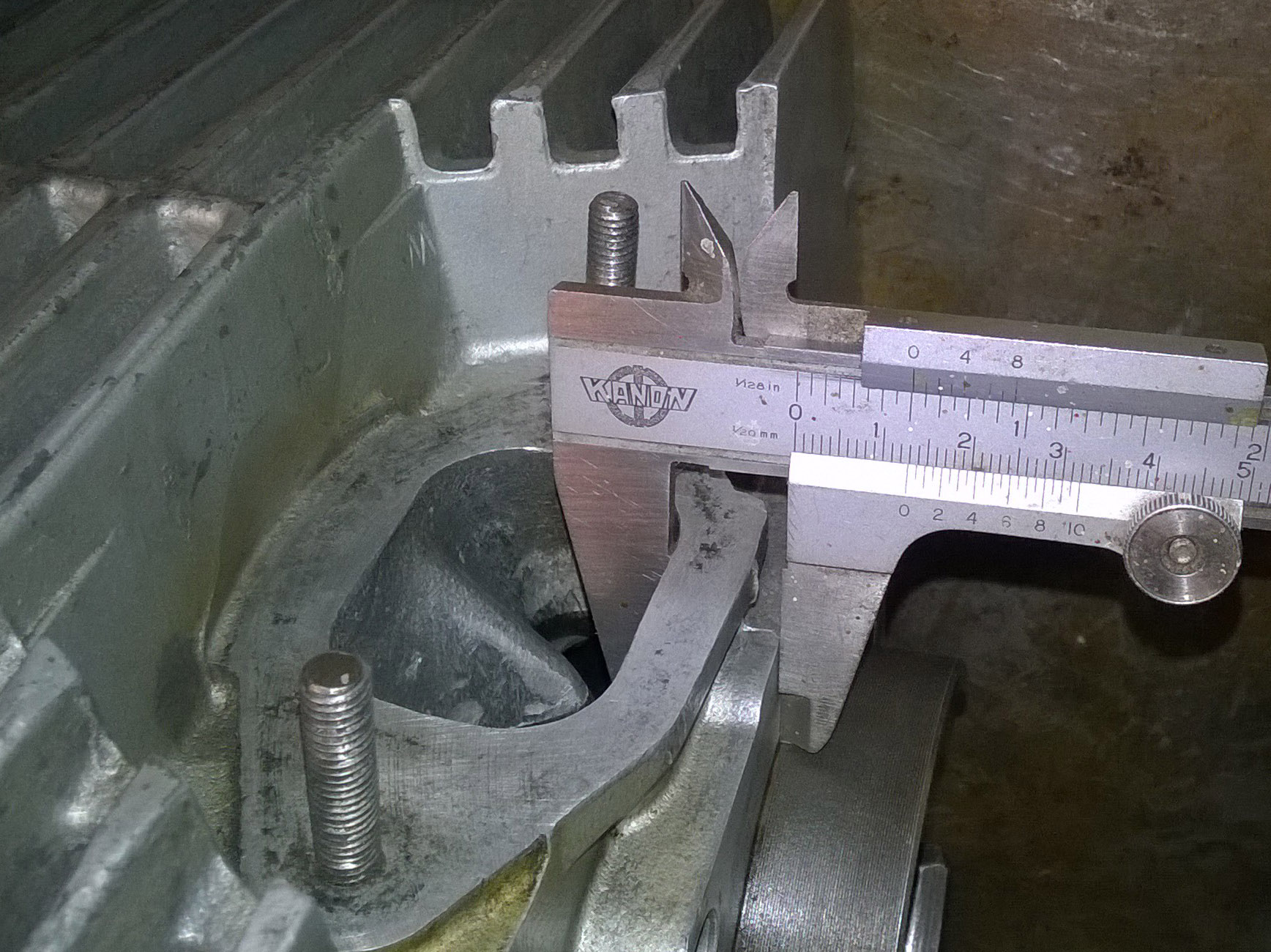

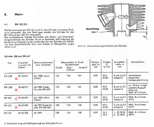

Postby Puffs » Sun May 30, 2021 4:11 am
A bore of 68mm is slightly surprising, as I think the standard bore for the 250's is 69.0mm...
Which type is it? Here's mine:
A '89 EM251 of type C.
But of course a barrel in good condition retains its value (I might be interested). Anyway, best in deciding the way forward.

Yes you are right at 69mm, the one I have acquired is actually 68.96mm so it would be ok. I can't tell you the noise I made when I removed the
head from the original engine, I could not believe it at first. Anyway, that's how it is, I will have to look for another cylinder and head, trouble is the first one
took ages and I still need the head for it. One thing I have decided though is just keep looking so, I now need one ETZ 251 cylinder and two heads, we will see
how long that takes.

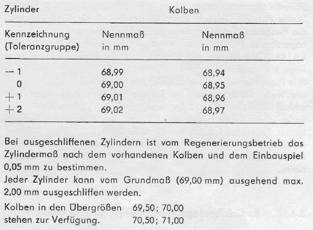

Postby Puffs » Mon May 31, 2021 2:41 am
For reference, from the 251 manual:
Zylinder = cylinder, Kolben = piston, Einbauspiel = clearance
But obviously this pertains to new barrels & pistons, from the original suppliers, which by now are virtually impossible to find. Aftermarket parts have different sizes, alloys and clearances.
