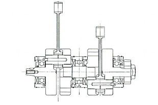

Hi Guys,
Every time I go into the garage, especially as I have finished the Saxon 301(except MOT) I keep passing the spare engine in the middle of the floor and
thinking, wouldn't it be nice if that 251 was a 502 because I have a spare bike to fit it too, and it would be a very interesting project. A Saxon Tour with a 500
twin TS, not a bad thought is it? As you know I have an engineering background so that will help somewhat, and the fact that I have put my thoughts on this
forum will ensure I give it a good go. So that's what's buzzing around up top at the moment. There is the obvious problem though, I'm sure you are all with me
I only have half of the project, one engine, I need another ETZ 251 engine. It does not have to be a runner in super nick and it doesn't have to have electrics.
Obviously, I am expecting to buy this engine. Also if there is anybody reading this that has already succeeded in doing this, then please pm me.
It is my intention, as I only have a pedestal drill, to use a small 2 man engineering Co near me to do any machining and I will do my very best to document the
process as I go. By the way, it has to be a 251 not a 250 because I want the possibility to use injected oil if I can. Anyway, Guys stay safe.

Postby Guesi » Sat Feb 20, 2021 9:05 am
This is one way to do it.....

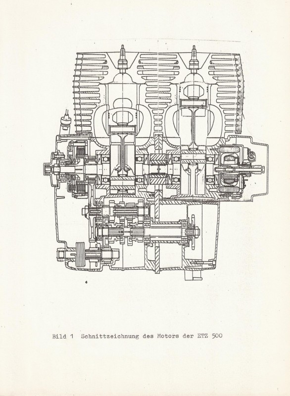

Postby AlanJ » Sat Feb 20, 2021 12:43 pm
Hi Guesi,
Thanks for this post it's more than interesting. Am I right that it is showing a 180 degree ignition and an extension for the final drive? And if so, do
you know if the 180 is prefered over the parallel ignition? Excuse me asking but where did that sectional drw come from?
stay safe Alan.
AlanJ
Posts: 321
Re: Two into One

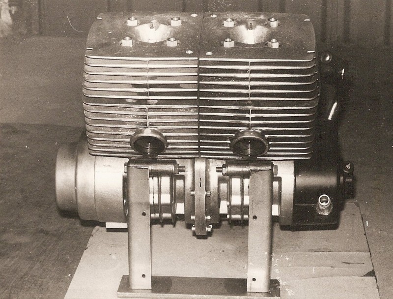

Postby Guesi » Sat Feb 20, 2021 1:41 pm
I cannot remember where I got this drawing....
Most of the guys who built such an engine used a TRABANT car crankshaft. And this crankshaft has a 180 degree .
But on this engine 2 crankshafts of an ETZ 250 were used. They made it also with 180 degrees. This might be due to vibrations.
As the 2 stroke works on every piston on top turn it is better that every 180 degree comes an ignition instead of parallel twin with 1 ignition on both cyclinders at the same time.
Here is another picture.

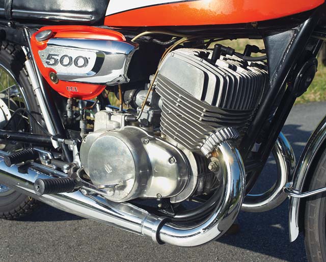

Postby breakwellmz » Sat Feb 20, 2021 3:42 pm
Remember the Suzuki GT500 engine, wasn`t that based around one of their 250 singles (DT?)

Postby DAVID THOMPSON » Sat Feb 20, 2021 5:02 pm
that Suzuki GT500 was nice
bit of a gas hog and running in traffic it was bad to control the slow speed idle surge
there are still several in use in my area in good weather they are SHED Queens now
Dave
Re: Two into One
Postby AlanJ » Sat Feb 20, 2021 5:49 pm
Hi Guesi,
Thanks for all the additional info. The reason I was especially interested in the sectional drawing and where it came from was because in my
early working time with Ford Motor Co I was a draughs person with the chassis group, often doing similar drawings to that one. The interesting thing with this drw is how did the two cranks join. Buy the way, thanks to the other guys input.
stay safe Alan.
