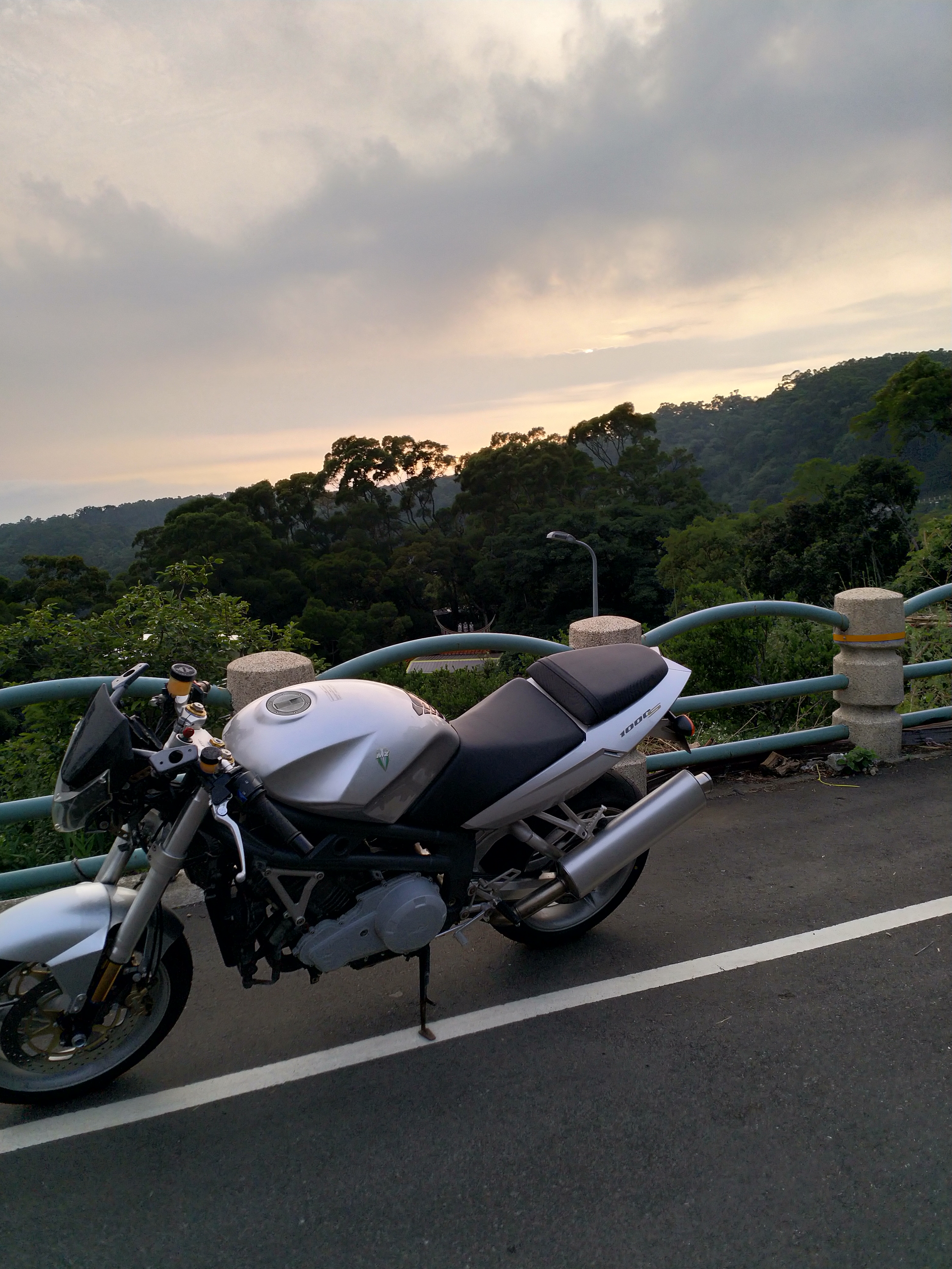

Postby leonfriend » Mon Aug 05, 2019 11:18 pm
..some guy imported it together with a 660...he crashed it and then "gave" it to me... :) Unfortunately the fairing is gone but it runs beautifully.

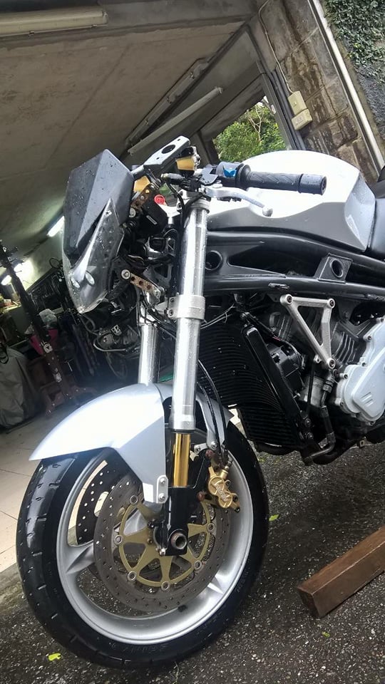

Postby Puffs » Thu Aug 08, 2019 4:09 am
Wow - lucky man.
Naked looks fine to me. Maybe a different headlight.
