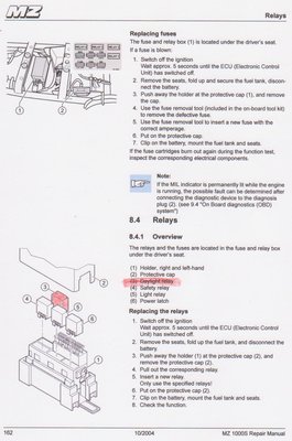

Postby MJ310 » Sun Jul 04, 2010 1:22 pm
This is all good stuff, I have an orange 07 SF (built in 05 but sat in a shop for 18 months). I am well pleased with the bike, it always gets a few glances and questions when I am out on it. It only has 10,000 miles as I have other bikes. Reading the other entries I will check all my engine bolts and my hugger but have not noticed any of those problems myself.
I have had the following problems:
1. Starter safety relay failed after 1 week, replaced under warranty.
2. Mirrors flaked off at edges, replaced under warranty but no fitted as its not getting any worse.
3. Rubber tab on side lights split off when changing a bulb, not replaced.
4. MZ badge on rear hump fell off, replaced under warranty.
5. RH coil failed 20 miles from home so I have probably lost my cats as well.
6. Battery replaced with Yuasa as the original was getting a bit tired, (probably due to sitting in a shop for 18 months).
7. Have added a 3/4" wooden spacer to the side stand as the bike leans over a bit too far in my opinion.

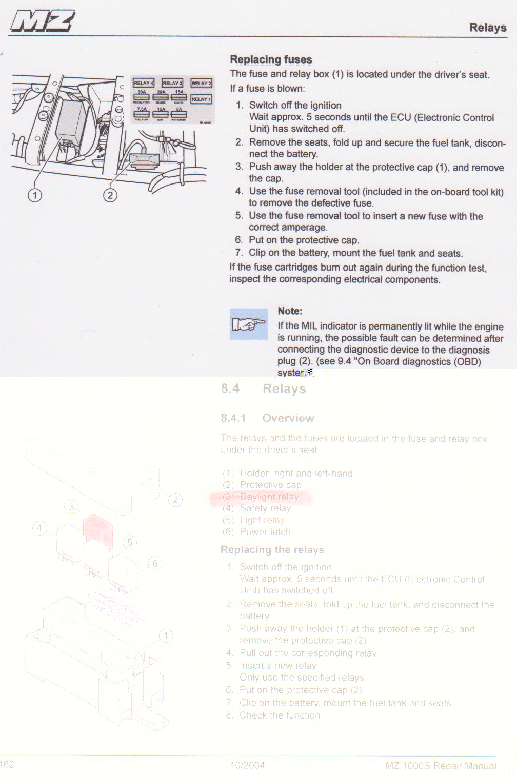

8. I am currently re-routing the wiring to stop the headlight from comming on and allow me to use the light switch and decide if I want lights or not.
So apart from changing oil and tyres it has been pretty good. I am starting to build up a small list of replacement parts which are available from other manufactrers so would be interested if anyone else has already started?
Having only seen 1 other sf and 1 s on the road these must be one of the rarest bikes in the UK, unless you live in the Bristol area and would like to show me yours?
Mick
MJ310
Posts: 143
Re: Living With An MZ 1000S/SF/ST: Reliability/Faults
Postby LWS66 » Sun Jul 04, 2010 4:27 pm
Mick
You can remove the daylight relay instead of messing with wiring (the relay makes the headlights come on when switching on the ignition, overiding the switch) Removing the relay enables the switch to operate like it was intended to: Lights off, pilots on, all lights on. Then you put the relay in the tool pouch for backup along with the extra fuses. Simple as that!
LWS66
