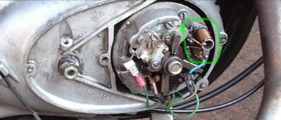

Postby Gerryman Ts125 » Wed Apr 05, 2023 3:22 pm
Have you inspected this part (below in green) as it has a say so in starting, charging, misfiring. But like a duff condenser the contract breakers (and this part) will be burnt, charred or melted. Your coil should've been hot enough to fry a egg or flesh.
A multimeter is a necessary extra when dealing with any electrical fault..
