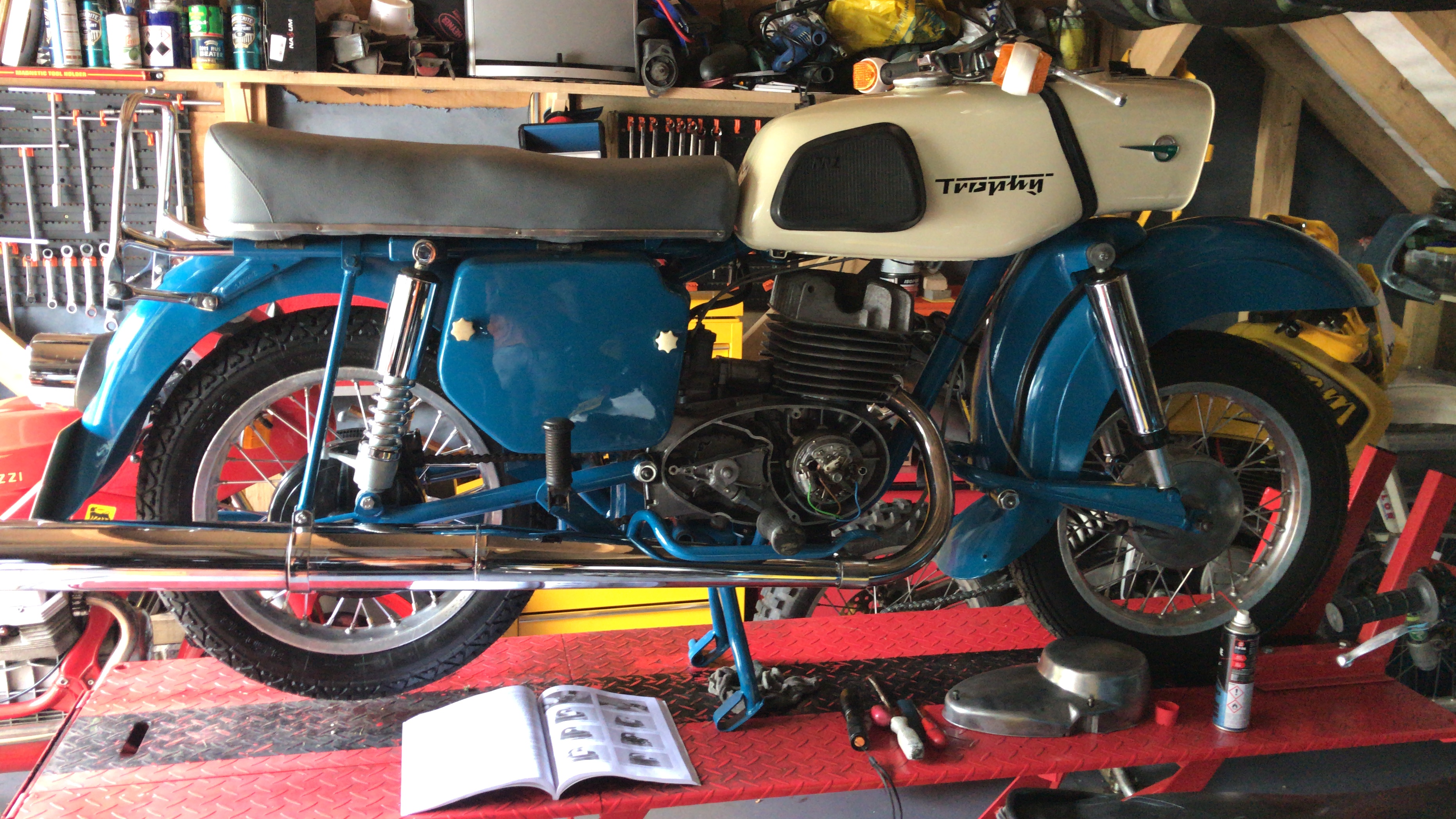

Here is a photo of the bike. I will post some more of the reassembly and hopefully the sweetly running finished article!
Cheers, Ray
