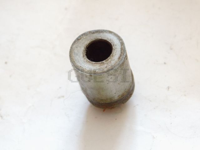

I'd polish a cam like that using an oil stone.
And finish with some 1200 --> 1600 grit sandpaper, also wetted with oil.
But if you tried another cam (known to work well) in the past, it's probably not the cam.

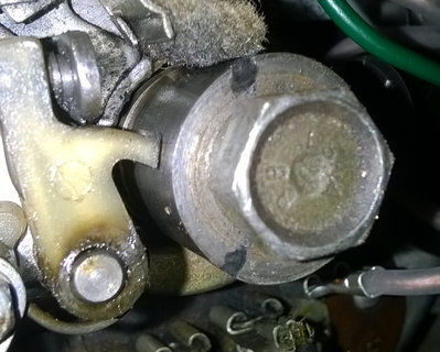

As the timing & duration of the points lifting appears at the heart of the matter, I made a little film of it, see attached zip. I wired the witness bulb such that when it burns, the points have lifted, and v/v. I regret not having taken a LED bulb, as for the film, the filament takes a bit long to heat up & cool down.
I had also marked the location where the points open & close, but that's pretty much invisible on the film, hence this picture:
Points lift for about 240°.jpg (40.54 KiB) Viewed 17925 times
The black dots indicate the position of the cam follower on the cam at the moment where the points either start to lift, or close. See the points are lifted for about 240°, and closed for some 120°. On the pic they are closed.
Edit: so in this engine there is 240° between those trigger points (= where the spark occurs), when comparing normal & backwards running. When going backwards, I get a spark some 40° bBDC = 9mm bBDC, which will never cause combustion. (See later improved estimate.)
The film covers just 1 cycle, but if you play it in continuous repeat you can see that the bolt seems to wiggle. Specifically: towards the side of the end of the lifting period. I don't think the bolt is bent or anything, and AFAIK original. This offset may be in the crank, or in the rotor. As said, this has never given me any hassles.
The lot is set so that the points lift to a max of 0.32mm, and start to lift 2.75mm bTDC, as set with a clock in the plug hole. Previously I had it higher & earlier, and then it revved more easier, but like this (pretty much standard) it's slightly stronger in the lows. It runs fine & never backwards.

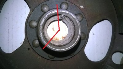

To get a clear indication of the lifting period, I used the lamp to assess where the points start to lift, put a dot on the cam there (felt pen), and where the points close (next dot). Now, rather than eyeballed, I 'measured' the angle, and it looks like 107° between the dots is a better estimate. Hence open for 253°. (There is a minor parallax error in this new estimate.)
Points closed for about 107°.jpg (27.85 KiB) Viewed 17923 times
So, in my case, going forward, the points open at 2.75mm = 21.3° bTDC, so they close at 51.7° = 14.8mm aBDC. So going backward, I get a spark at 51.7° = 14.8mm bBDC, which can still never cause combustion.
If your points lift for 90°, and you set them to lift (in normal rotation) at some 21.5° = 2.8mm bTDC, that would mean in backwards rotation they would lift at 90°-21.5° = 68.5°= 24.1mm bTDC. I don't think that will run; the exhaust port has only just closed (for some 12.5mm) so there'll be insufficient pressure. So with this 90° opening period of the contact breakers, we again need another explanation for why it can run backwards: then the spark you get when the points lift comes too early. So we're back to the bouncing...? Or does the point where these breakers lift depend on the direction of the cam's rotation?
One thing I notice is that your points seem to look quite different from mine: while mine have a clear & narrow cam follower, shaped like a circle around the rotation point. I cannot see that on yours. Could that have any consequence?
And also, you say the cam bears witness marks indicating that a good 3/4 of the cam's rotational surface has been in contact with the cam follower. If the cam follower rests on the cam, the points are lifted, right? So that means the points were lifting for some 270° (=360° x 3/4), which is reasonably close to my 253°, yet quite different from the 90° you said it does now, in your film. So once again: could a higher lift height solve your problem?

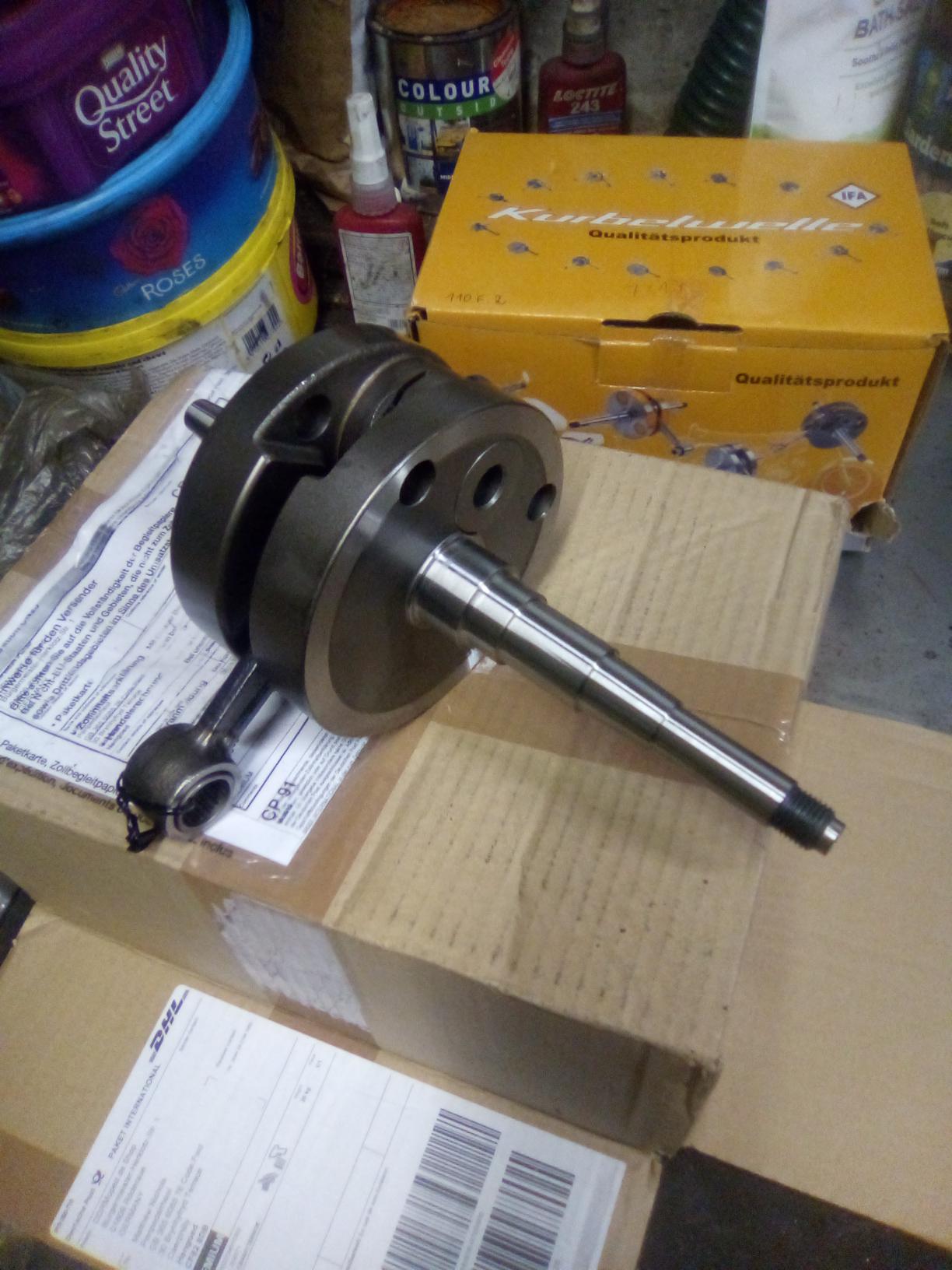

Postby Blurredman » Thu Sep 29, 2022 2:13 am
So I bought and have had delivered a new crankshaft. It looks good.
Came from Germany directly, so I wonder if I should stop by a machinist to double check the balancing is right. You never know how these packages have been treated in transit.
1987 MZ ETZ300 - 40,000 miles
Posts: 1264
Re: Crankshaft worn
Postby Puffs » Thu Sep 29, 2022 3:56 am
That looks very nice & shiny!
They're not made of cheese, so if it was packaged properly and without damage to the packaging, you'll have to assume it'll be fine.
At any rate, if you cannot measure it properly yourself, or have a workshop nearby, assessing imbalance will be difficult. You can send it to a workshop, and they can measure it (and, if required, re-balance), and after you pay them, they send it back. And in that transit it can be damaged again. So still no certainty...
