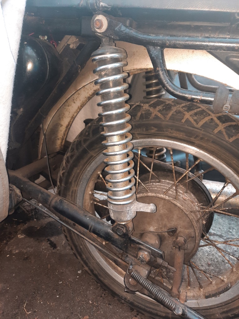

Postby Daniel_I » Mon Mar 20, 2023 3:04 am
rotated pic dave
Rear shock length of current spring (unloaded - on centre stand) is 250mm.
Maybe replacing the existing spring with one of the same length but with a thinner wire diameter. This would result in lowering the suspension when under load.

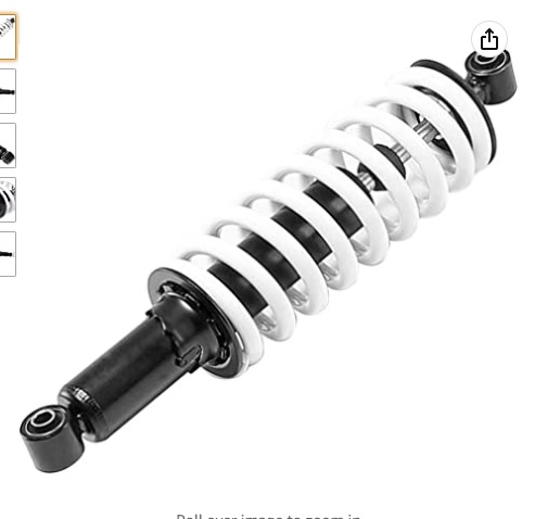

Postby Daniel_I » Tue Mar 21, 2023 9:27 pm
Thanks for all your help, Puffs.
Would it be possible just to replace the rear suspension with something like the one shown in the image? It's just a generic 3rd party suspension unit which measures 300mm. They seem to be available in just about any size (310mm, 320mm, 330mm etc) and I'd pick the one that ensures a reasonable bump gap remains. And they are damping coefficient and stiffness adjustable. Might this be a solution?
Your help is really much appreciated (as is Jay Bee's input also).
