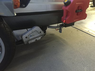

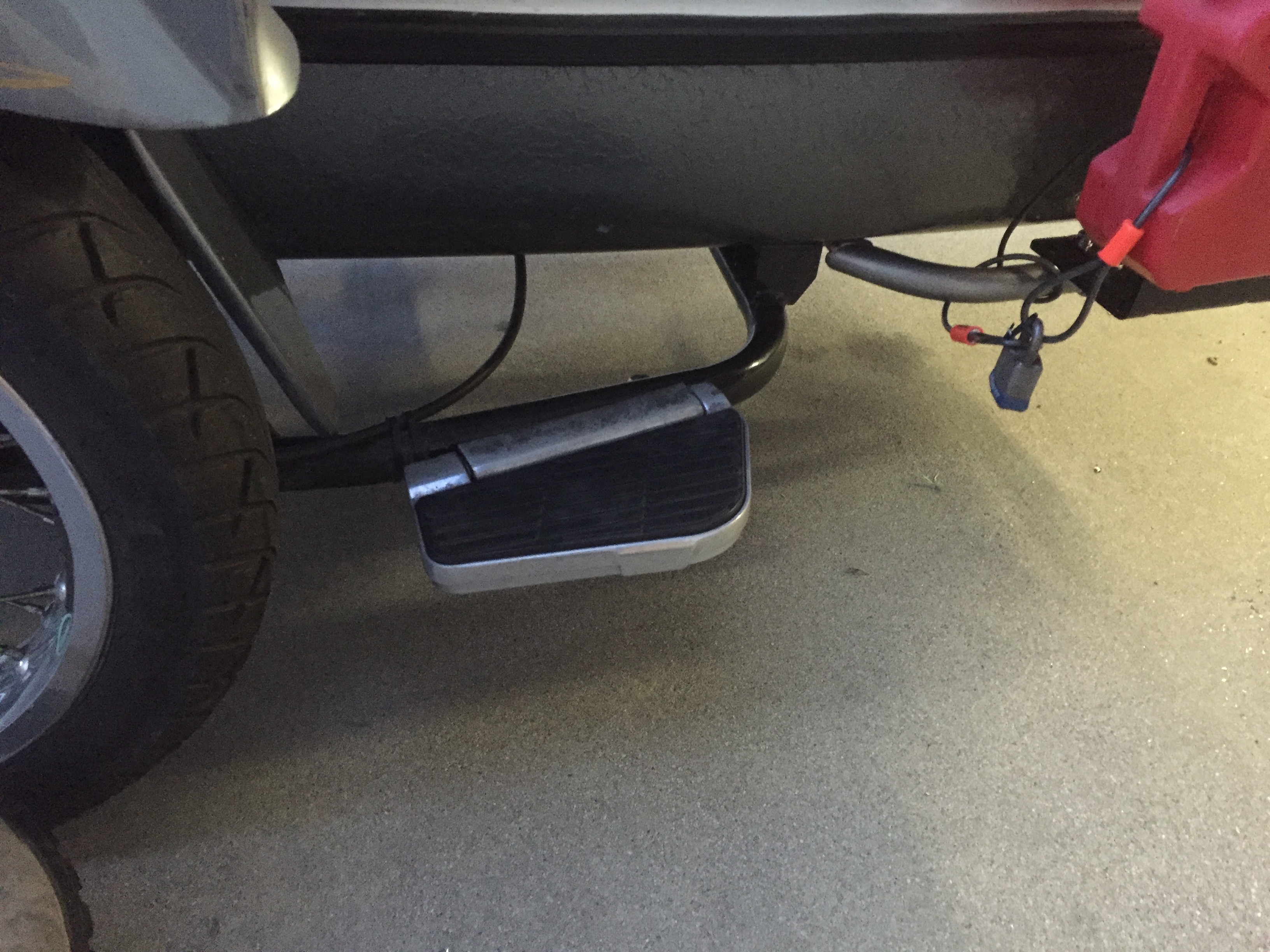

Postby Bertram » Sat Apr 16, 2016 1:06 pm
Listers: It has been awhile since I opened this topic. I have found a solution to my question, after surfing and lurking the web. I came upon an ad in E-Bay where this gentleman was selling his BMW with a Velorex rig. He had a step mounted on his, I asked him who made the step. It turns out to be a right passenger floorboard from a Honda Goldwing. These can be had quite cheaply via E-Bay. I have mounted the floorboard directly to the frame of the rig. My reasoning is I don't feel the frame is compromised by drilling two holes in it. Also there would be no more than 150 pounds put upon it momentarily, when used. I found the floorboard bracket had 9mm holes. I chose to enlarge them and go with 3/8 diameter. I used 3/8 x 2 1/2 grade 8 bolts and hardware. I modified the washers to fit the bracket where the bolt heads rest against. Hope this can help anyone else who wants to do this modification.
Cheers Bertram
Step deployed
Step folded
Bertram
