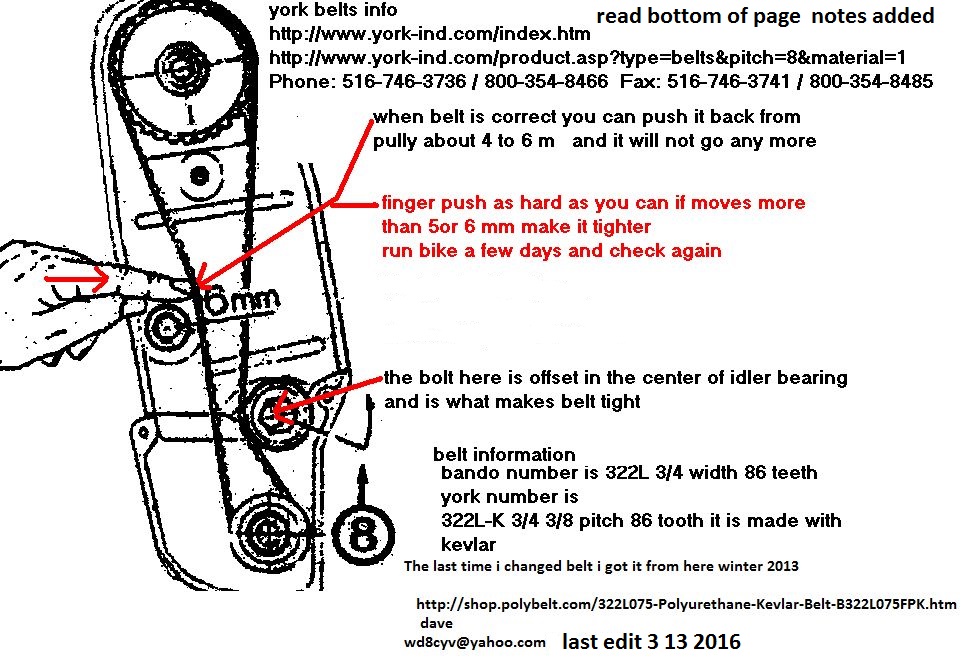

Postby DAVID THOMPSON » Sun Mar 13, 2016 9:25 am
https://shop.polybelt.com/322L075-Polyu ... egoryId=-1
DAVE
this is for belt
i am looking for the info on the belt pulleys timing marks
click on picture to view full size
AND DO DOWN LOAD AND SAVE
belt info
here it is as a jpg file
about the pulleys

Postby DAVID THOMPSON » Tue Jul 03, 2018 7:18 pm
i installed one but have never fired up the beast it seems to fit when tested but never started
the drawing above with red text shows where it came from cluck on picture to make it big enough to read
