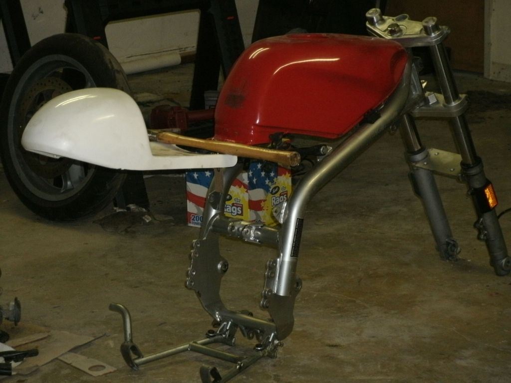

First mock up of the Suzuki tank and my craigslist seat fairing. The seat will be getting extensive reshaping and some type of internal structure to help it become a solid part of my sub frame. It will also contain most if not all of my electronics. The tank just needs to be plumbed and mounted.
Things are coming together fast now so I should be able to run the bike within a month or so and then get some riding in before the final tear down, paint and powder coat. Wheels are last on my list for now.

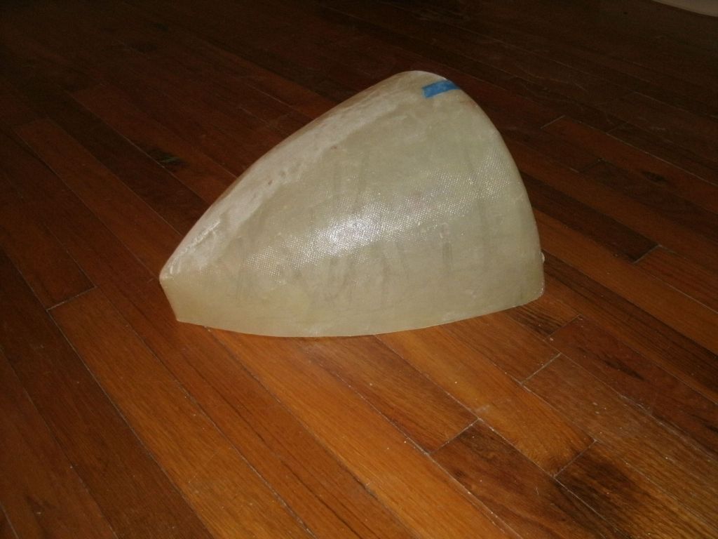

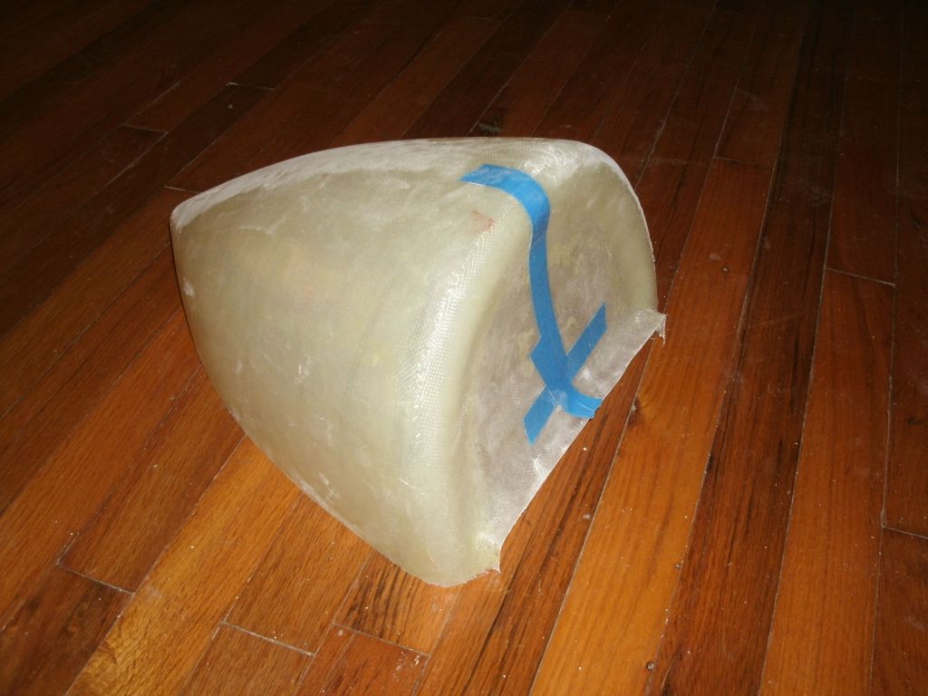

On a happier note, the resin for the shell of my seat cowl is curing as I'm typing this. I should know by morning if I've got a useable part or not. :)
Postby edfmaniac » Tue Jul 09, 2013 9:26 am
Success on the seat cowl. This is just the shell. I still need to fabricate the structure that will serve as a base for it to mount onto.

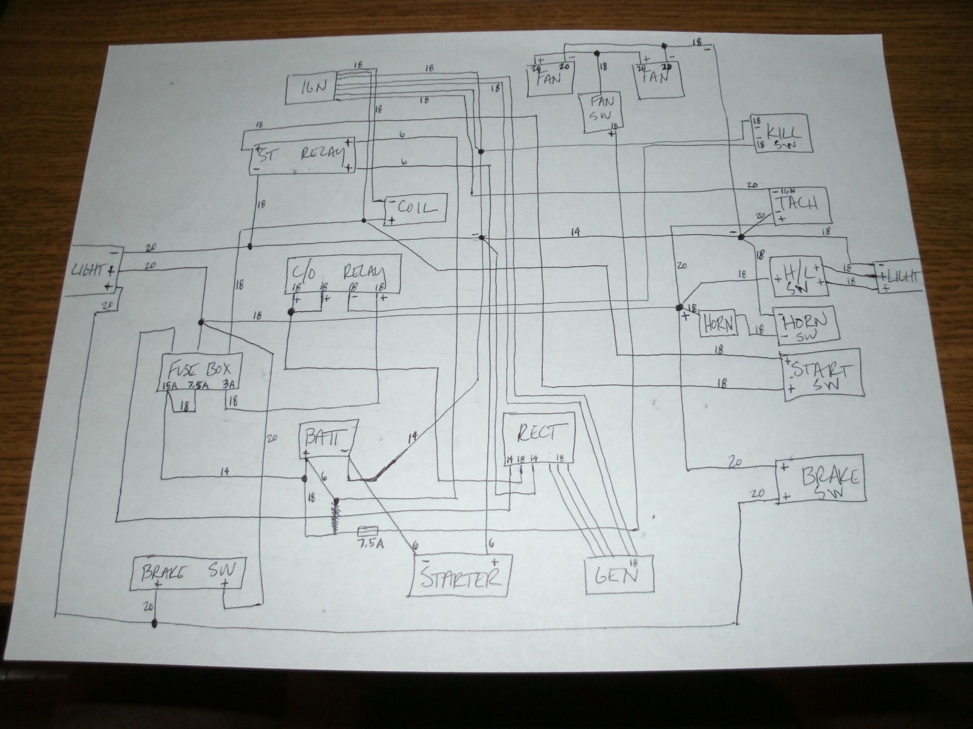

My amateur attempt at a wiring diagram. I used some ideas from one of Bill's posts and some from the original harness.
Postby DAVID THOMPSON » Thu Jul 11, 2013 9:48 am
go to a car breakers bone yard and
raid a german made car for a big piece of wiring harness so you have color coded wire to match
the mz colors in the original harness
makes it easier to troubleshoot later
Postby Bill Jurgenson » Sun Jul 14, 2013 4:15 am
in making a one-off harness, there are several don't in this one for me and it is too complicated.
A cardinal mistake: the battery connection: you should run both pus and minus from the rectifier directly to the battery, better yet to special posts centrally located. Connect the harness, the battery, and the coil directly to these.
Likewise, you definitely should use two relays to switch the headlight hi and low beams, runing the +12 from that post directly to those relays with a 2mm2 9at least) wire; then use the handle bar switch only for the coils to the relays. Instead of a candle, you will get a real headlight.
You really should streamline to plan as much as possible.
In particular, If you must have the ignition key on the triple tree, then use it only to switch a heavy-duty 12v relay to switch the +12v to the bike. Better yet is to put the key switch as close to the battery/connector posts as possible and do away with that relay entirely. It is nonsense to run the 12V all the eay to the front and back again for the sole purpose of easy switching. You can leave the steering lock at the front for legal purposes if that is necessary.
Just an example, a Skorpion (not mine), the post connector is in the center. The LiPeFo accu can be lifted out without disturbing the harness or anything lest; the starter relay in directly next to it.
I put the ignition key switch on the right directly under the seat frame and fastened with the seatframe bolt:
In its present state, the LiPeFo accu is under seat on the tray right next to the posts, just like in the picture above, the ignition box and the SilentHektik electronic fuse box are also right next the posts and battery. It is not cheap, but I definitely would use that SilentHektik fuse box for a street use bike.
http://www.silent-hektik.com/Zub_Sicher.htm
the second one listed, S4403 which includes an internal 400W relay.
The box contains 3 8A fuses, that relay and the blinker relay which is is completely independent: 1,2 4 or no bulbs at all, it blinks. It a fuse "blows", turn off the ignition, wait 10 seconds and turn it back on; the fuse is reset. I have been using this for 10 years now and with absolutely no problems.
I turn the plus 12 main to this box on and off with the key. I use the internal relay for the ignition itself, controlling it with the kill switch. Both the ignition box and the coil get ±12 directly from this relay.
If you choose to run the headlight thru the relays mounted up front next to it, It is best to use an inline fuse in the heavy wire running directly from the +12v post.
Here is a sample harness from SilentHektik:
http://www.silent-hektik.com/MINI_K_03.pdf
