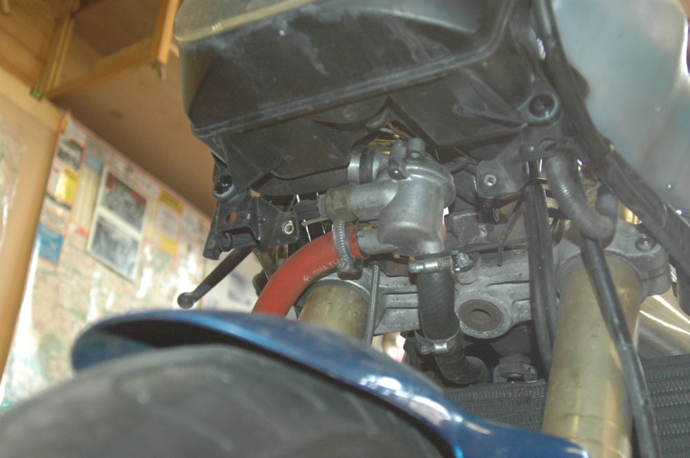

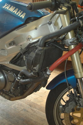

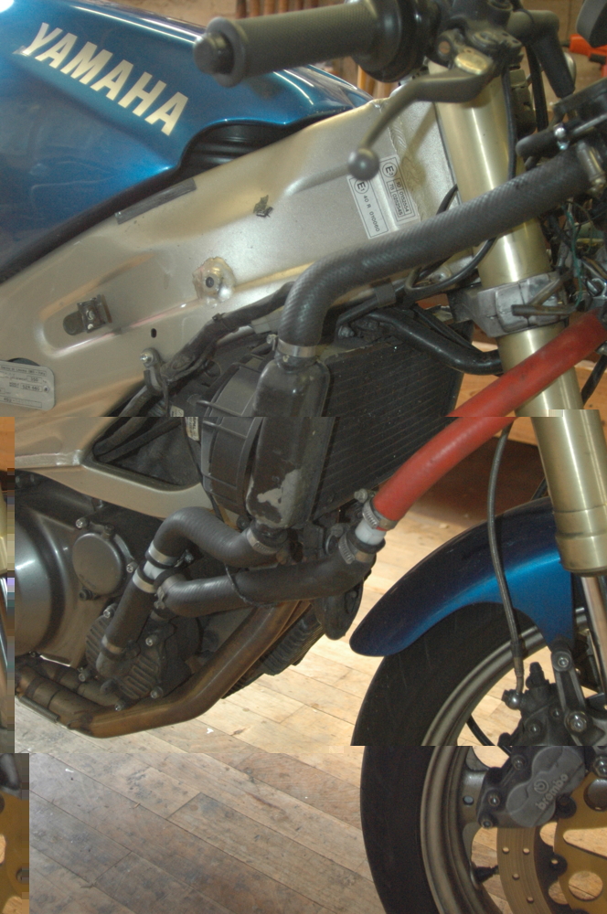

Postby Bill Jurgenson » Sun Jul 21, 2013 1:48 am
Two pictures from the Yamaha but the Skorpion is basically the same. The T-junction bypasses the radiator. As long as the thermostat remains closed, the coolant does not run thru the radiator. In the top shot, you can see the hose coming from the cylinder head and connecting to the thermostat housing as well ans the additional hose running back to the T-junction and so directly to the engine. Only when the thermostat opens does the collant run out thru the top of the housing to the radiator.
Additional bonus: the thermal switches are in the thermostat housing and so reflect the actual coolant temperature, unlike those on the MZ which of necessity can only meter the radiator itself which is of course cooler.
