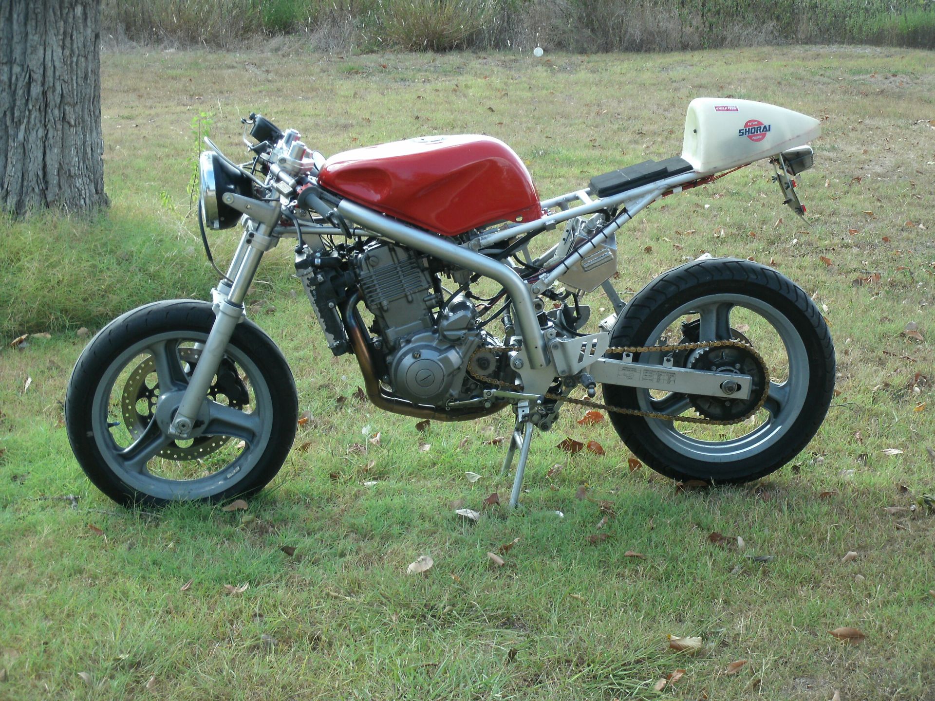

Postby edfmaniac » Thu Sep 05, 2013 4:53 pm
Here she is. You'll have to imagine her in your favorite colors and with your favorite wheels and brakes. When I'm ready for another round of work, I'll be going with the white tank & seat cowl, black frame & swing arm and black billet wheels or possibly chrome spokes with black rims & raw hubs.

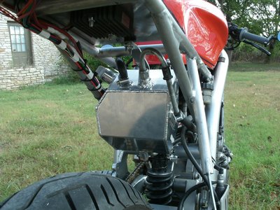

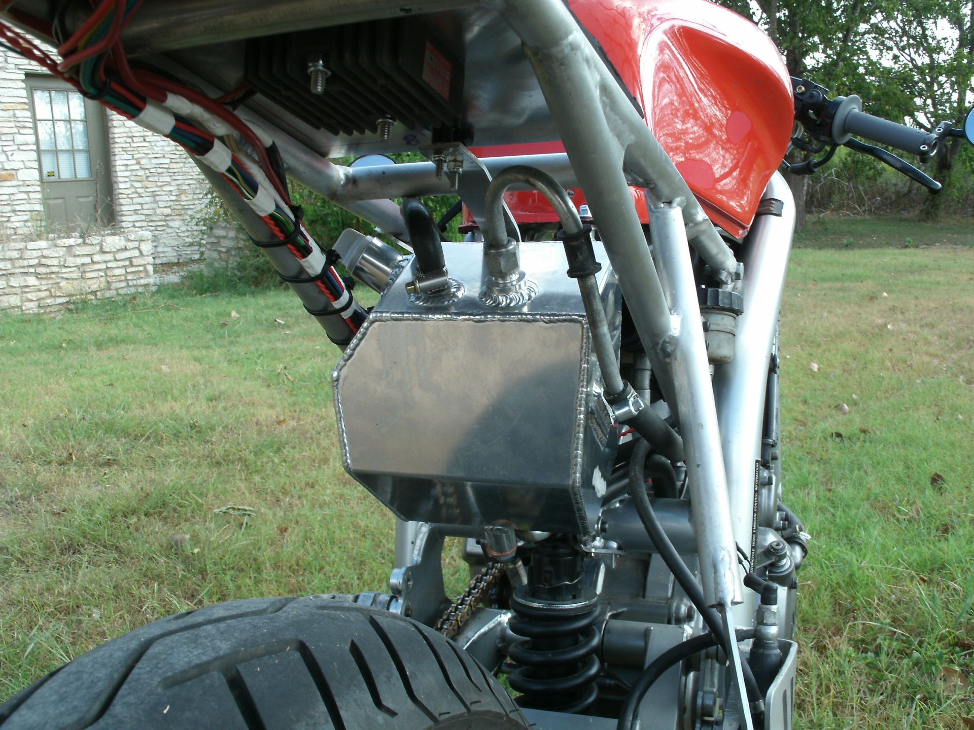

droy wrote:Thanks for that. A few shots of the oil tank fitted would be great when you get a chance.
Great build - thanks for sharing.
Doug in NJ
Here's the tank in it's final position and trim. I cut off the stock ears meant for the Raptor mounts and used the plate on the back side, meant to be a heat shield, as part of the custom mount. A simple piece of 1" wide by 1/8" bar stock connects the back plate on the tank to the underside of the seat. The plumbing is a mixture of Raptor lines and Skorpion lines.

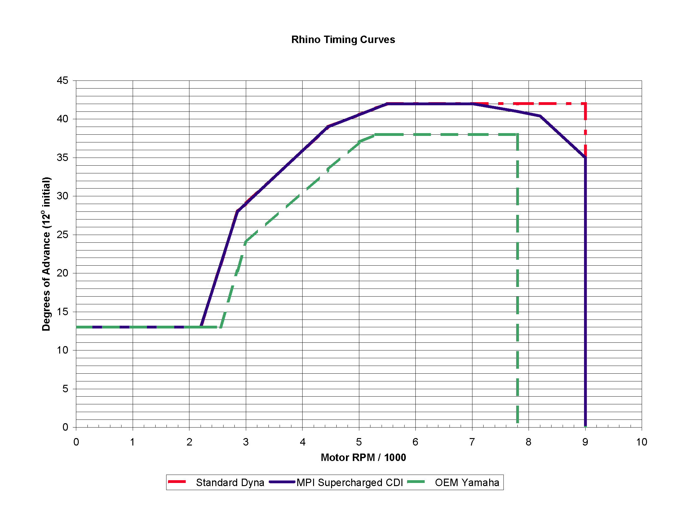

Postby edfmaniac » Thu Sep 05, 2013 11:15 pm
Yep! Got it running but am still trying to get the Ignitech to perform as good as the stock box. I'm going to start over again with Bill's recommended curve and then just slowly increase the advance until I feel like it's performing as well as the stock box but with a cut off around 9k. What I don't understand is how much advance Dynatek uses on their Rhino 660 ignition. Check this out! I thought running that much advance would make your engine grenade. :shock:
