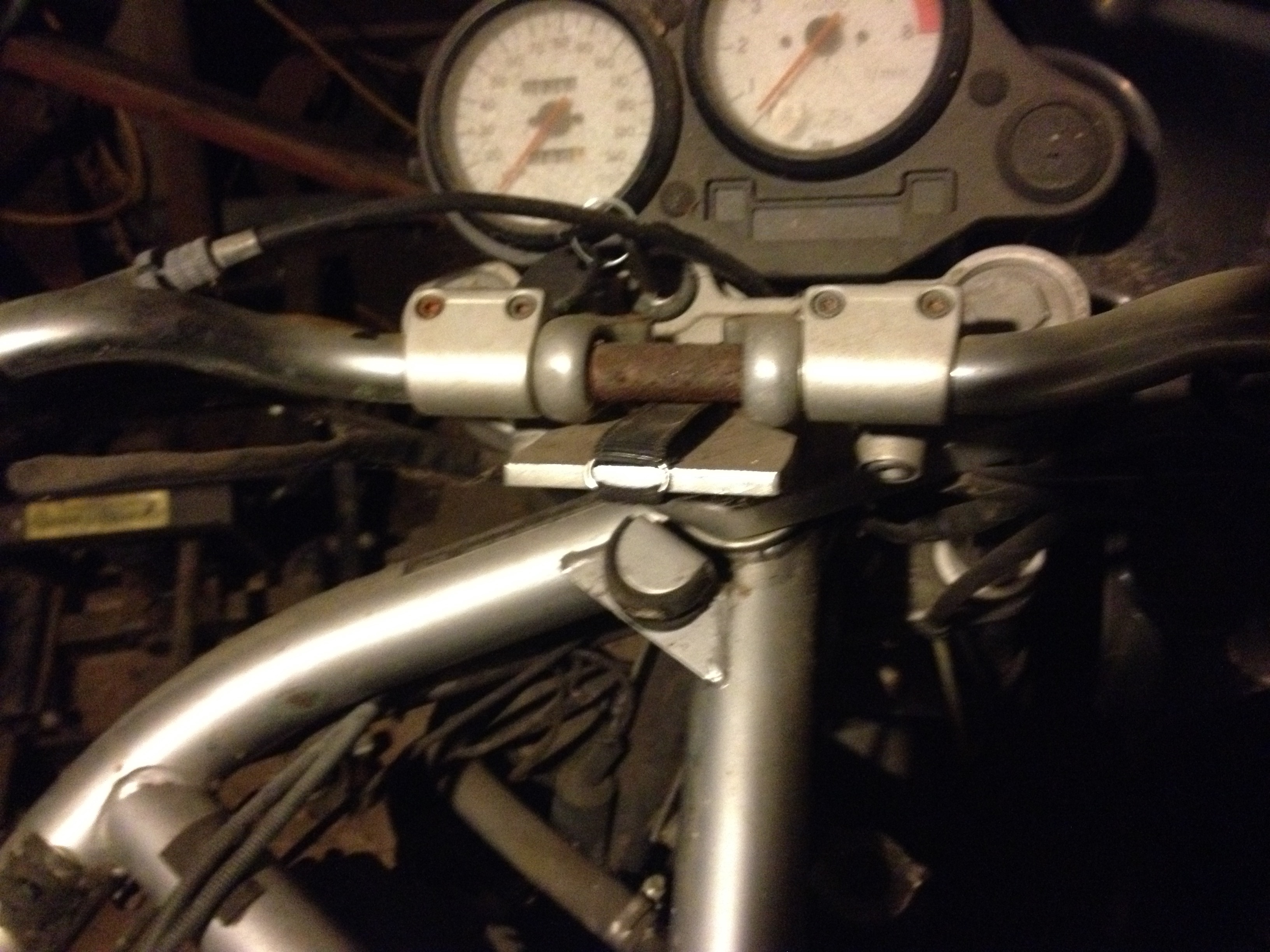

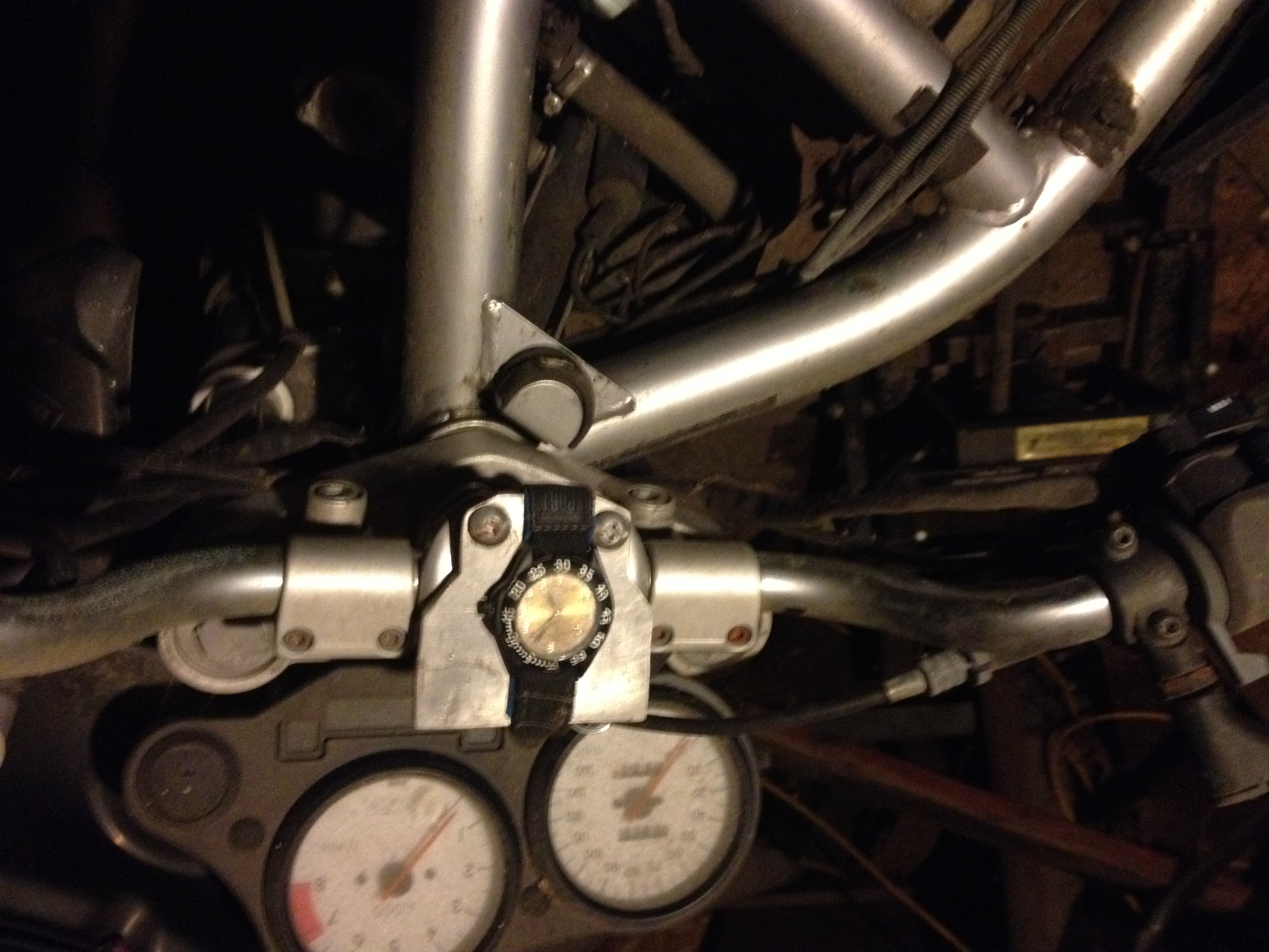

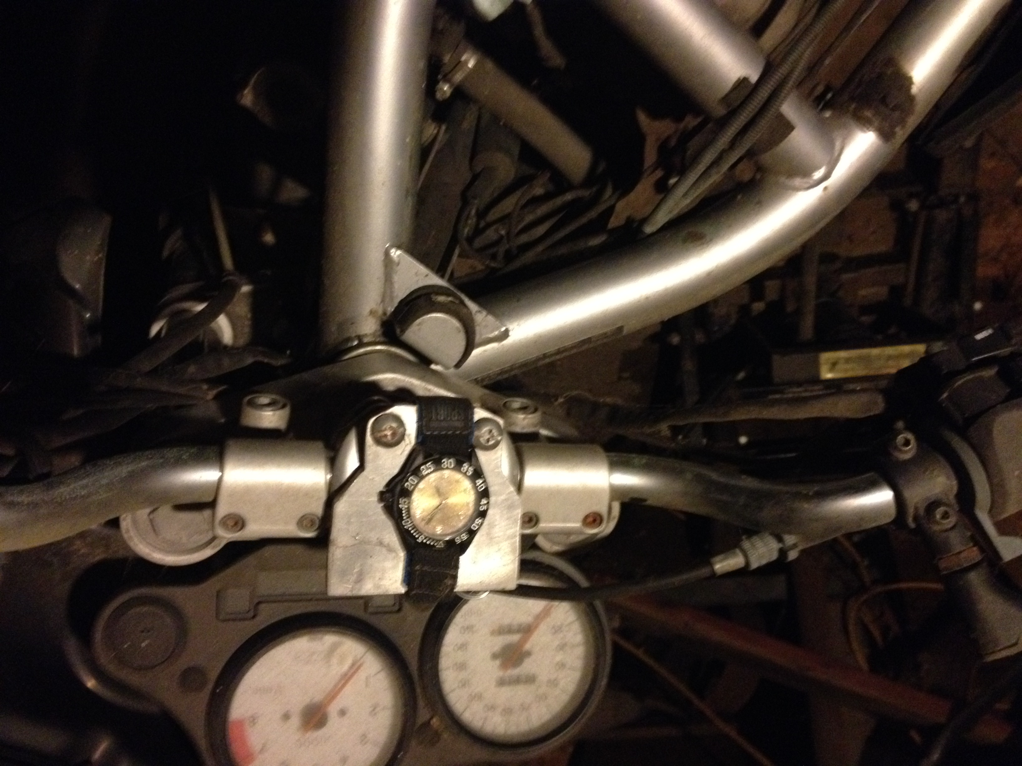

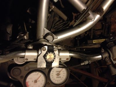

mine were stock from factory and mounted at top of steams
had a lot of fun getting them twisted around to get a rise
and used the old bars from my Saxon Tour
had to cut them in the middle
picture later today as its hard to explain
Dave
Posts: 5156
Re: Tour handlebar mounts
Postby oldbiker1 » Sun Jan 17, 2021 4:07 pm
Dave, you legend!! who would have thought to cut a 1 piece handlebar to sort out the rise problem...
I was trying to sort the exact issue a few months ago
oldbiker1
Posts: 29
Joined: Tue Nov 17, 2009 4:42 am
Postby DAVID THOMPSON » Sun Jan 17, 2021 7:54 pm
make a solid rod to insert in the bars in the middle or the flex will SCARE you
and i made a cover to hide the cut // cover is map or watch holder
clamps to hold the clock mounting plate and hide the rusty gas pipe brace
are from the clamps for a brace in a trail bike H/B
it was a zoo to get it all apart and back tizzola is a slip fit thing and hard to get apart once it been clamped down
put a glove on your HAND and use a piece of pine 2x4 to beat them apart at right angle ((shop rag the other end in a vice))
to the way there locked together do not use heat
click on pic to make bigger
