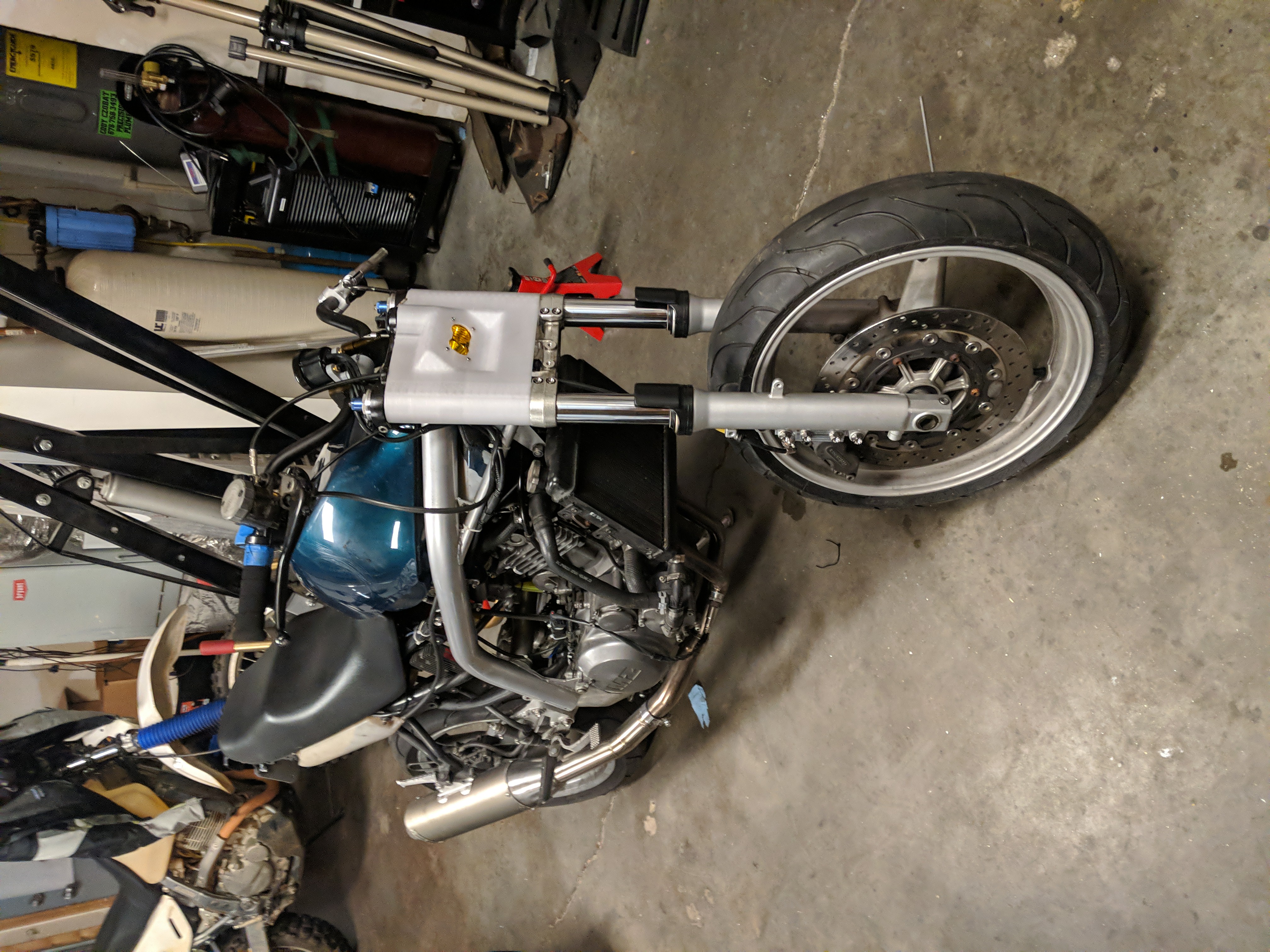

I assume it is oversrpung as well, but I am going to ride it before ordering new springs. I was also thinking about the rake angle of the two bikes, the R6 is much closer to vertical, so perhaps the addition of rake angle will make the fork springs closer to right (given that a smaller proportion of the spring is acting against gravity? I am no suspension expert, but I am going to ride it some before shooting wildly into the dark at a spring rate guess.

Your head angle hasn`t changed on the MZ unless the forks are a lot shorter making it steeper. Will the MZ springs fit, can you compare the spring rates?

Right, the head angle hasn't changed for the MZ, but the head angle is certainly more than the R6 is, which is what the springs in the r6 forks are sprung from.

Just got back from the first ride! the front suspension feels good. Much more compliment and great handling. Still getting the fueling dialed in, but the wideband O2 sensor helps a ton. its very strange that it seems to be wanting a much larger pilot jet than I thought it would and a smaller main jet.
I am at a 45 (4 turns out on the mixture screw!) and a 150 main now. I am going to try a 145 tomorrow.
My thought is that with the larger more open manifold the air is moving slower into the piston and therefor making a smaller venturi effect over the jet, pulling less fuel up at idle. I am going to do some more research and see if I can't get it dialed in more.

The forks are a big upgrade, feels very planted, but also quite comfy over bumps. It seems the stock springs are going to work well.

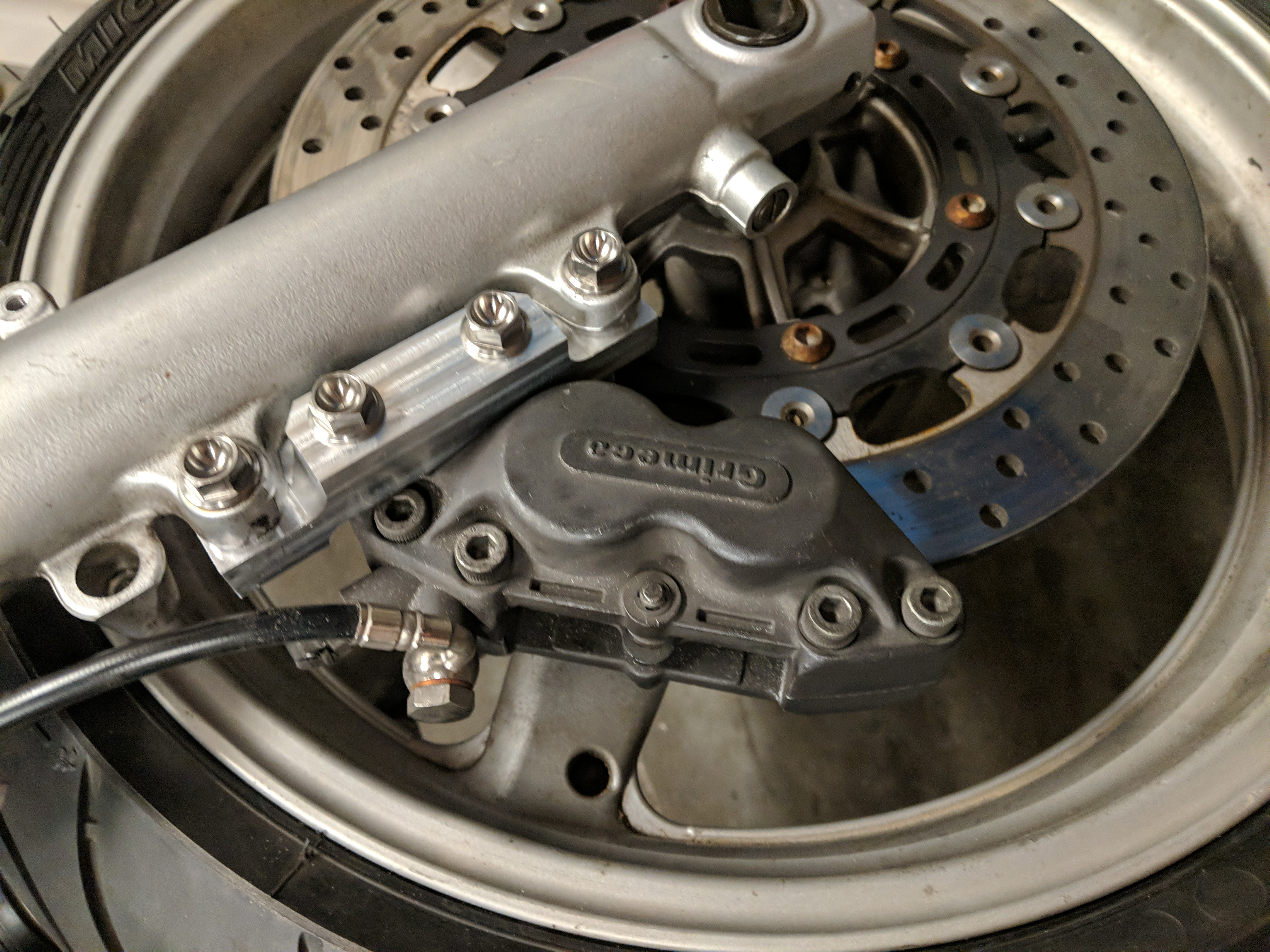

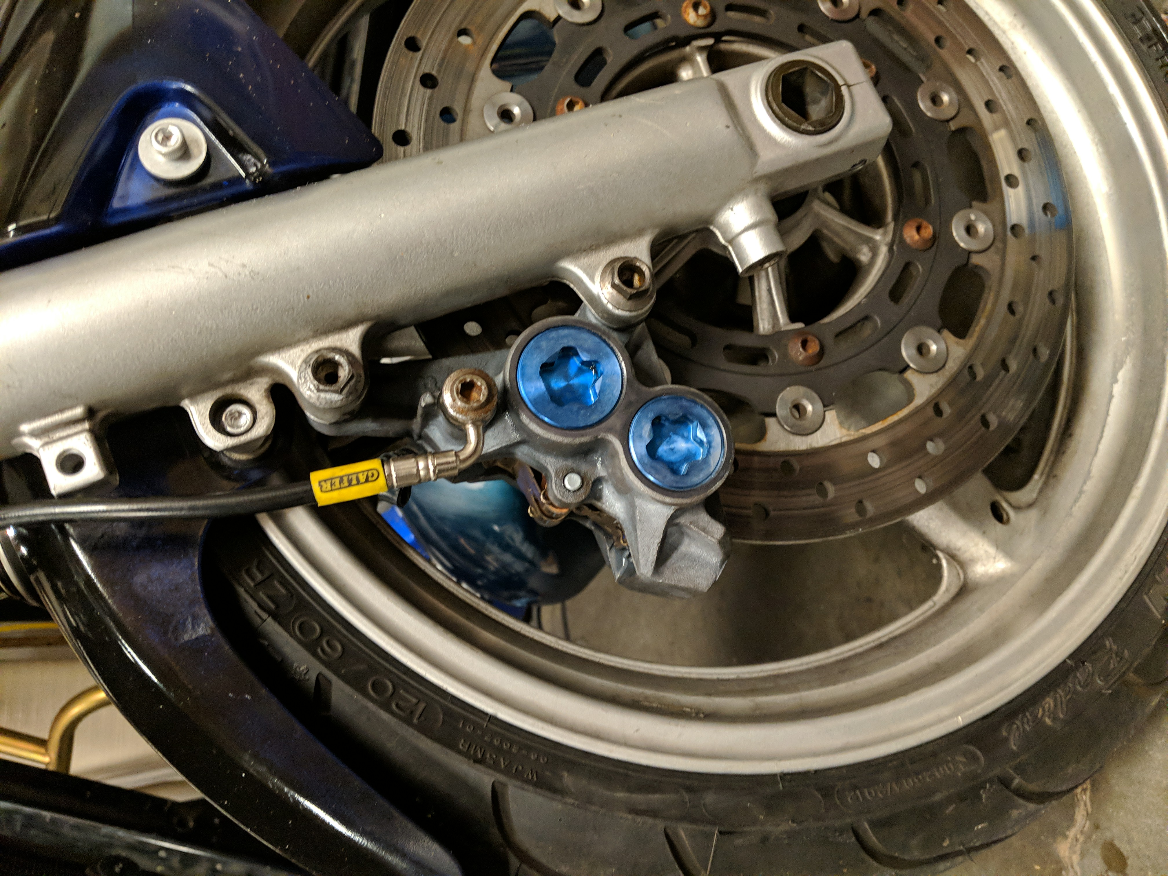

The brake seals were supposed to come in on tuesday of next week and I wanted to ride, so I made an adaptor bracket for the stock caliper yesterday morning. Works great, but of course the seals were delivered three days early yesterday!

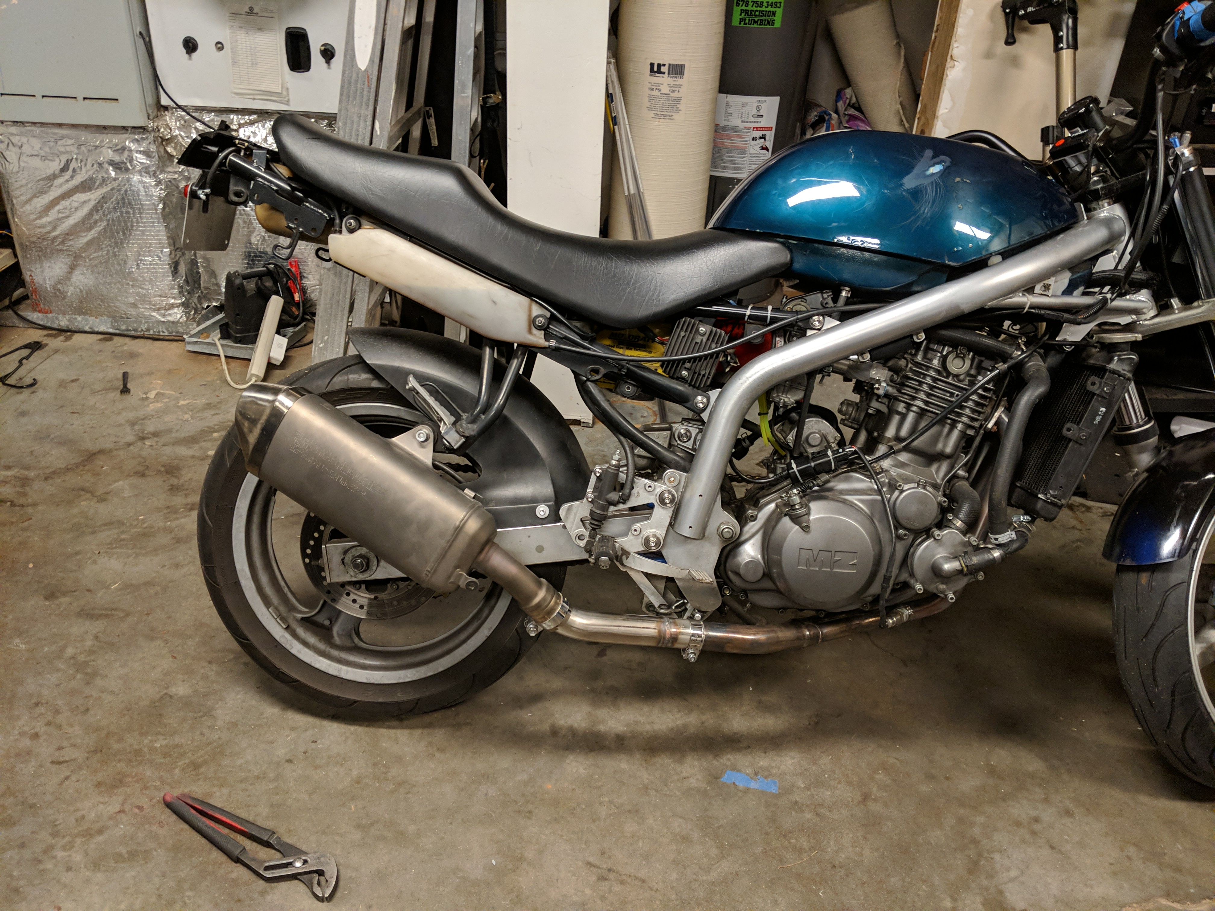

PS: it does have fenders on it now! just took the picture before putting them on.

Got the R6 caliper on. For sure lighter, but not by a ton.

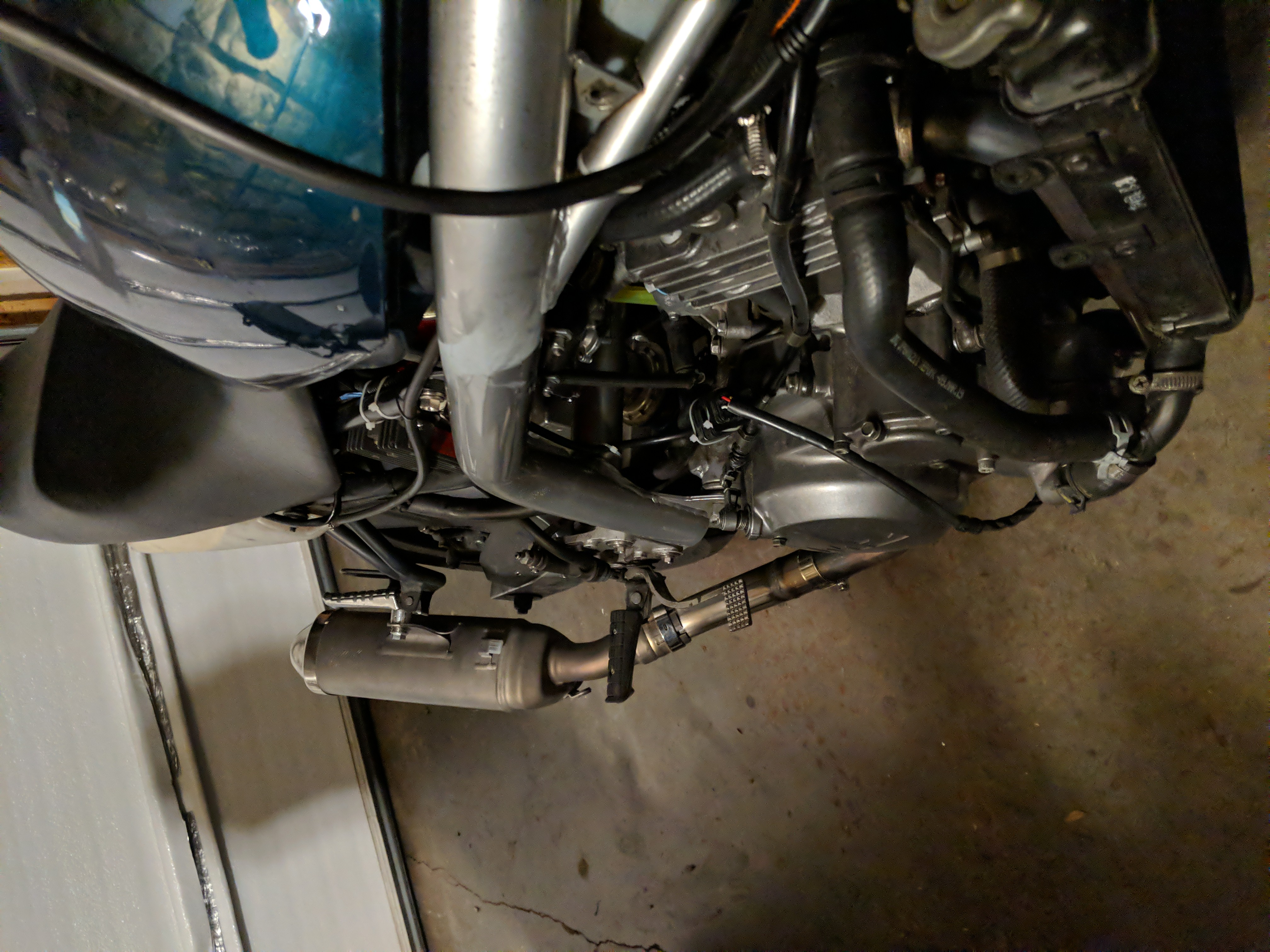

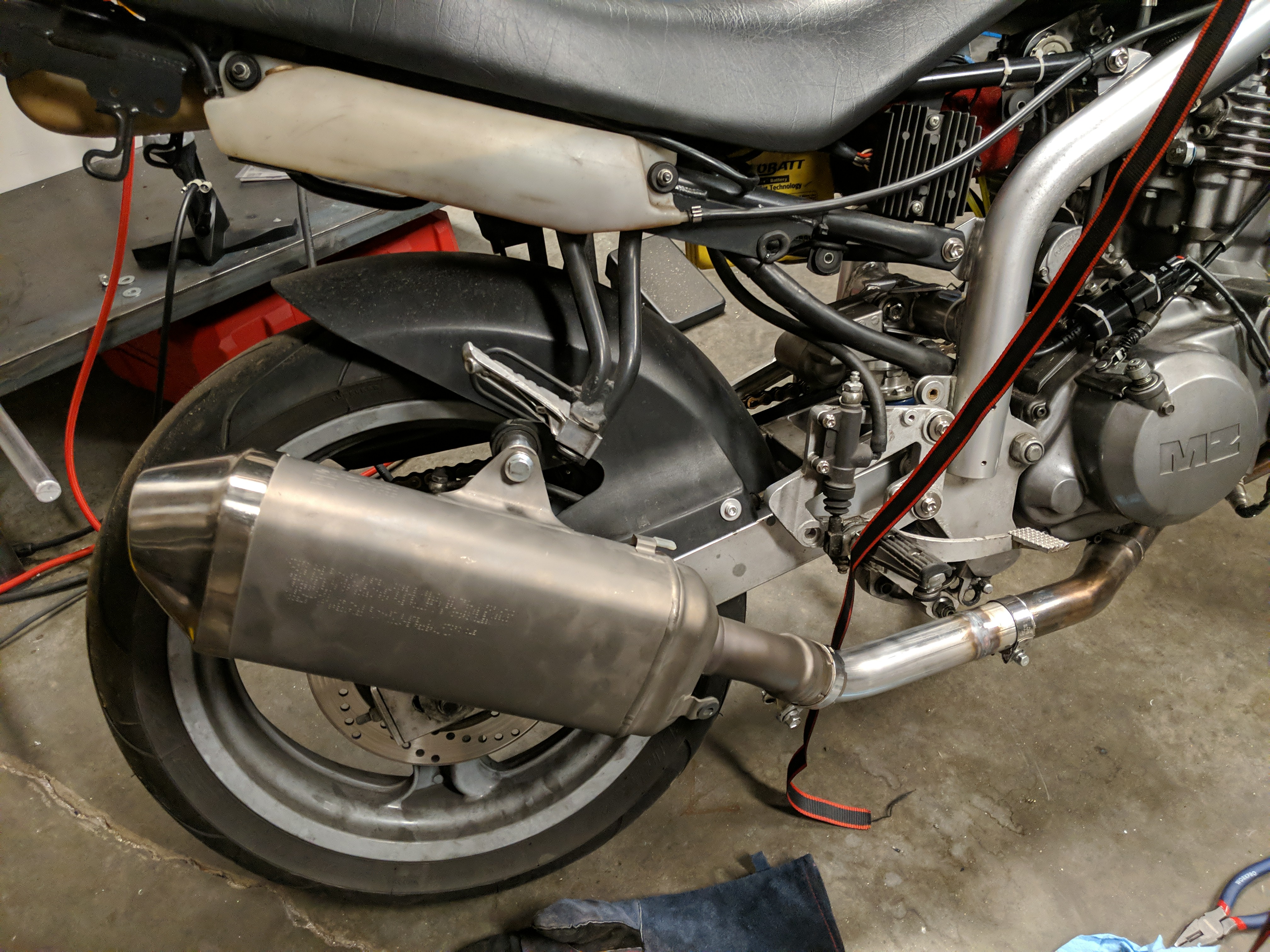

I also scored an OEM titanium slip on muffler from a 2012 GSXR750 that I am going to try and fit. Try and quiet the bike without adding much weight.

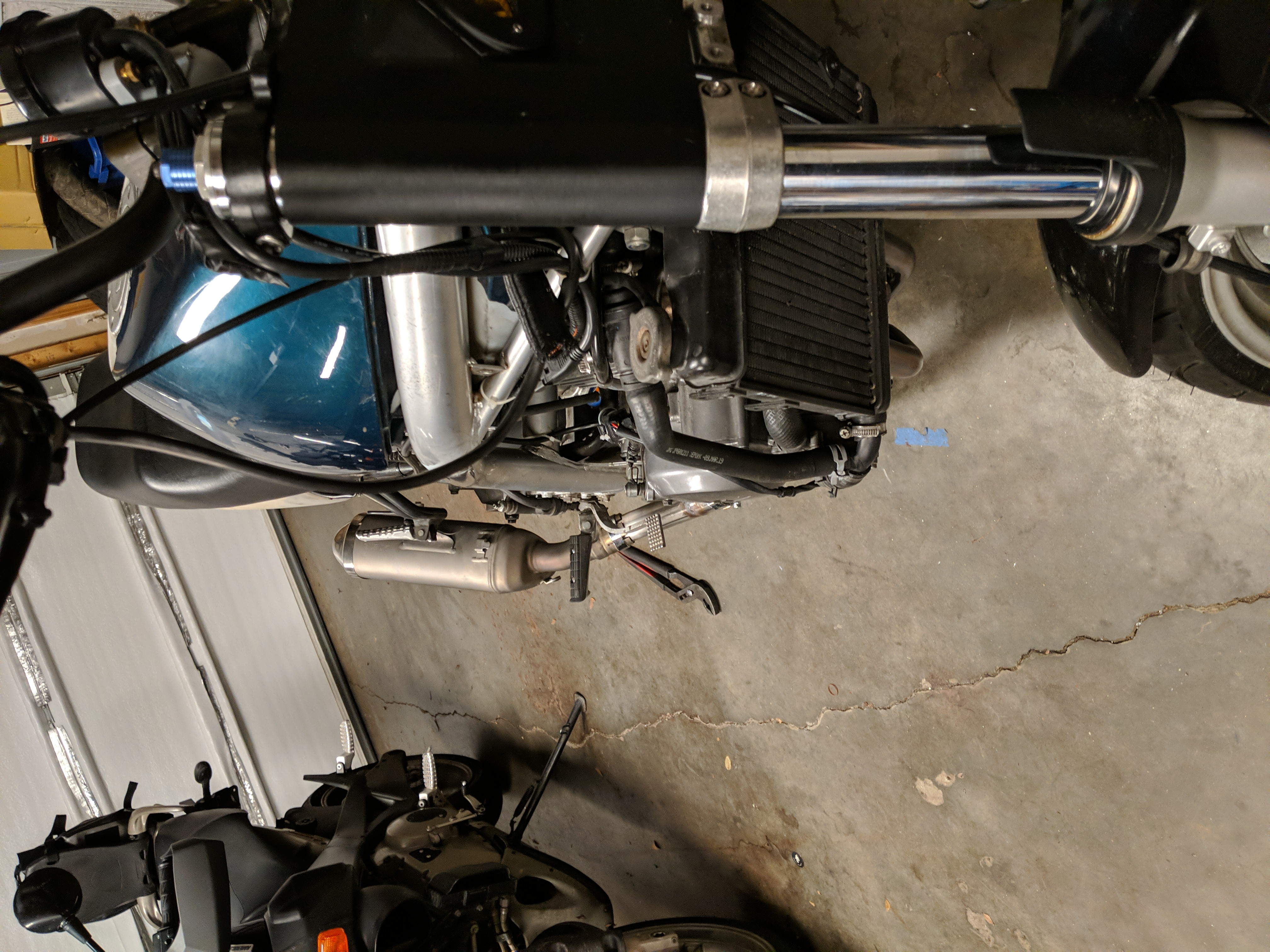

I got the GSXR muffler on last night. I just made a mid-pipe to attach it temporarily for now to see how I liked the noise. SO much quieter, really quite nice. still some nice burble of deep noise without having the same bite.
Because of the way the pipe comes out of the can, I had to extended the muffler out from the car. Now that I have it mounted and like it I am going to try to get it back closer to the bike. The muffler is about the same weight, but a slightly larger package.

Postby Puffs » Tue Sep 01, 2020 7:07 am
It seems nicely made, but indeed maybe a bit big for the bike. And yes, maybe try to get it a bit closer to the wheel.

It is a bit big, but thankfully no heavier than the one that came on it. The joys of titanium. And having a quieter bike I am okay with making that trade off. I just got it closer to the bike. The angle is still a bit odd, but it doesn't feel like it is protruding as much.

What is that plastic tank above the silencer, radiator overflow tank? There isn`t one on the Mastiff, can`t you get rid?
