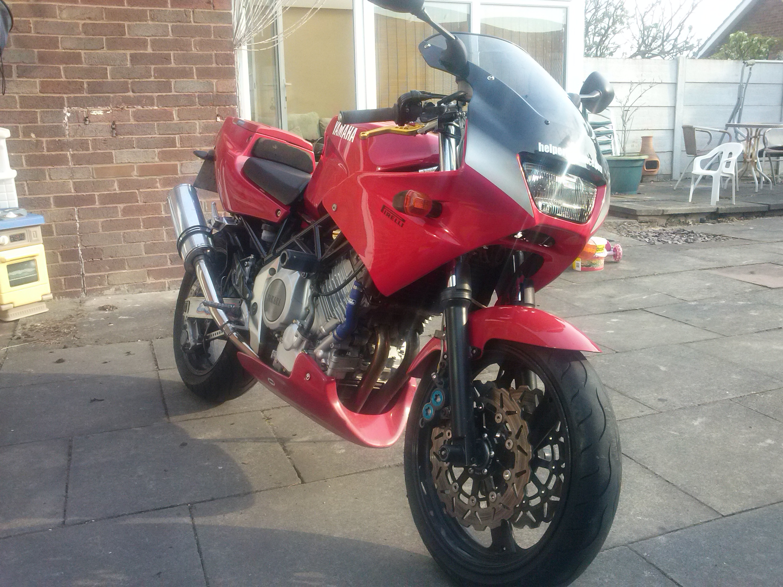

TRX 850. It's the best upgrade you can make to an Skorpion, especially when fitted with a good quality bulb (Philips +60% for me).
I can see where I'm going on low beam now on my Traveller, which is rather a novelty after years of squinting into the gloom.
