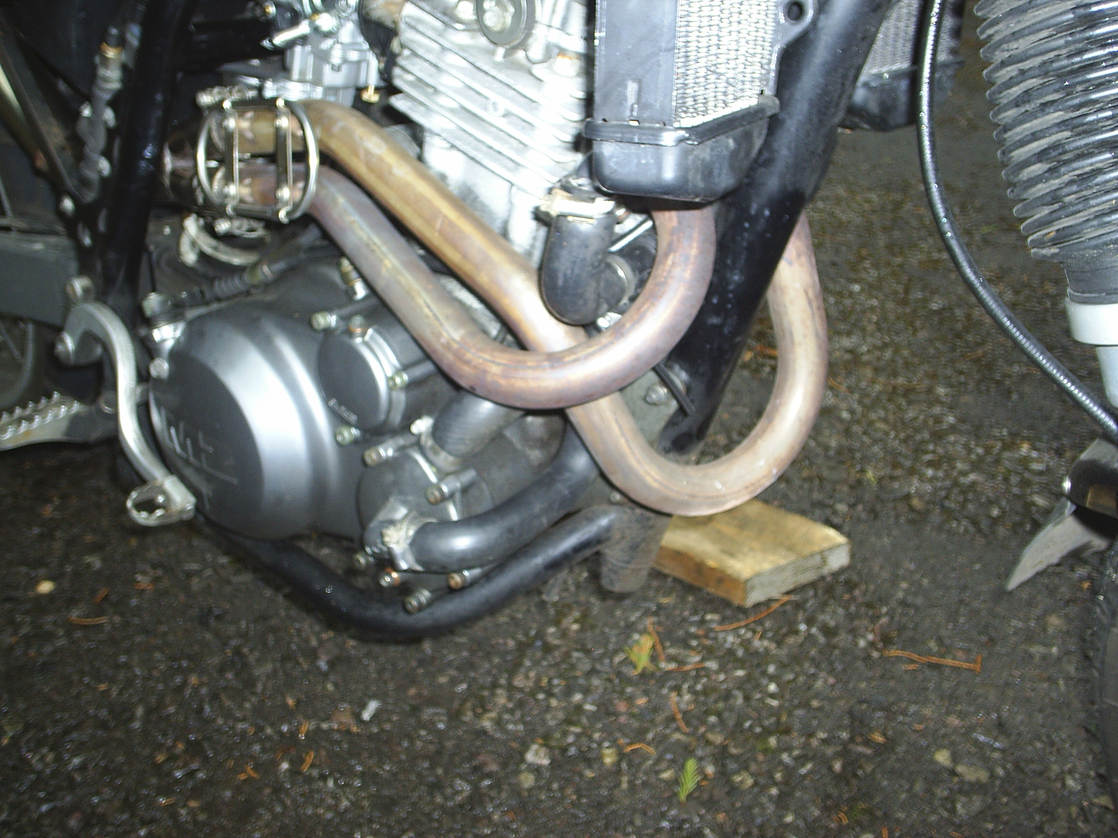

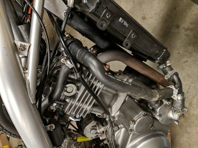

jpmsteadi wrote:Here is one more picture closer of where the thermostat ends up.
Initially I was thinking I would need to build or 3d print a bracket for it, but it seems to be very well held in by the hoses, the oil return line from the head, and the clutch cable.

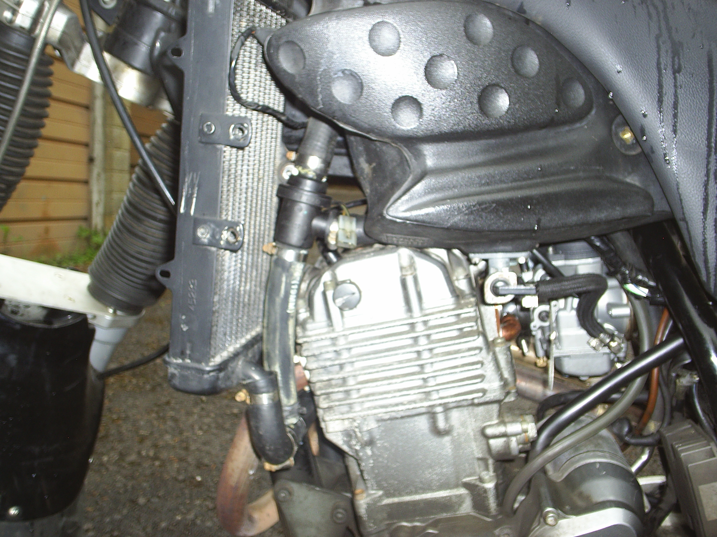

Well here`s mine.
Took a lot of time to end up with something fairly simple looking. From the RH side it looks no different and unless you know what you are looking at the RH side looks quite `normal`. I removed the fan after realising that the only time it comes on is when i leave the bike idling just to see if the fan comes on!
Much to my surprise it does seem to run better!
Re: Skorpion 660 Lightweight Build
Postby jpmsteadi » Wed Sep 02, 2020 11:49 am
nice, that looks great! I might add the fan back on if I was gonna go offroad, but I bet for normal riding doesn't really matter.

Postby breakwellmz » Wed Sep 02, 2020 2:52 pm
I must admit i`ve had very little to do with motorcycle water cooling systems but I was surprised to find that even with the KTM thermostat closed there was a small supply to the top of the radiators, but then they are losing some fluid from the bottom even with the thermostat closed?
My closed thermostat/radiators by-passed coolant route isn`t as direct to the water pump as yours which i`m still thinking about.
Postby jpmsteadi » Wed Sep 02, 2020 6:07 pm
Yes, it seems like mine has a tiny bit of bypass too. The thermostat isn't a full open or close thing, its a gradual opening and closing as the metal inside expands and contracts, so even if the theromstat is fully open at, say, 200 degrees, it is going to start opening well below that. So my guess is there is just a little bit of leak by. I notice my temp gauge (which is in the radiator) getting warmer even as the engine is still warming up. Once it is warm it doesn't seem to drop back below 100 degrees, so there must be at least some flow with the thermostat closed.

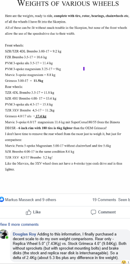

Postby droy » Fri Sep 04, 2020 7:25 am
wheels make a big difference. There are option that allow for a 15 lb rear wheel weight savings. I'm sure your R6 wheel is a few lbs. lighter.
Postby jpmsteadi » Fri Sep 04, 2020 10:46 am
What rear wheels save 15 lbs?!
And yes, the fork swap saved about 6 pounds I think.
jpmsteadi
Posts: 127
Postby droy » Fri Sep 04, 2020 2:50 pm
