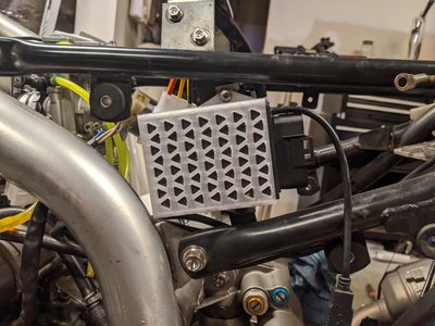

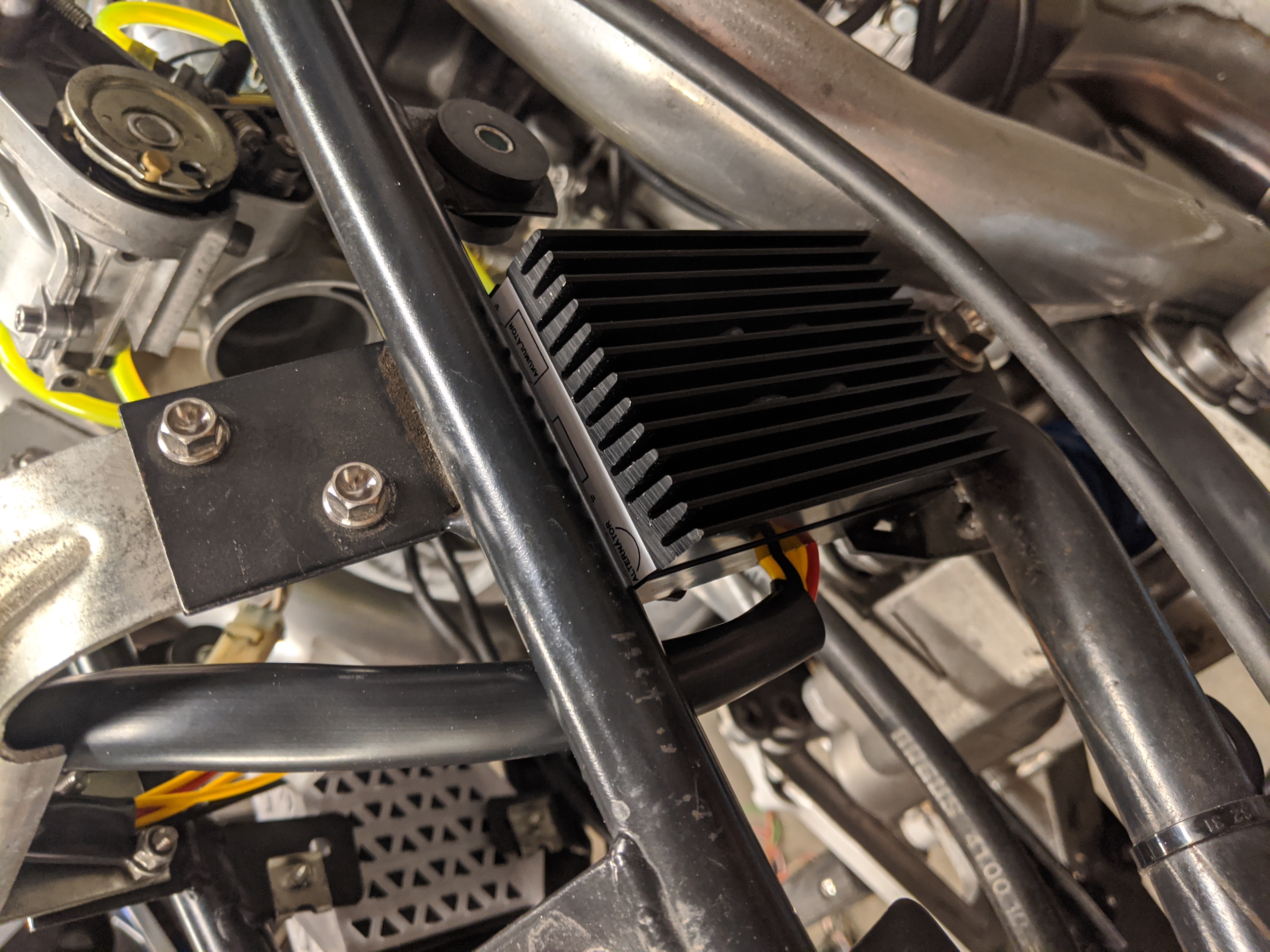

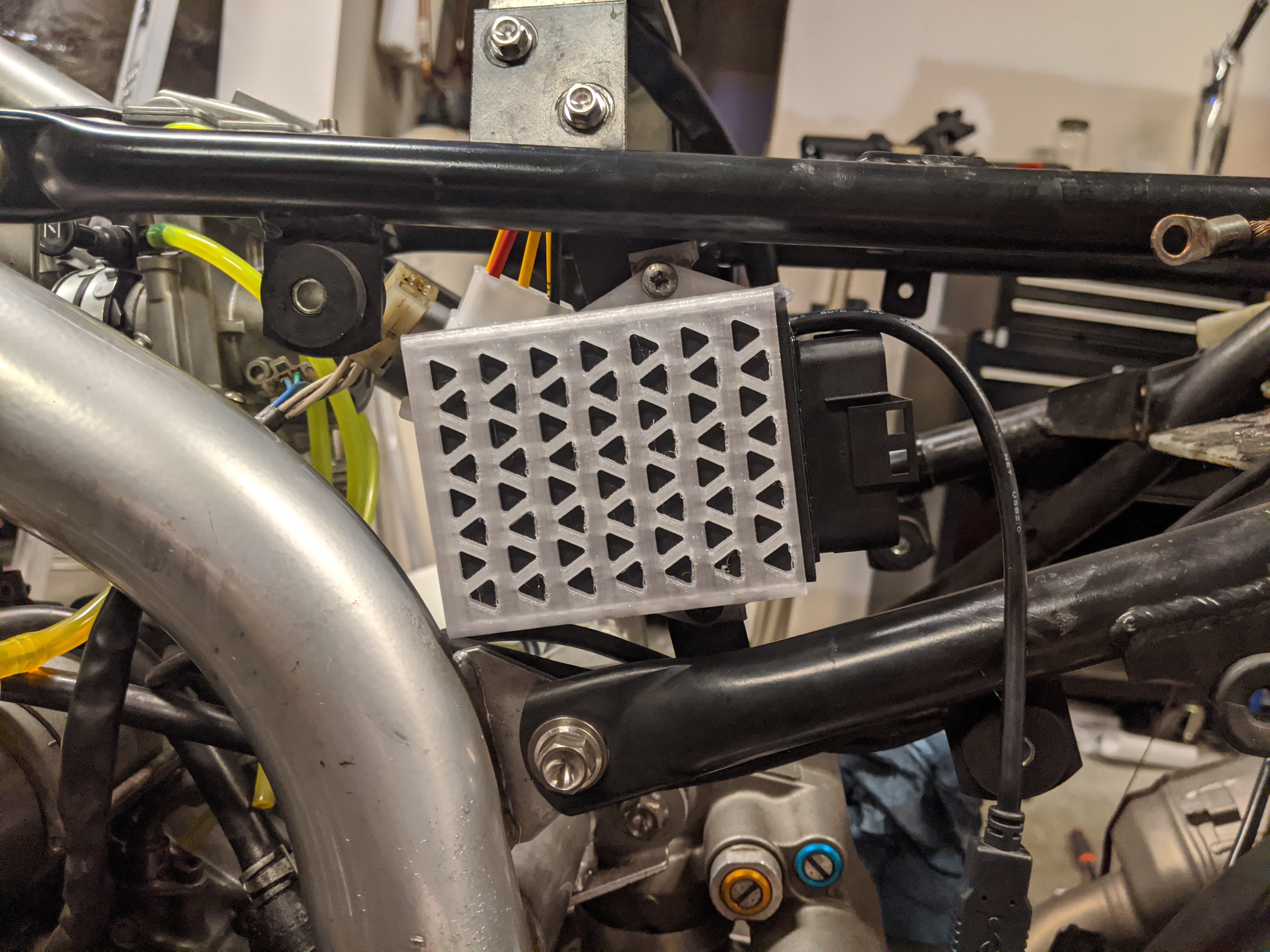

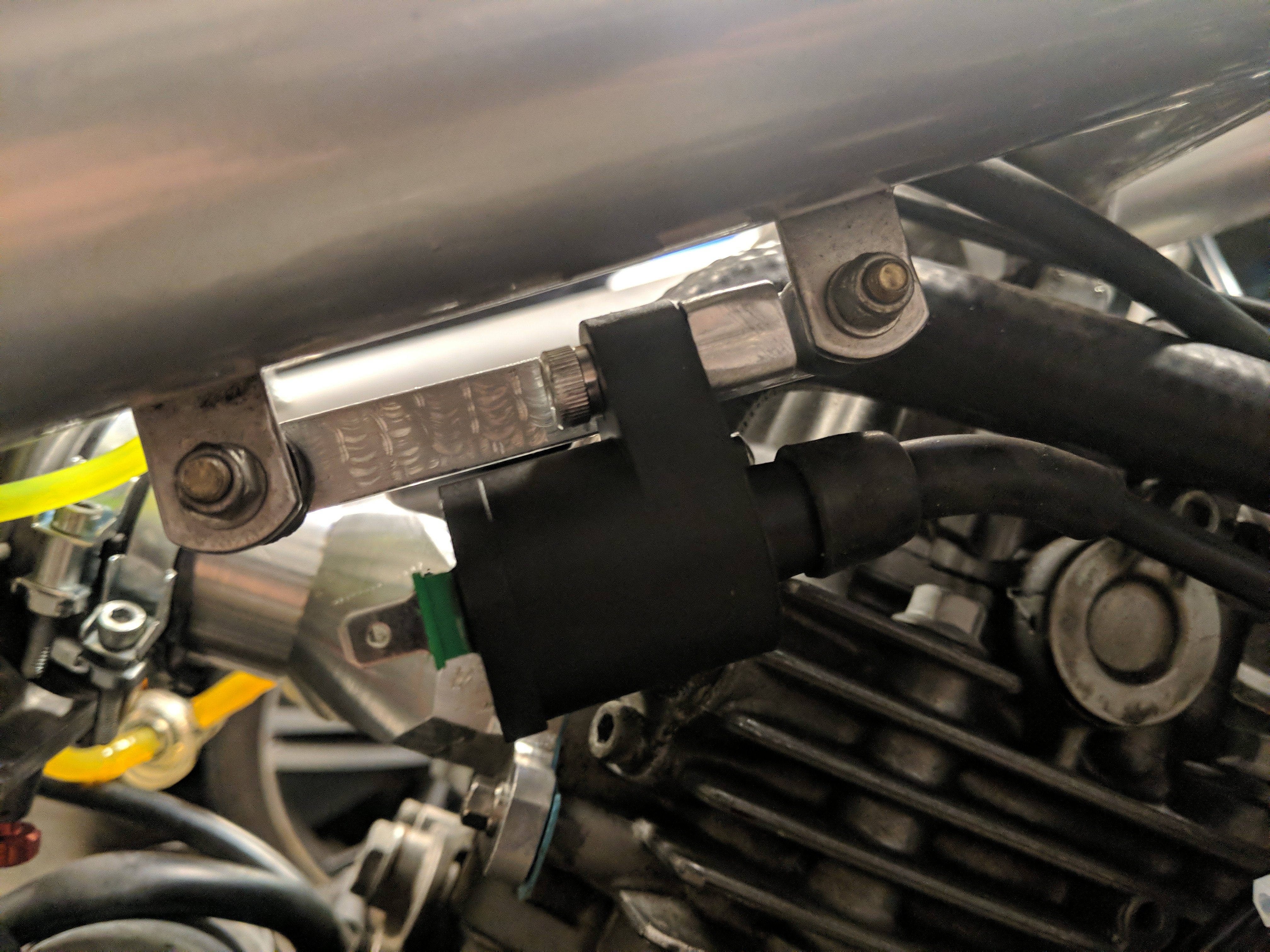

The spark box from bill finally came in. Along with a new rectifier and new coil for the CDI. I am making brackets for it all and mounting them.
The CDI:
The Rectifier:
and my favorite, the coil:

I am going to do another rewire as well, hoping to make it cleaner and final this time around.

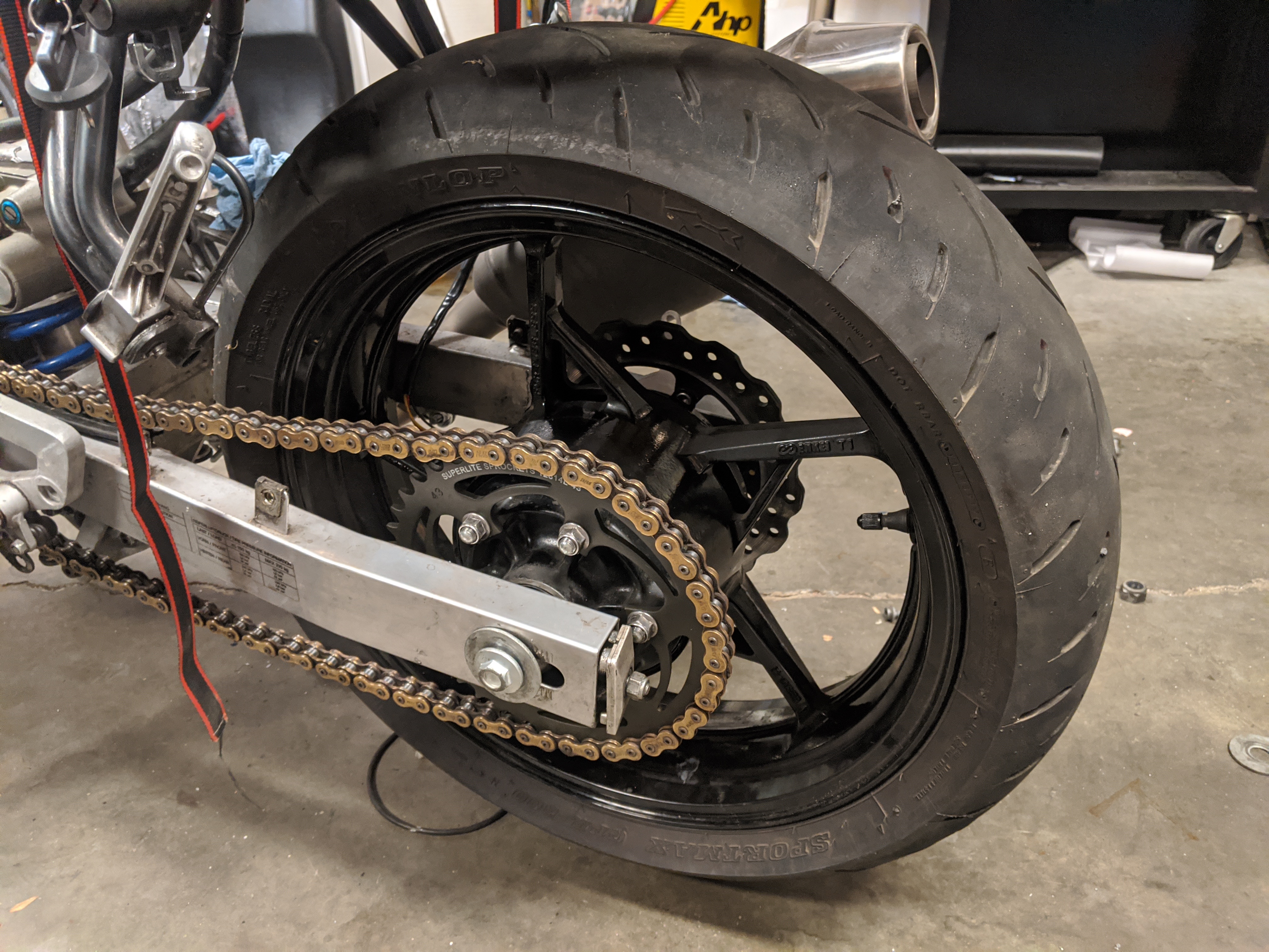

The rear wheel swap is going well too. The axle for the ninja is also a 17mm and is very close to the proper length too. And I like the look of the rims too. If I end up really liking it I might get a front wheel for it to match.

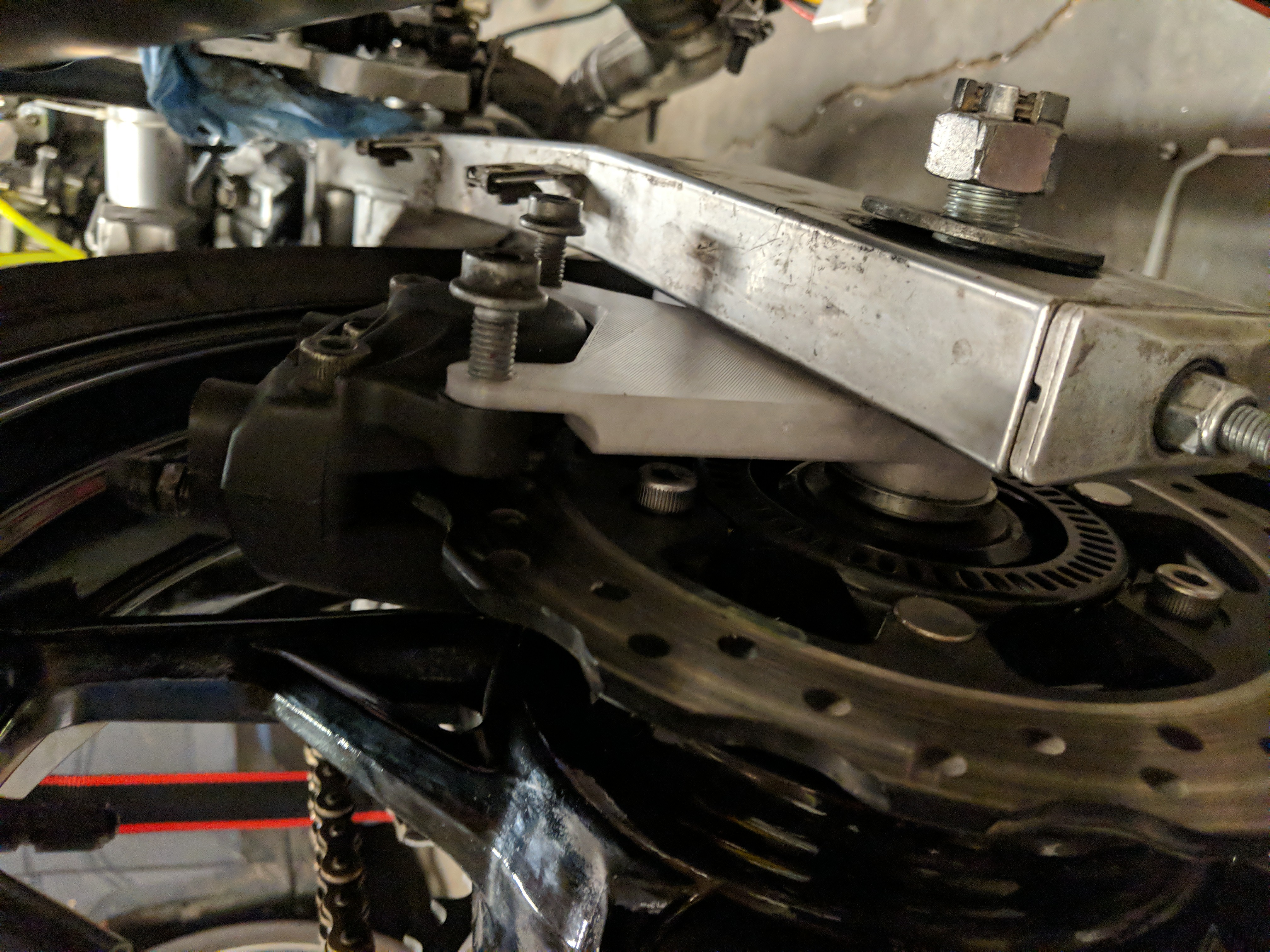

I have a 3d printed caliper bracket to check for alignment before making the part on the mill. Seems like its going to line up! (and the mount will end up extended over the swingarm and being thicker where the bolts mount.

That rim sure seems light, but I wonder if that bracket the calliper hangs on is strong enough?

I mentioned in the previous post, but that caliper mount is to just see if everything is going to line up. The final mount will be much thicker and in aluminum.

looking great - two rear wheel questions:
You said the axle was close on length (and 17mm). would it work as a stock replacement (a little long or short)? I hate the stock axle - looks like its from the 50's
what machining did you do to get the 400 wheel to work?

the axle should work for stock as long as you keep the big washers: it is a bit longer and will need that space taken up by the two washers.
As for machining: so far none, but I will end up making to make the new brake caliper bracket and make a wheel spacer to take up the rest of the space. I don't think it will be a hard project, but certainly one that would be very difficult without machine tools.

Printed for testing - yes I overlooked that, apologies.
