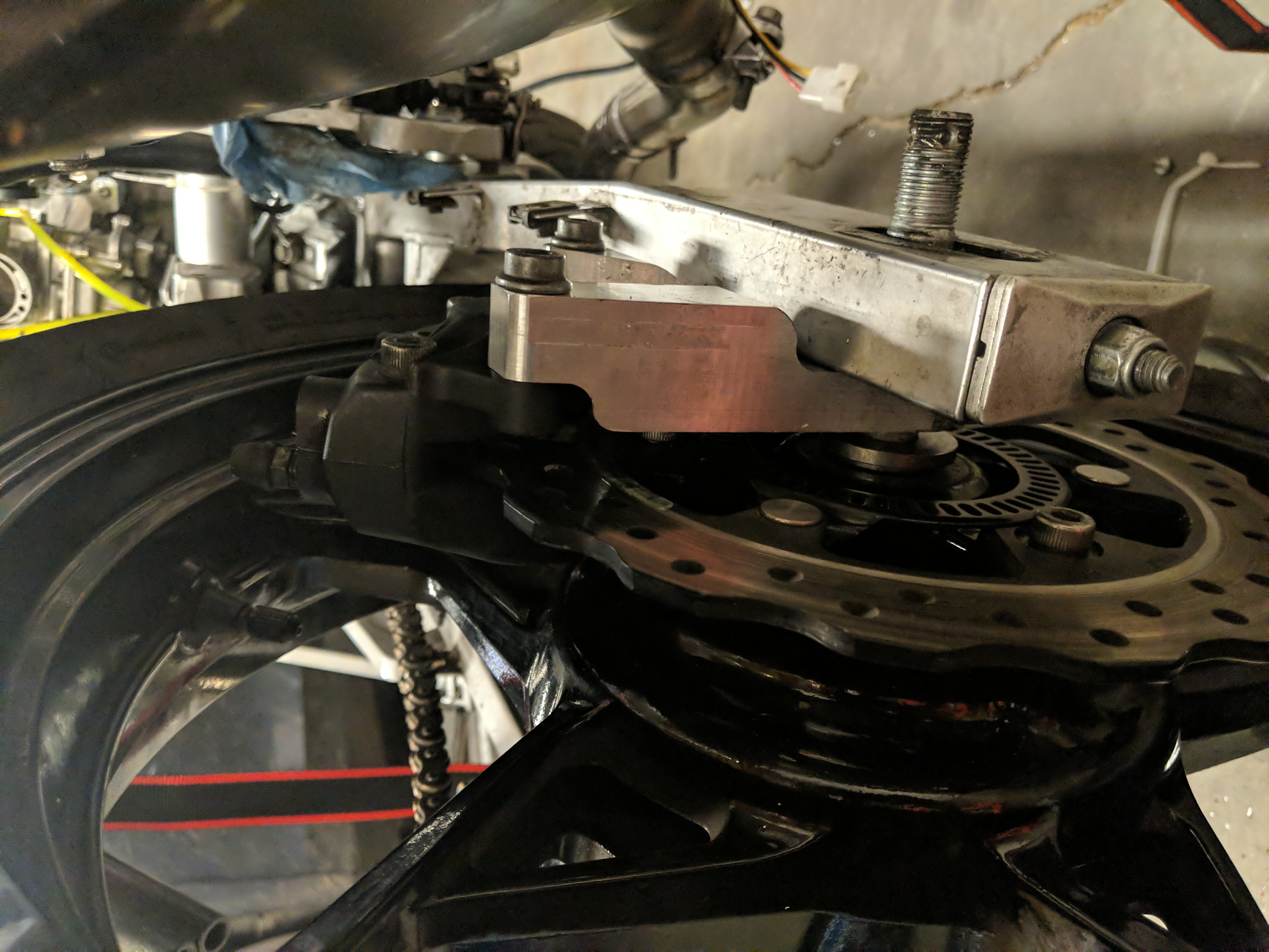

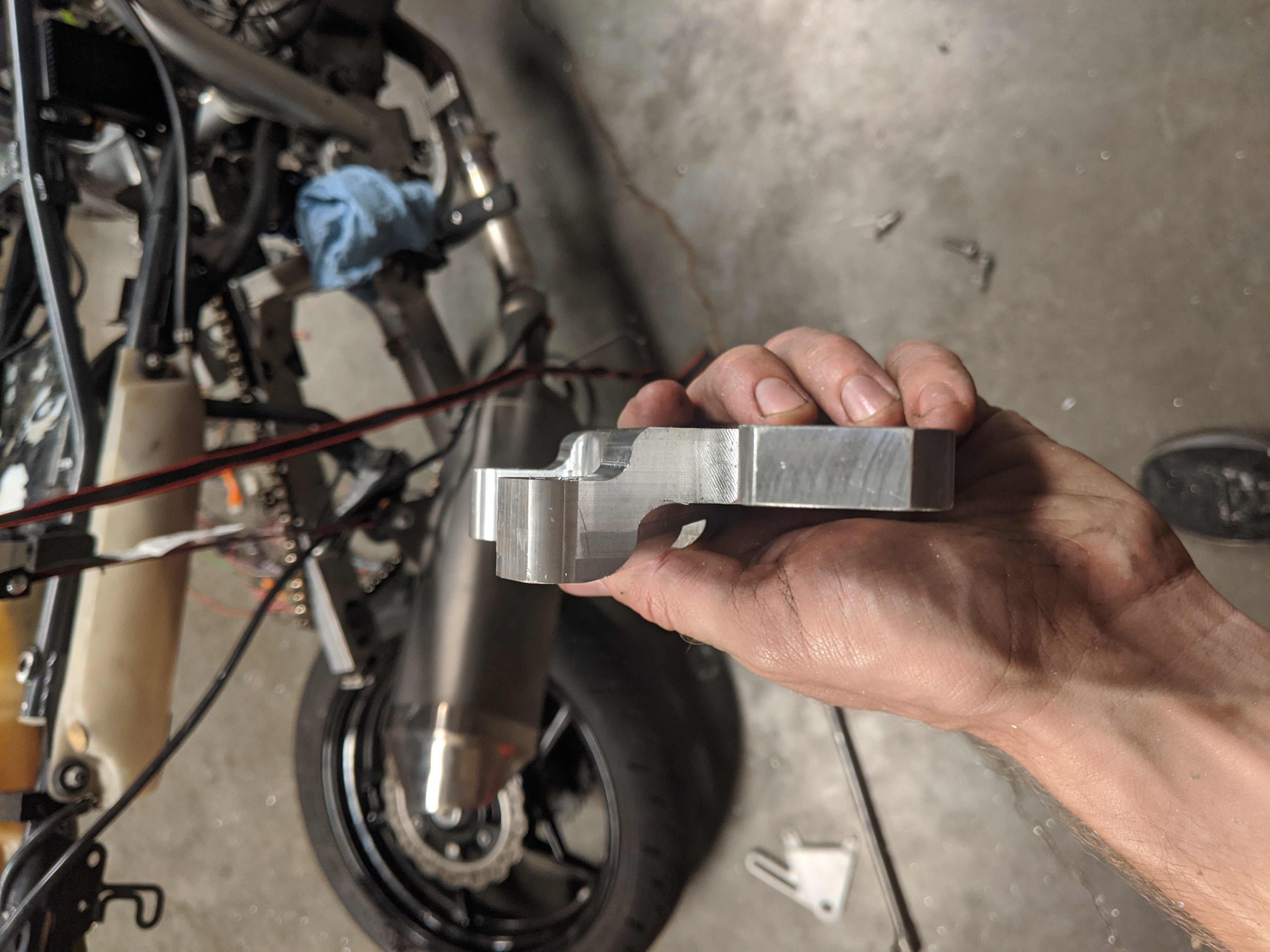

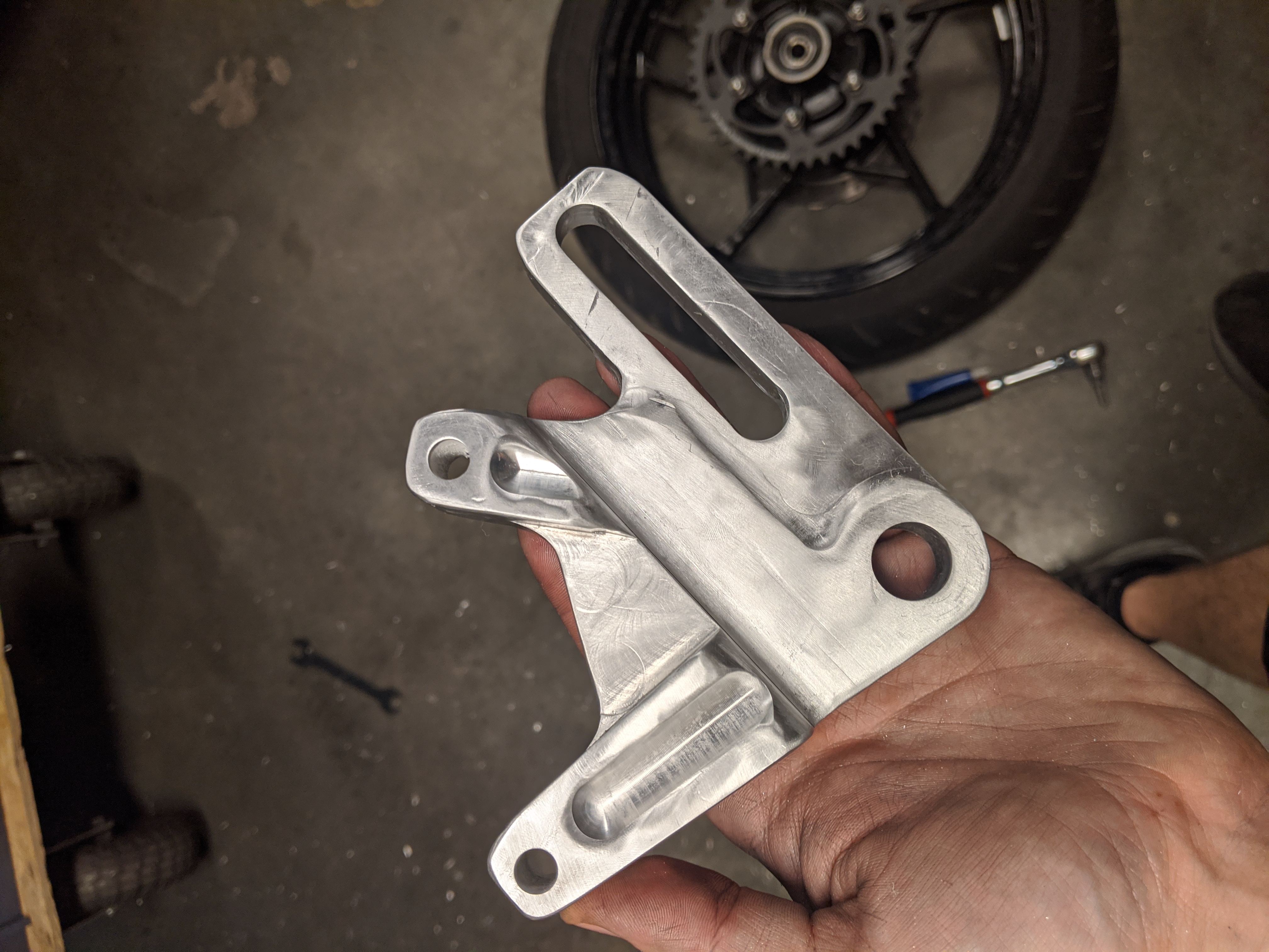

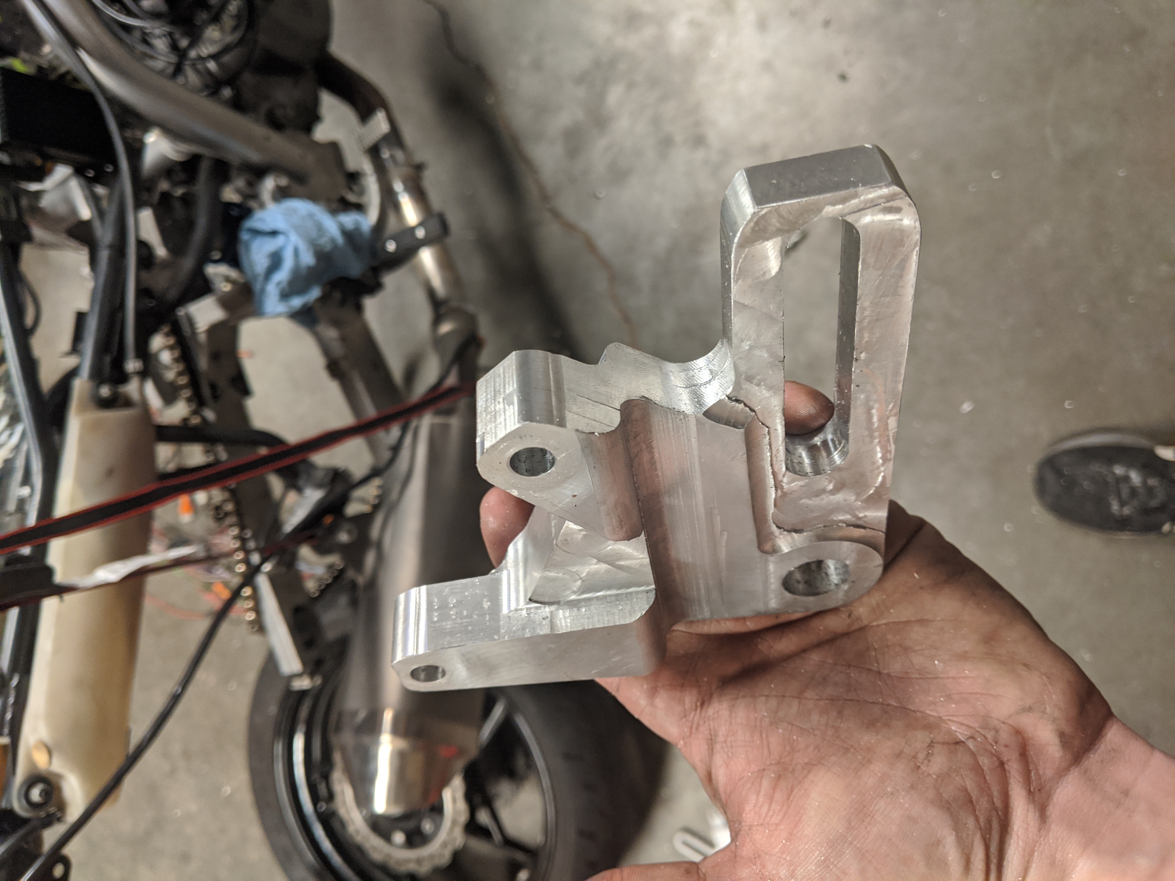

So I spent all day in the garage today working with the mill (and the new rotary table I got, though its already broken....) making the brake caliper bracket to adapt the ninja 400 wheel to the MZ swingarm. It certainly looks and feels like its made on a manual mill, but it will work! I am going to go over all of it with a sander tomorrow and get it a bit nicer looking. It is about the same weight as the stock bracket, perhaps a touch heavier. I will weight them tomorrow when I am done. I am also doing the wheel spacers out of aluminum vs the stock Ninja steel ones. Should save some weight too.

something like that is a bit of work on a manual mill

A bit of work indeed! I am getting faster at it, but this took me about 8 hours today.

That should be plenty strong! And maybe even allow for some weight saving, as you said.

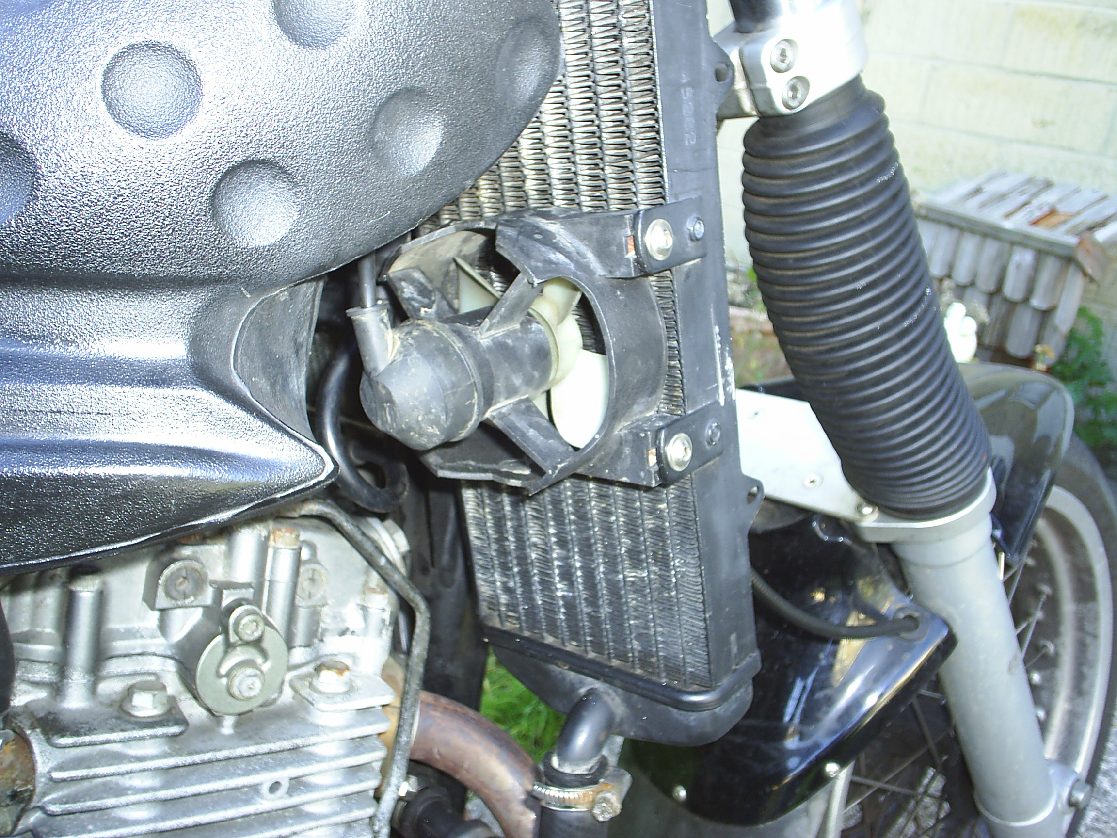

I hope you`ve got rid of that radiator overflow tank by now!
Re: Skorpion 660 Lightweight Build
Postby jpmsteadi » Fri Sep 25, 2020 2:24 pm
Alas, radiator overflow is still there. Not sure it is going to go if I am honest. Not sure how much lighter I can make that.

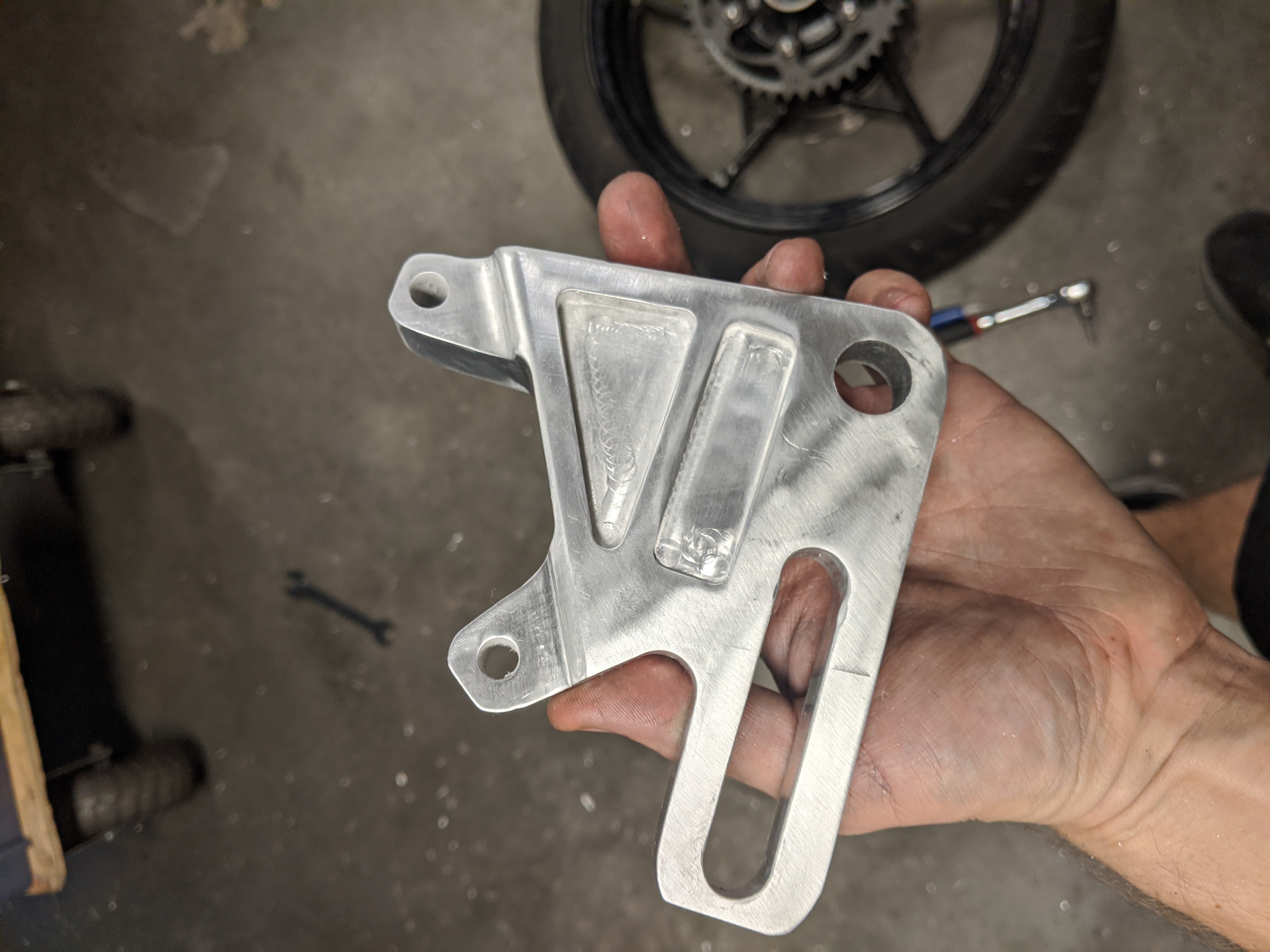

Speaking of making things lighter: I woke up this morning with a newfound determination to get this rear wheel mounted. I took a scale downstairs and found that the stock MZ rear brake bracket weights 371 grams. The bracket I made weighed 399. DAMN! I can't be putting something on that is HEAVIER than the stock piece. So back to the mill it went. In two rounds I ended up making two pockets in the backside, and two rounded cutouts on the front side and got the weight down to 372 grams. I can live with basically the same weight. The new wheel spacers take the weight from 133 grams to 58 grams. I also got some titanium brake rotor bolts. Every little gram, right?

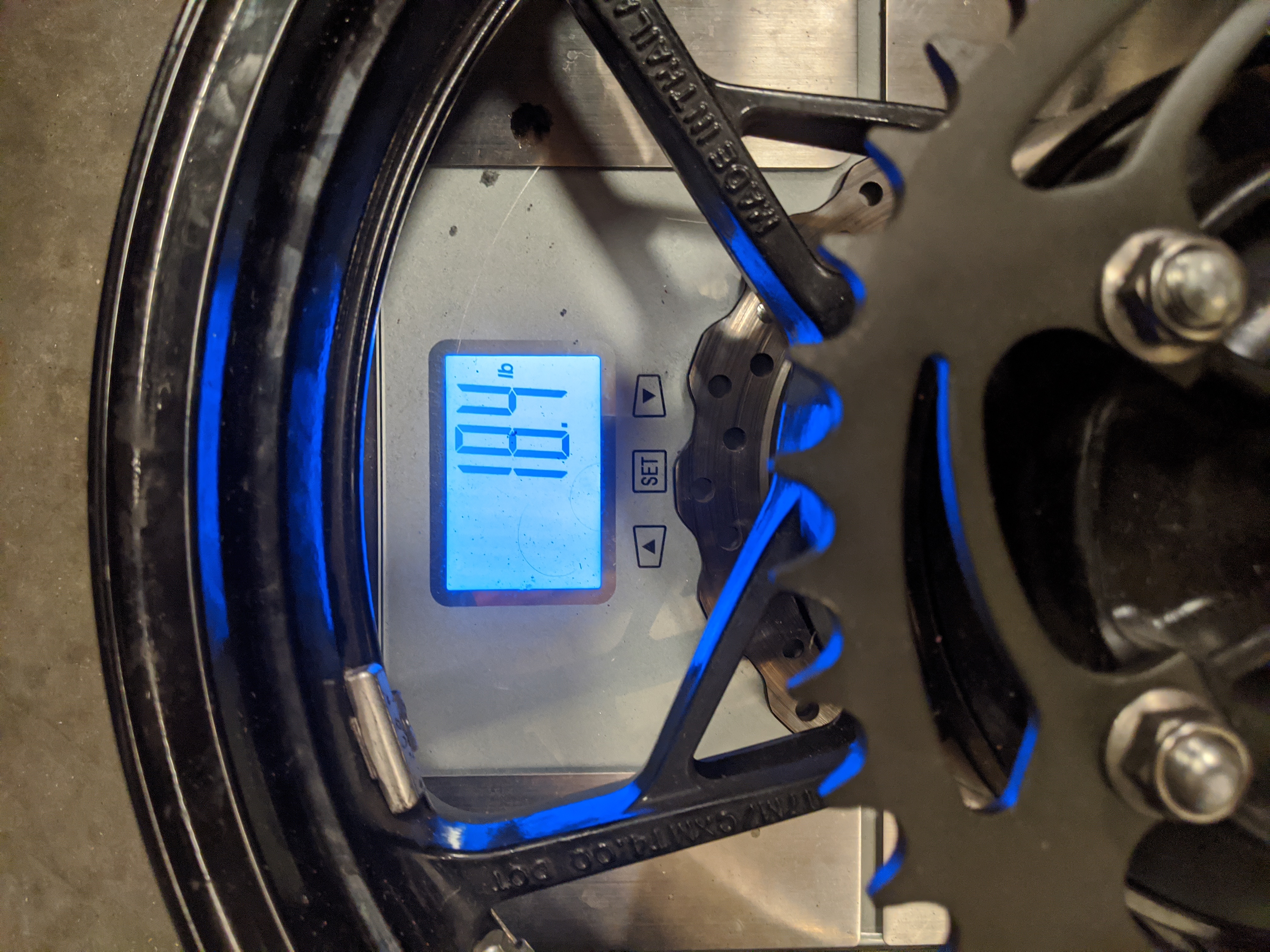

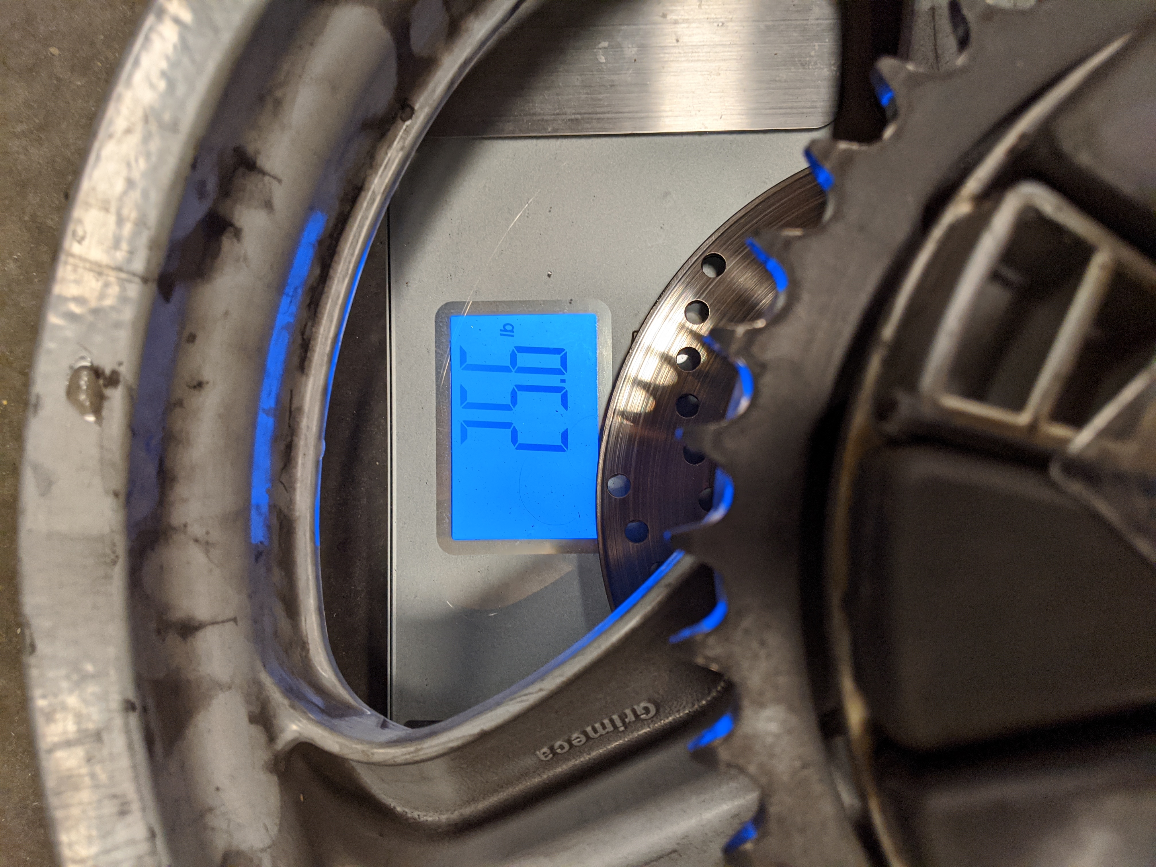

After fighting with some tires this afternoon I have wheel weights. Both of them are without tire, but with brake rotor, sprocket, cush drive, and wheel spacer(s).
The stock MZ:
The Ninja 400:
7.2 lbs (3.26 kg) aint nothing. Especially in rotating mass. Pretty happy with that.

The overflow tube from my radiator (If that`s what that tank is for) just drops (drips) down to the ground, do non USA Skorpions have that tank?

On the coolant tank: have a good look what it does. The KLX650 I once had, had one too, and if I remember correctly it was an expansion tank. Coolant went both in and out, depending on how hot the engine was (different expansion coefficients).

The coolant does go in and out. allows the engine to expel some coolant without drawing back in air. If I were going to keep the bike truely naked and not put the side panels back on I would firgure out a better looking solution, but since I am not, I am not too worried about it.

Is that a cheats way of getting a larger coolant capacity without a bigger radiator?
Surprised Mastiff and Skorpion have such different cooling systems, two radiators on the Mastiff.
:idea: GO WATERLESS COOLANT! :idea: You won`t need an expansion tank then.
You can take the rad cap off a hot engine running waterless coolant as it doesn`t expand with temperature.

Expansion is something else. Most (if not all) materials expand when their temperature increases, both solid and liquid (& gas). If the coolant expands more than the metal (barrel, head), you need some room in the cooing system to allow that. It's not a lot of volume, and often a bit of air is sufficient. Or the manufacturer preferred to include an expansion vessel for it, wanting to prevent air in the radiators, for instance. Very common in cars too.

BTW - put a Skorpion Replica wheel on the scale ( with rotor, disk, crush and spacers) last night - 19.7 pounds. That 1.6 lb from the 400 wheel is a nice weight savings.
