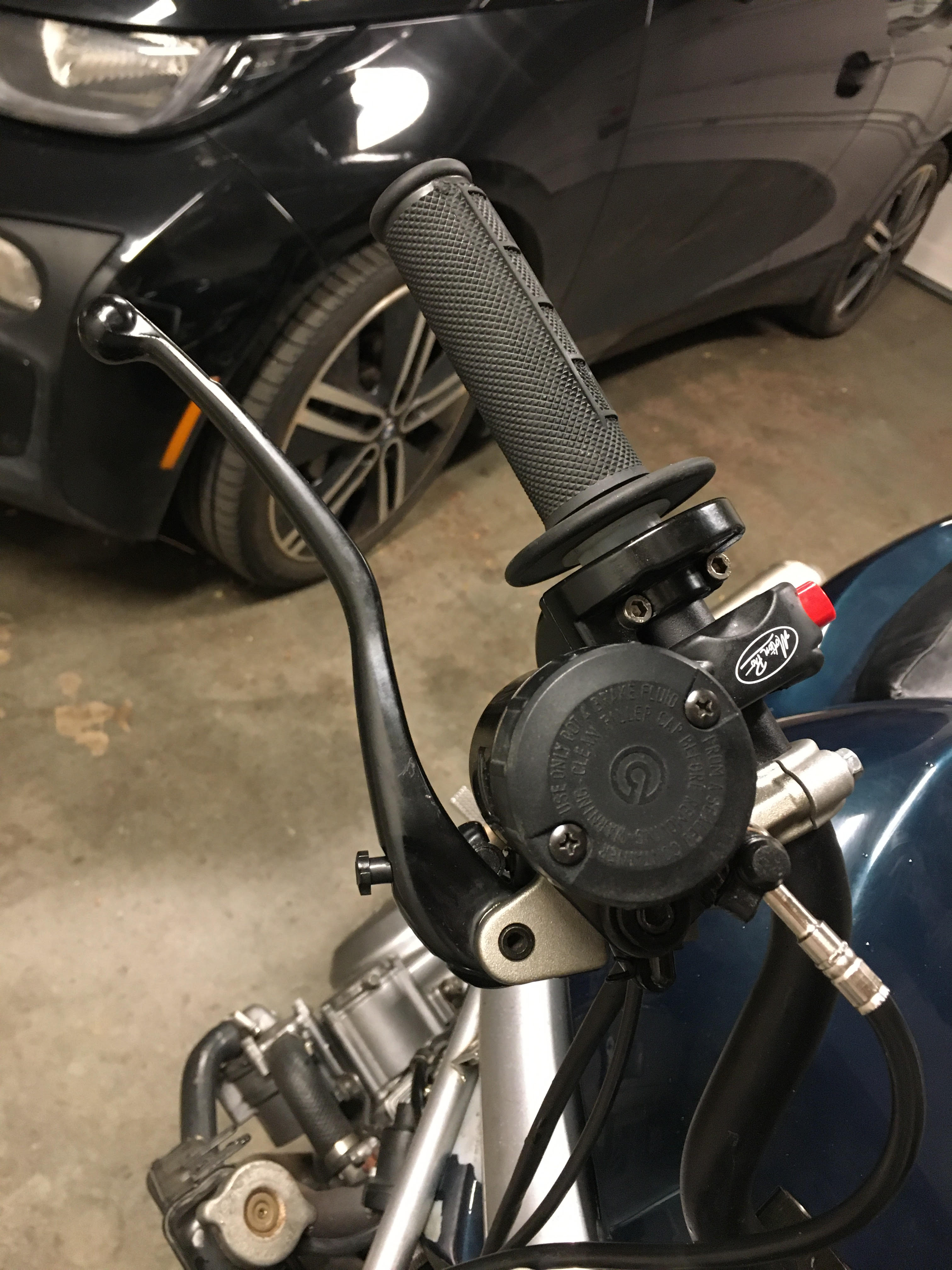

In addition to the FCR, I also found an ordered a radial brembo master cylinder for the front brake off of a Ducati Multistrada (I think 2015-2017). It has a 14mm piston and is lighter and smaller and MUCH nicer than the nissin that was on there. I understand that at some point someone took the OEM master off and replaced it.
Here is a picture of it fitted:
I rode it around for about an hour this morning and am very pleased with the feel and stopping power. Good initial bite then building linearly to full stopping power. A HUGE improvement. And only 130 bucks on ebay. It required a litle 3d printed bracket to fit the reservoir but that was knocked out this morning quickly. I think I will try and find a smaller reservoir; the one that came with it is huge.

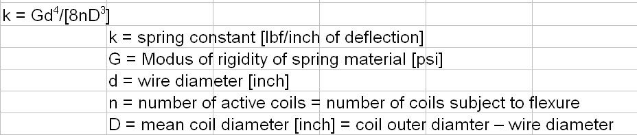

The R6 has a hard, short-stroke racing suspension, so if an R6 shock feels soft on your 660 it means the 660 has another transmission ratio (more movement rear wheel per movement shock). Is the shock's stroke compatible with the 660's suspension construction? And also, if you fit a stiffer spring on the same shock, you may find it is underdamped.
I don't know details of the original spring on the 660, but you can estimate the spring rate using:
Or search for 'spring rate calculator' on the web.

Interestingly it seems that the R6 actually has about the same stroke as the MZ shock. It does seem as though the linkage is slightly different, which is accounting for the difference in spring rate observed.
I actually used that formula yesterday and estimated a spring rate of 145-155 N/mm on the stock spring (depending on the alloy of steel being used, which is an unknown). This is in line with the aftermarket shock I saw on the internet being advertised as 175 N/mm. It seems that the stock spring is just about perfect for my weight. In talking with a suspension guy it seems that because of the slightly less overall length of the R6 shock it would behoove me to shorten the dogbones slightly in order to get the same ride height as stock. I am going to play around with making some dogbones that are slightly shorter.

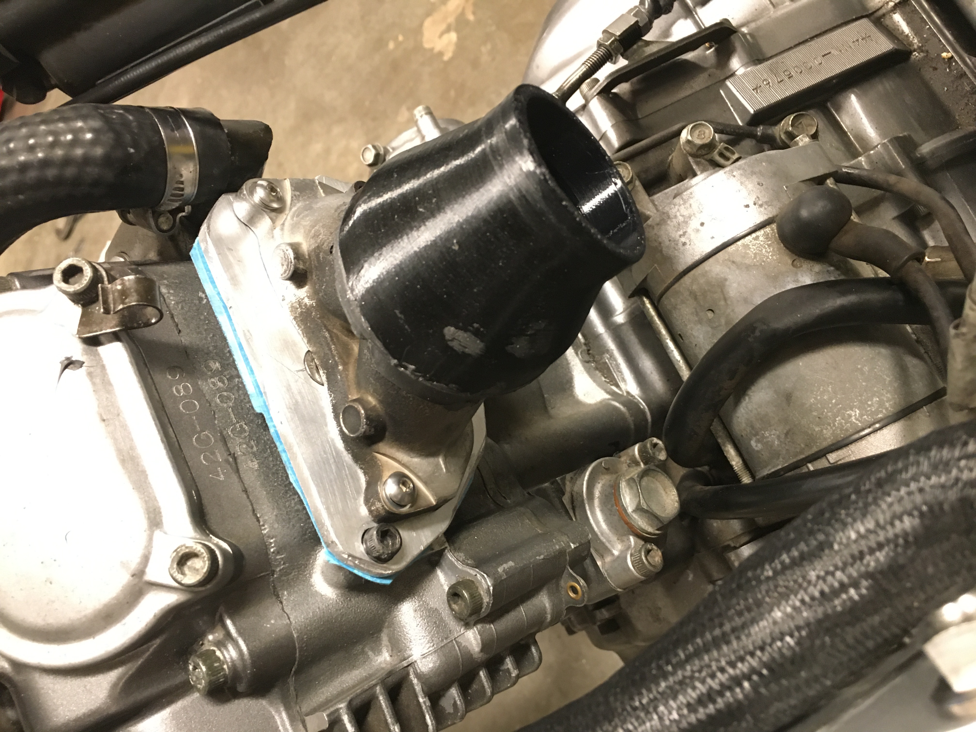

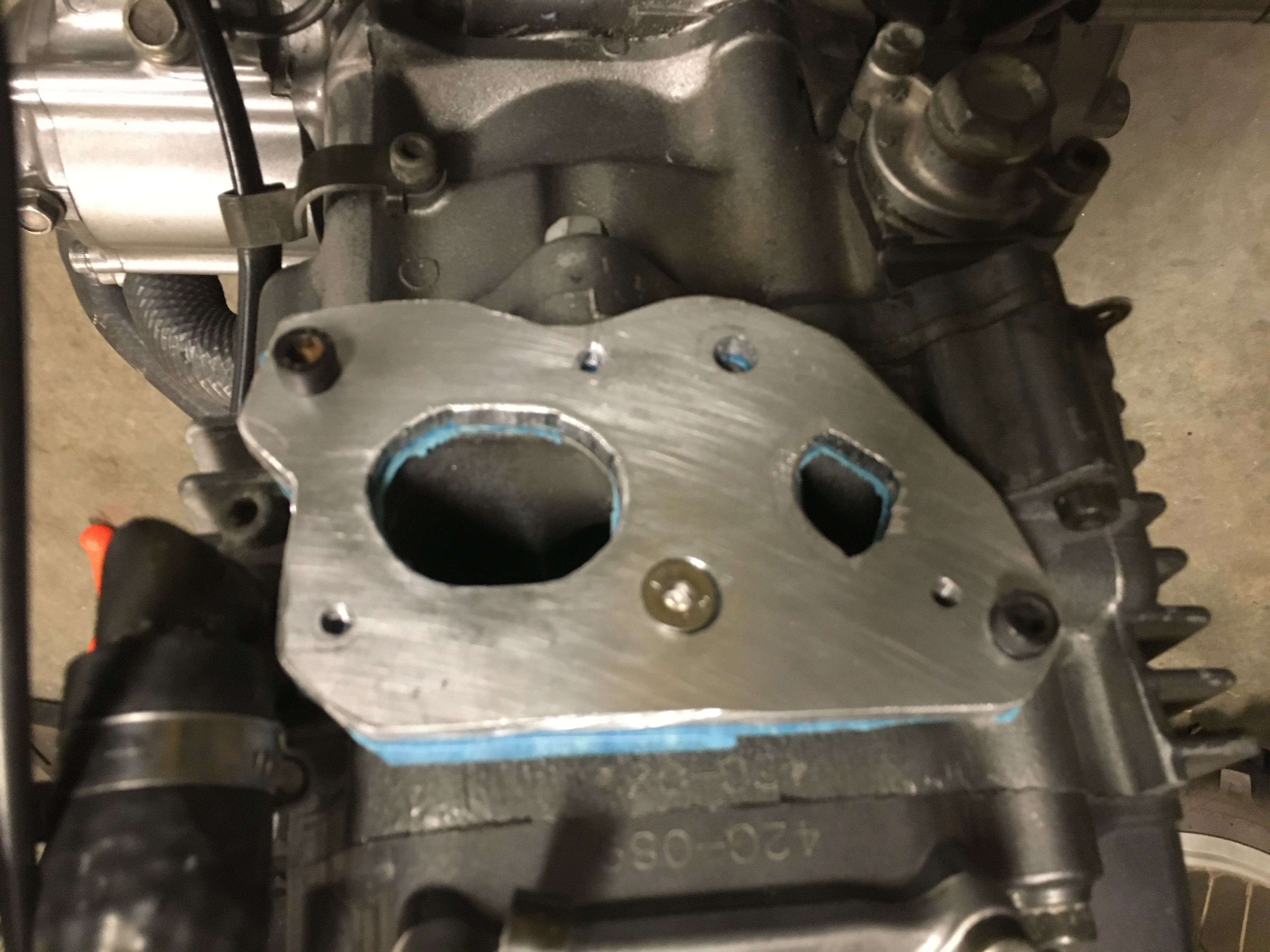

Here is some pictures. This is not an ideal setup yet. The adaptor plate from the head to the manifold needs to be thicker to allow for the passages to widen to the correct width from the head. This is a down and dirty setups until I get the machine tools in to do a better, more precise job (I sent my check off for a mill and lathe monday!!! Been interested in it for awhile and finally bit the bullet).
So because of that the adapter plate is acting as a slight restrictor. Again, not ideal, but I had some spare aluminum sitting around and wanted to get the MZ back on the road.
The adaptor plate is just plate aluminum cut to rough shape with a jigsaw then cut holes in, the gasket is 1/16" gasket material from mcmaster car. There is that PETG 3d printed part that converts the angle of the grizzly manifold to the proper angle to keep the carb clear of the gas tank. It is a press fit part with some RTV on it to seal it from air leaks.

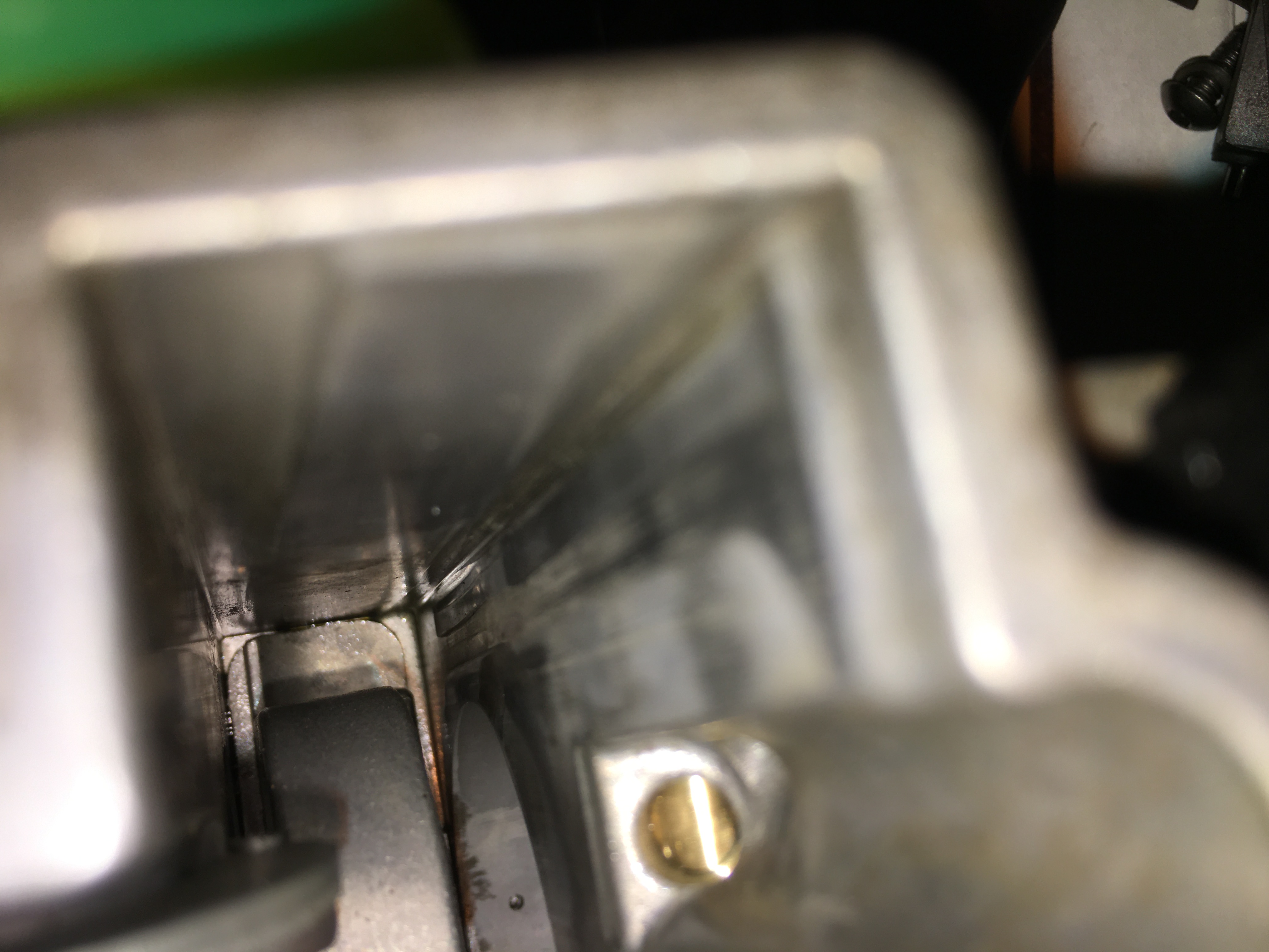

In inspecting the FCR more I have discovered the issue with the hanging revs after throttle close.
I took the side cover off and confirmed that the hanging revs was indeed a slide sticking issue: I could take my hand and force the throttle cam closed and it dropped fast. The FCR normally has a push-pull throttle cable setup, but I have been running pull only (mostly for clearance with the gas tank, but also just for cleanliness. I have been running pull only on the FCR on my DR650 for two years now with no issue).
Well, taking the FCR apart I discovered that the interior bore of the slide chamber has some serious grooving from the slide wheels. Must have had poor filtration some point in its life
This allows the slide to twist slightly and bind, giving the rev hang issue. This has been documented on other forums as something that CAN happen, but doesn't happen often.
As can be expected, the ebay seller said the carb was in "perfect condition save for normal wear". I don't account this as "normal wear", but I doubt anything will be done. Once I get the machine tools in I will attempt to fix the bore (you can put jb weld in the bore, then machine it flat again, or machine a section out and press-fit a stainless steel insert).
In the meantime, I have another FCR body I am going to put all the parts and jets into and try and get this thing running!! (this body is off of a different bike, so alas it doesn't have the air cut valve. some decel popping will occur)
