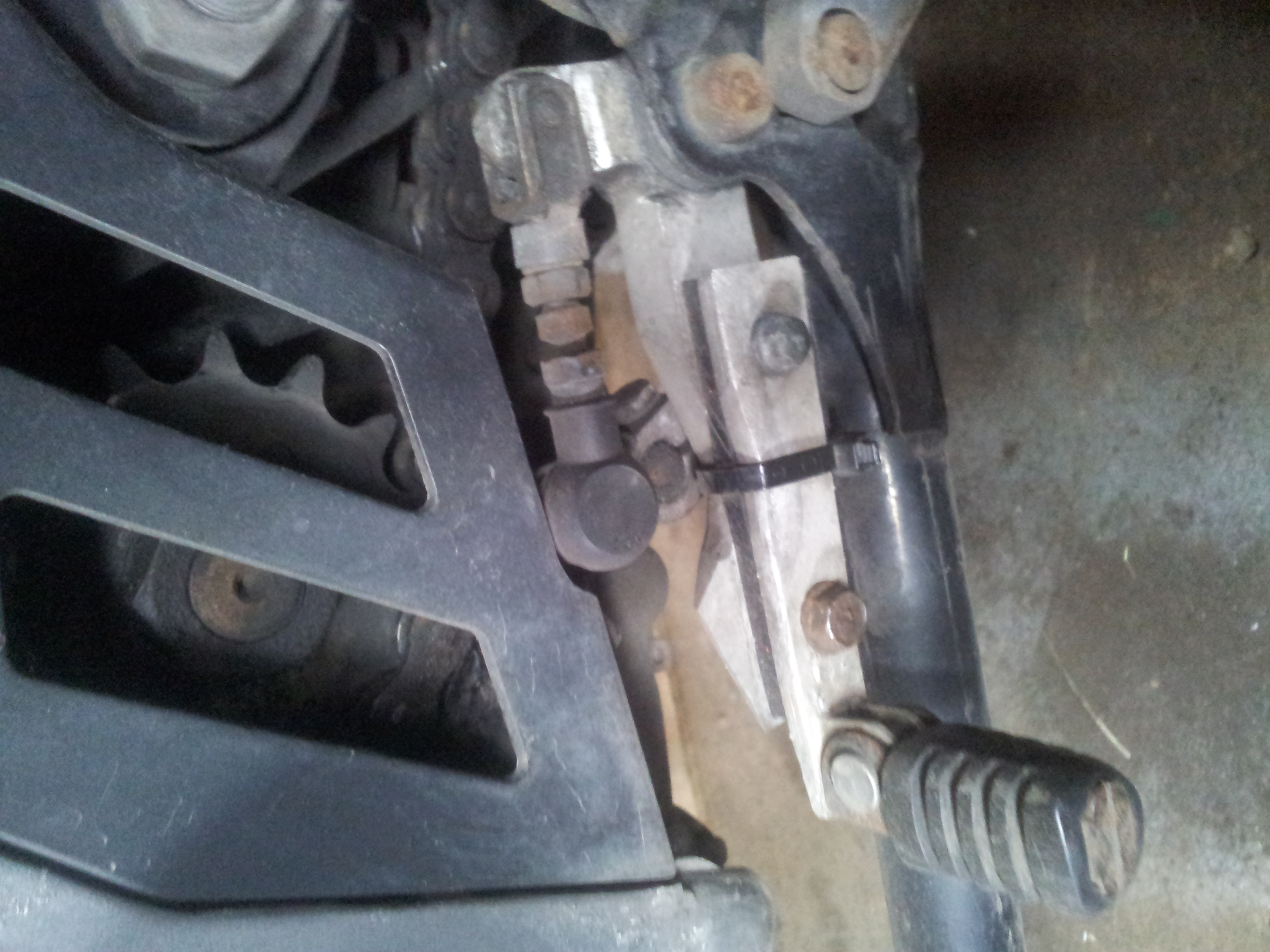

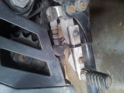

had mine welded and braced but that snapped again a year or so later so machined up a new rear part of the lever and bolted the front haf of the mz one to it,will try and put a pic up of it later
whoops just read all the posts and see i have already posted the above pic,will make an effort with the updated version :oops:
Fingers crossed sorry for crap pic not used bike in months,had a lump of ally lying around and shaped to replace rear of old lever then bolted the front half of lever to ally,cable tie was for positioning it,never got round to cutting it off
i tried to turn this pic so it could be seen proper but it just refuses to turn

That fix looks strong. I was thinking the exact same design. I lost the last 90% of the shifter so I have to fab the toe piece. One of problems with the stock shifter is the frame bolt sleeve needs to be longer and a bearing.

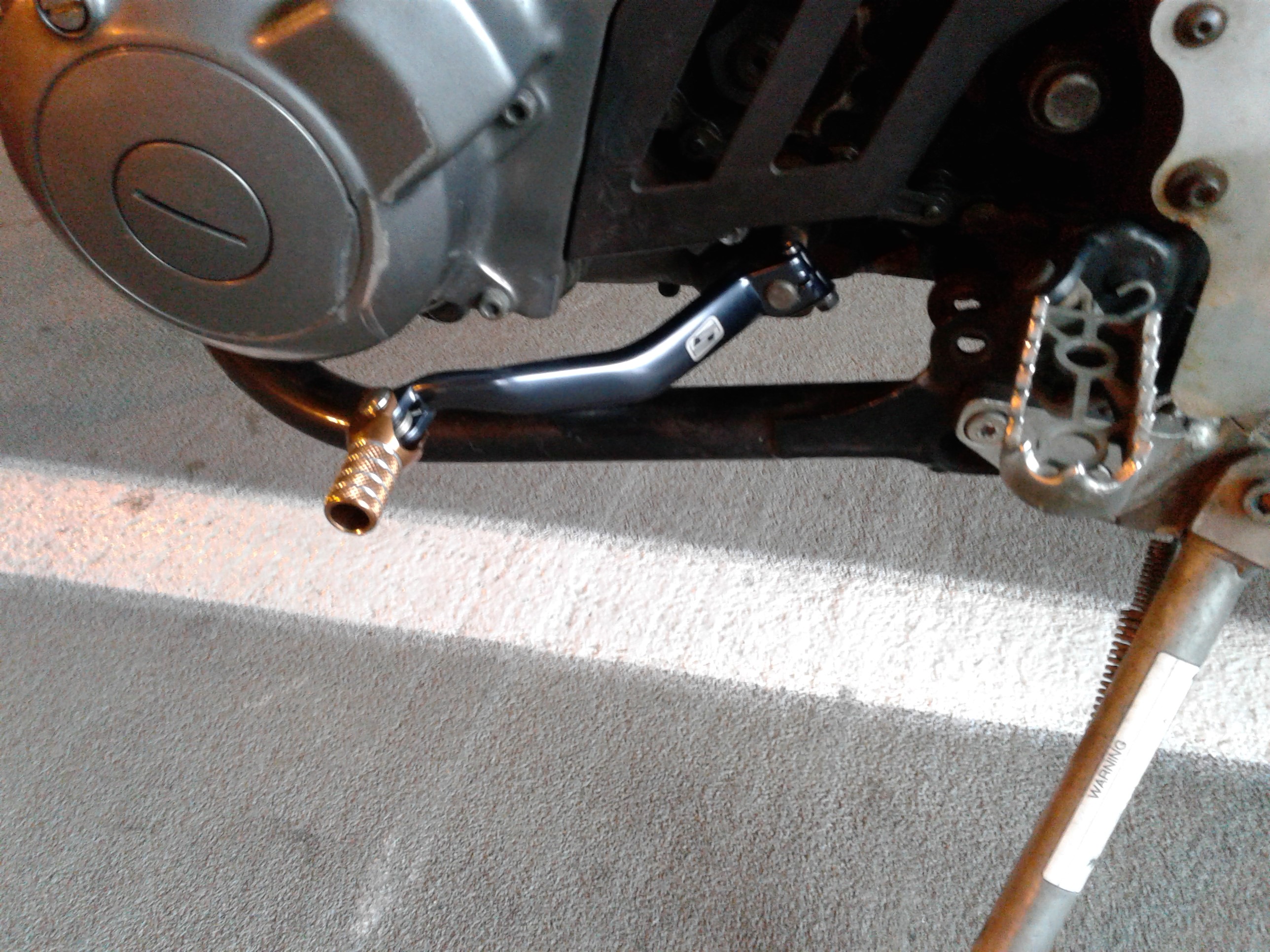

Ok I went a different direction and pulled the linkage and stock shift lever. I went direct to the transmission with this
Sunline Alloy Shift Lever
Color- Alloy, Size- --
SKU#312979
http://www.motorcycle-superstore.com/81 ... hift-lever
I chose the 2001 yamaha YZ250
So far it works like a charm...I'm ordering a spare.
This is my own photo.
The shift pattern is the same . The main difference is there's weight hanging on the transmission spline ( not much level is super light) You also have the possibility of damaging the spline if you jump on the lever or crash. The tip folds up on this lever making it safer. If you ride a dirt bike this feels exactly like that and looks much cleaner. Many raptor riders switch direct levers and I didn't find anything that stopped me from making the switch.

Postby DAVID THOMPSON » Thu Aug 31, 2017 11:54 am
this makes shift pattern backwards ?????
Re: gear lever availibility
Postby breakwellmz » Fri Sep 01, 2017 2:23 am
Nice one SeatleMZ but what model Honda is it?
No it won`t David.
Postby DAVID THOMPSON » Fri Sep 01, 2017 11:35 am
if it goes on a mz traveller
i think it will
the foot peg is farther back
