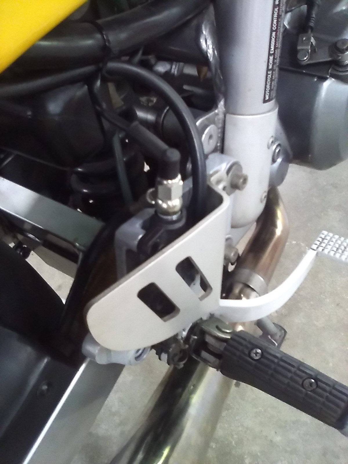

Postby jimc » Sun May 26, 2024 3:56 pm
The banjo switch for the rear brake light decided to cease function. Lots of el cheapo ones available, but I went for the Spiegler in hopes of better quality plus it comes with the 2 crush washers and has a perfect boot. Spiegler Performance parts P/N 20-01011-52. This is an M10x1.0 thread. This does come with 6 inch lead that requires a connector change. bought from Sportbiketrackgear.com.

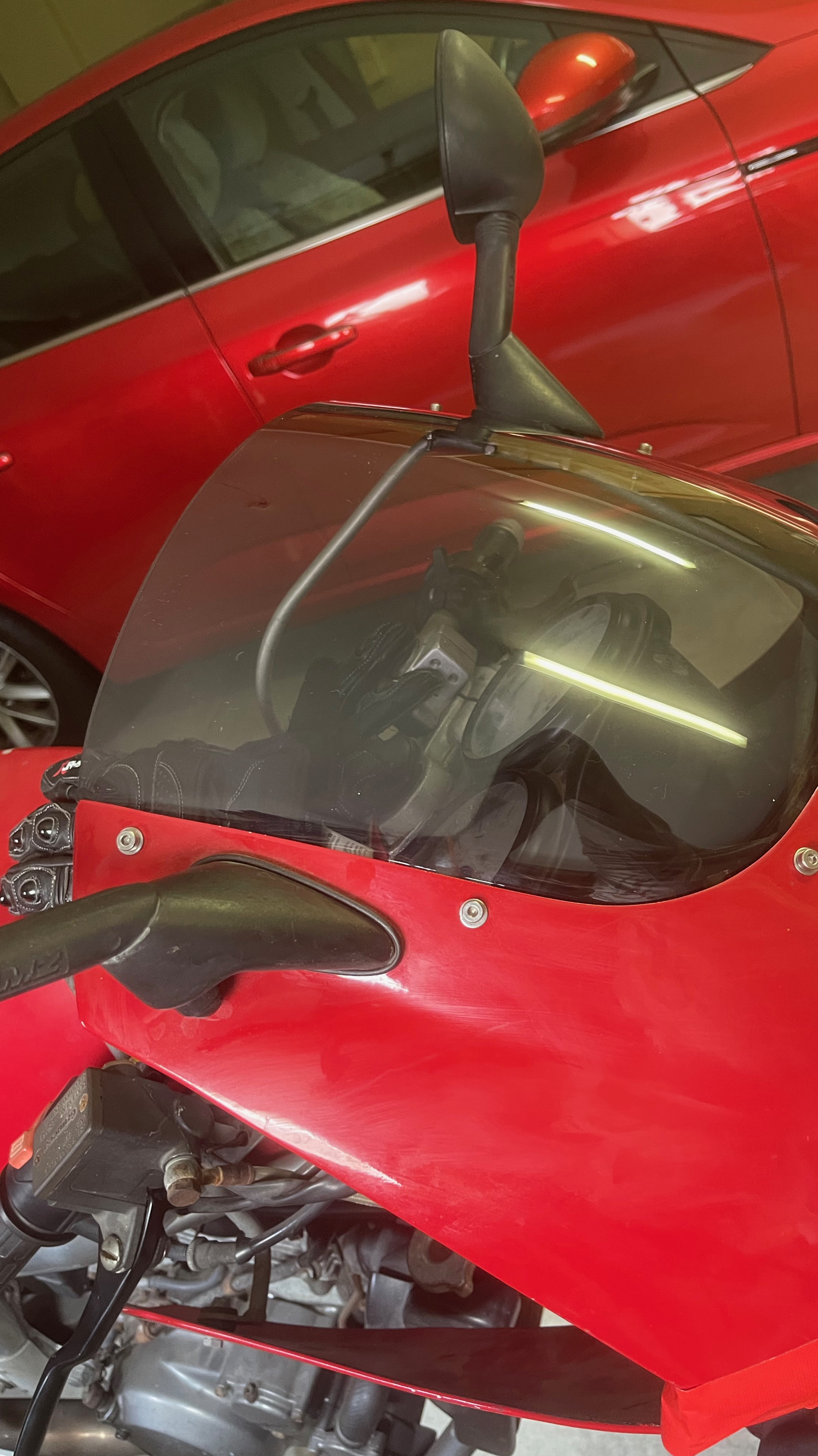

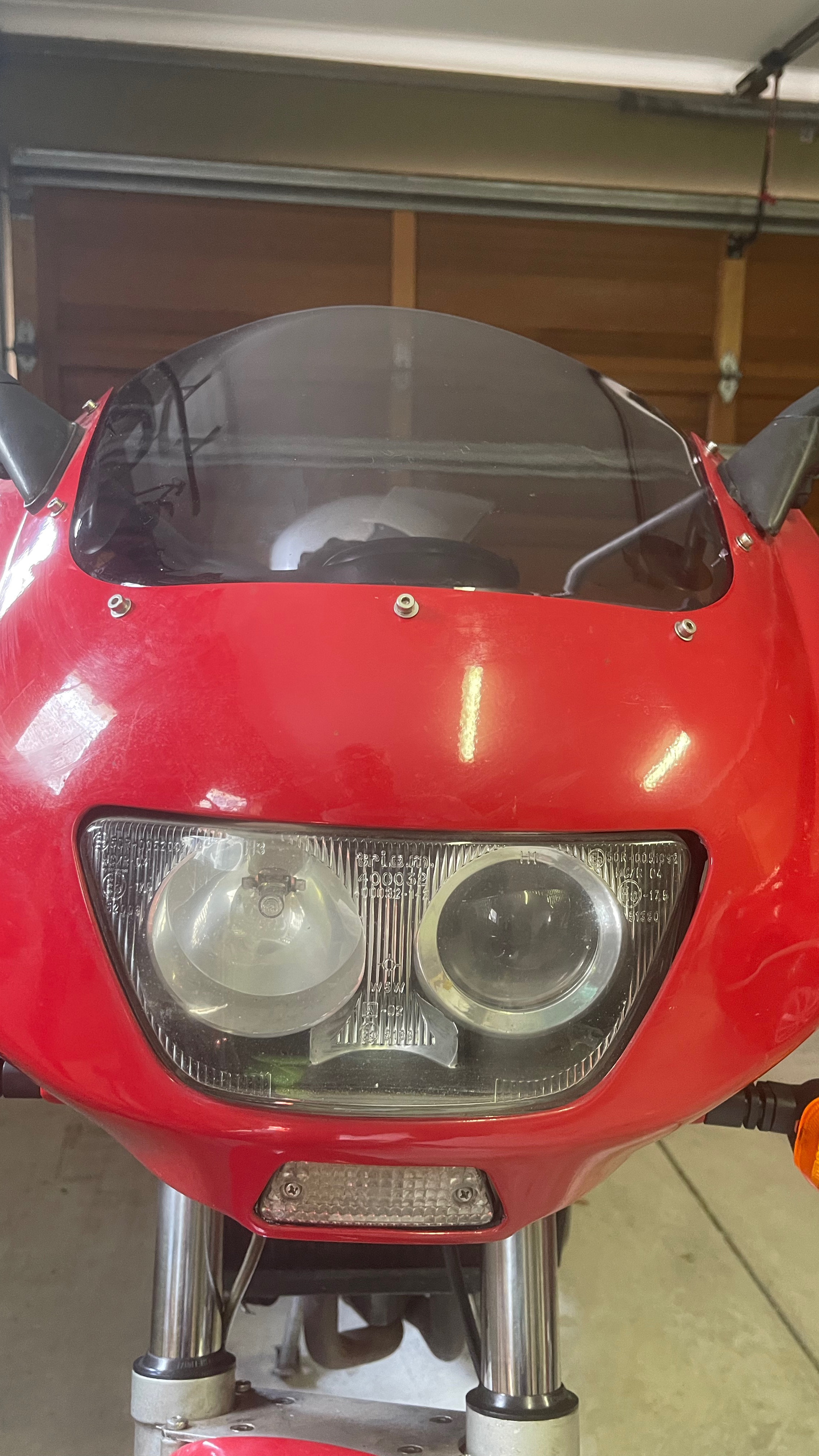

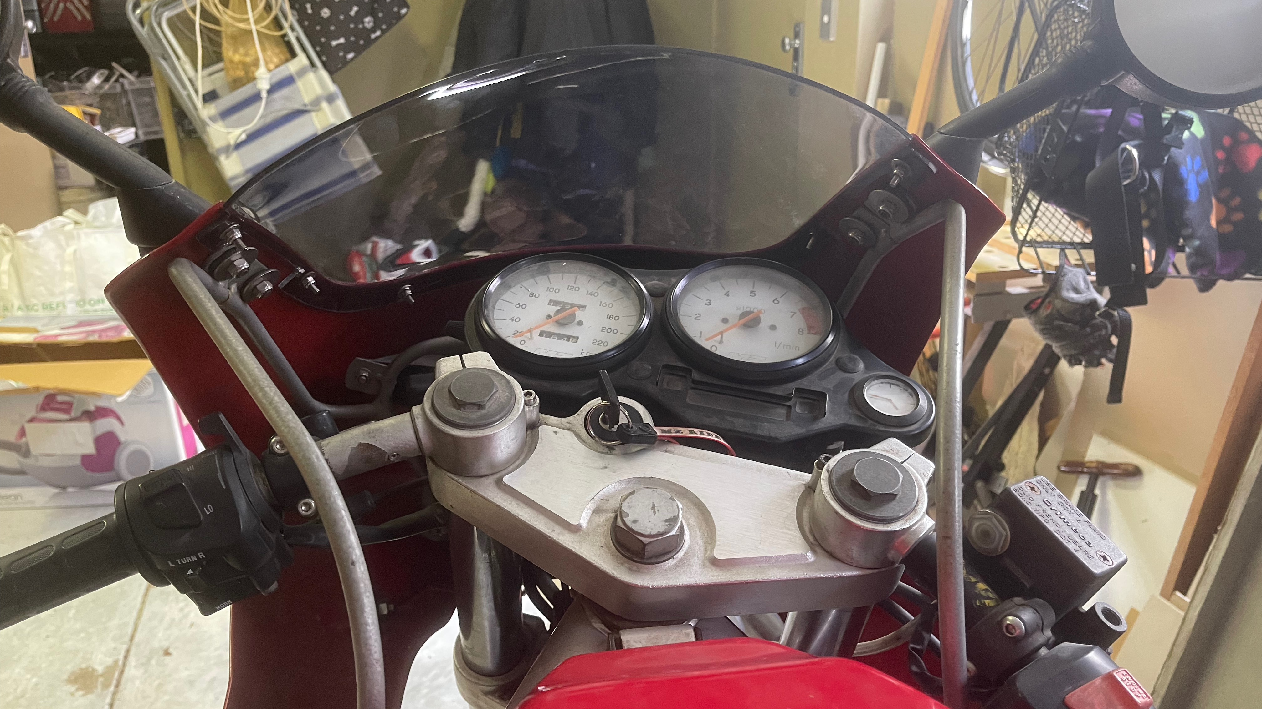

Postby AndyDent » Fri Feb 21, 2025 3:04 am
Ecstatic to say there's a new supplier of replacement Skorpion Sport screens!
Just fitted my newl-made replacement. They made a mould up from the pieces of my original.
https://www.eaglescreens.com.au/?productcats=mz-muz
Now just need to find a fairing shop to do a little crack repair & repaint, here in Perth.
from side so can see curve
Screen from front
Screen in place
