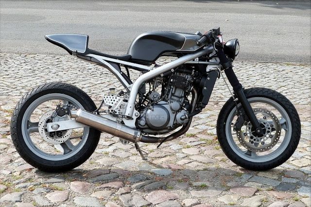

Postby breakwellmz » Wed Apr 01, 2020 3:38 am

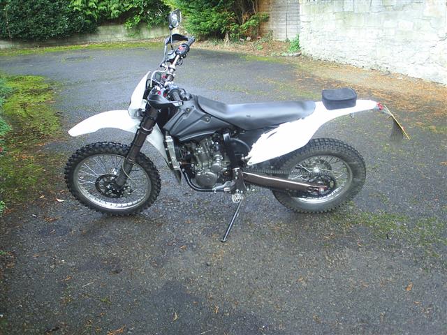

This sort of thing? -

breakwellmz wrote:This sort of thing? -
Kinda that sorta thing, but street legal and less aggressive in its stance. Something to putt around town on mostly, but also a fun project to get my though isolation times.
I already have a lithium battery planned!

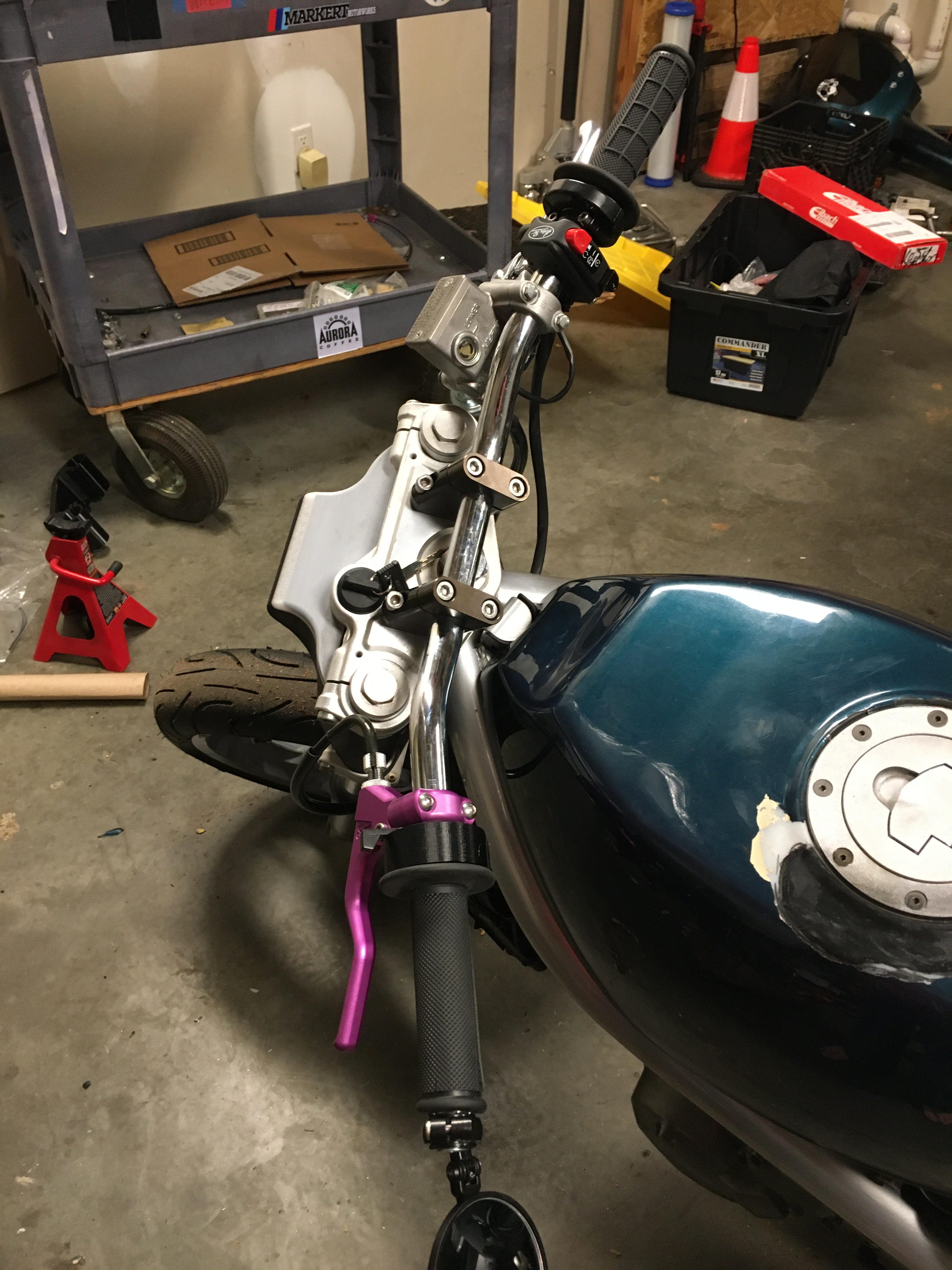

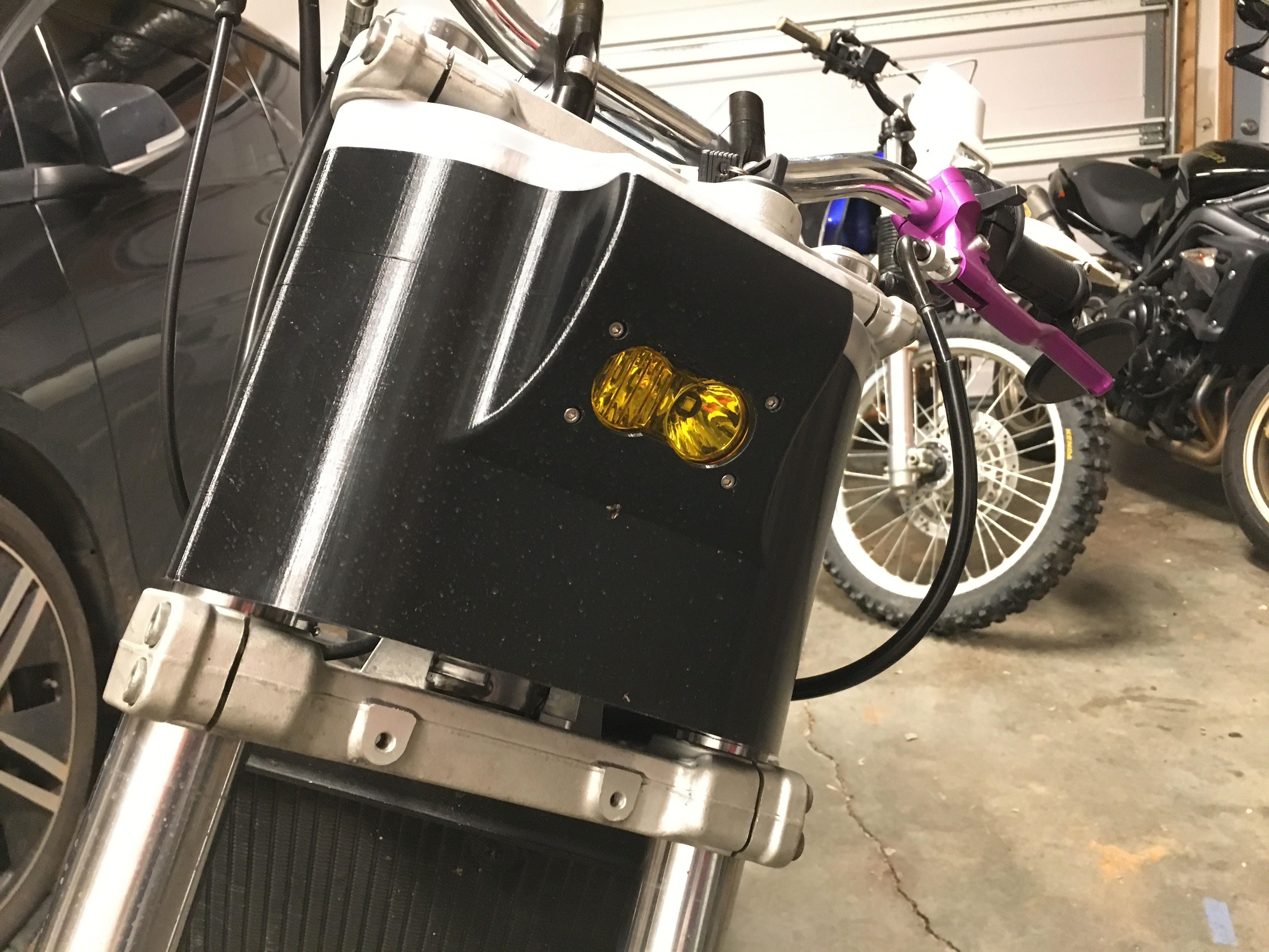

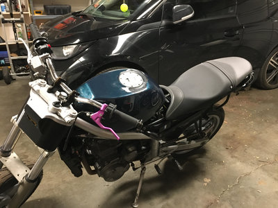

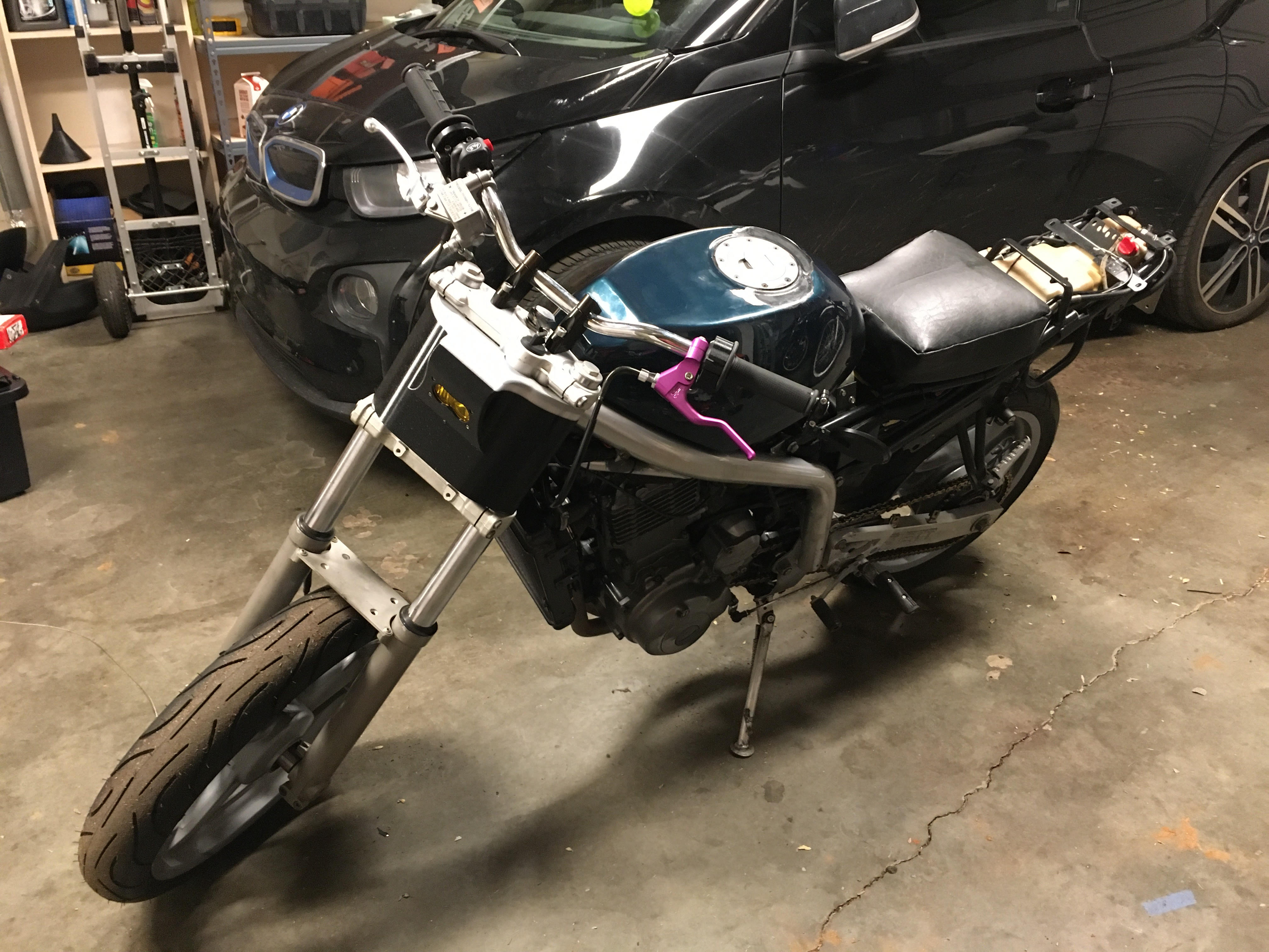

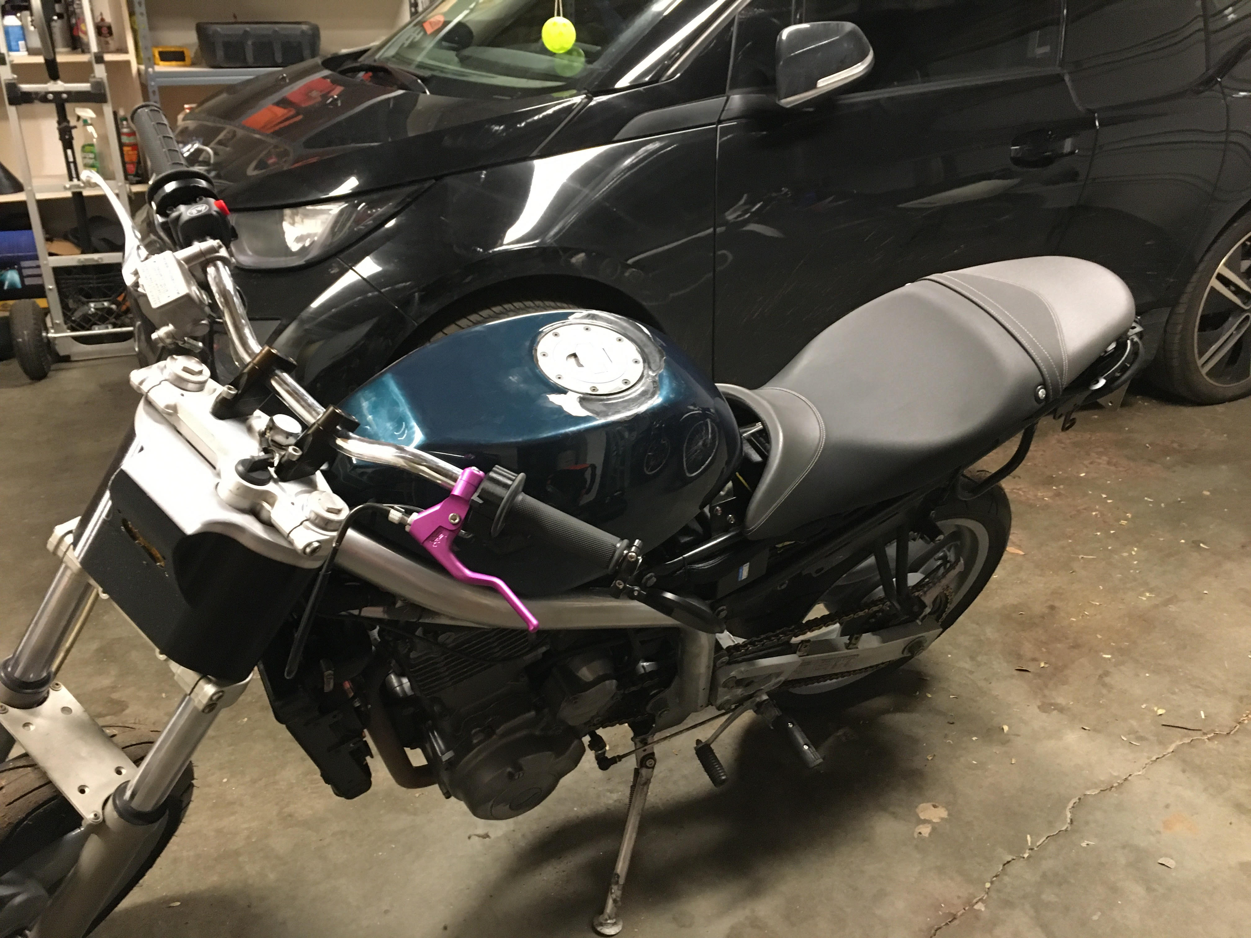

Postby jpmsteadi » Fri Apr 17, 2020 7:46 am
Here are some pictures. As you can tell, it looks REAL ratty right now. My goal was to just get it back on the road ASAP so I can enjoy it while I work out how to make it look as good as it rides, haha
The headlight assembly while printing ran out of black filament and so I used some scraps I had just to finish it and test fit it. I have another all black one printing right now (just under 2 days print time though). I've got the angle of the light worked out and its super low profile and lightweight (only 8 oz)
The handlebars came on the bike, I have some on the way that have a larger pull back to make the seating position a bit more comfy. Thankfully the bike had already been handlebar converted, though the handlebar risers are brown for some reason.... I cleaned up the bars by using a motion pro kill/start switch, a motion pro slim throttle housing, and a 3d printed choke housing. I am borrowing the RSC clutch lever from a friend to see if it works in the low effort setting (it does!). It won't be purple forever, I promise. The key is a Sicas racing lightweight item with a 3d printed part to make it go into the OEM hole.
jpmsteadi
Posts: 127
Re: Skorpion 660 Lightweight Build
Postby jpmsteadi » Fri Apr 17, 2020 7:51 am

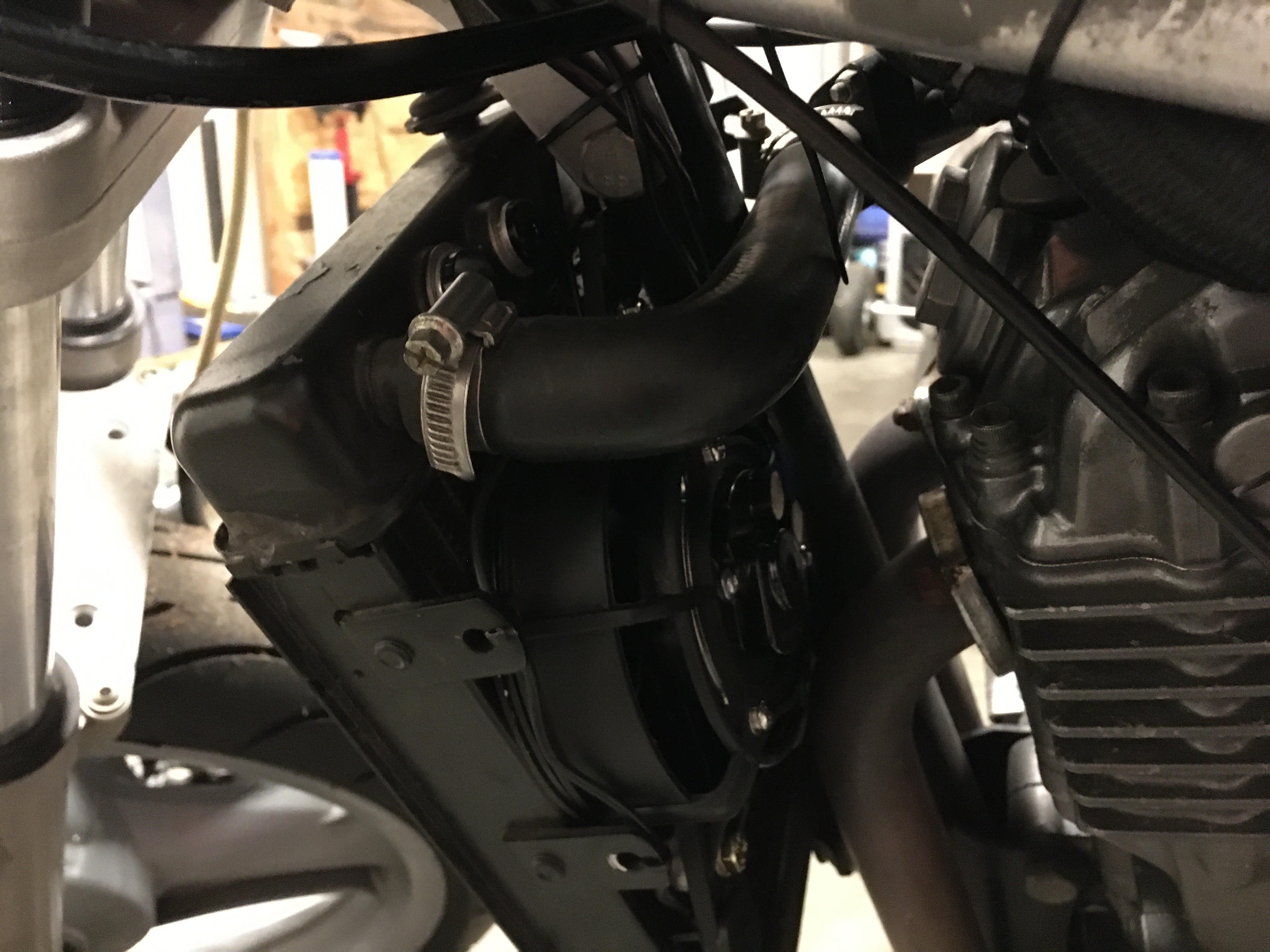

The radiator lost both of the fans and coolant temp sensors (as the fans didn't work, they were unplugged when I took apart the wiring harness. Plus the plugs were quite heavy). The two holes in the radiator got aluminum plugs and a tusk fan unit was installed. At some point I will probably do a 3d printed bracket for the fan to get rid of the metal parts, but for now it works.
The stock seat is pretty awful, so I added some foam and recovered it, but as you can tell from a previous picture, upholstery is not my gift. The bike is ridable again and much more comfortable, but I want a better looking solution. I just sat the street triple seat on the bike to take a look and it matches fairly well. In reality I think I'd love to just go with the stock skorpion long seat that exists on the tour, not the sport, but I can't find one of those anywhere. I am VERY open to suggestions on this; it is for sure the part of the build I am least happy with at the moment.
Postby Puffs » Sat Apr 18, 2020 5:15 am
Thanks for those pics!
Yes, surely a modern sportsbike like the street triple has the ratio of the gears closer, and consequently a much taller 1st. The XTZ660 was by origin a trails bike, which had wider gear ratios to cope with difficult circumstances. Close-ratio gearbox vs wide-ratio, and I suppose MZ took the engine un-modified. And of course the triples (both 675 & 765) are substantially more powerful than the single.
The miracles of 3d printing!
I'd put a F mudguard, without it, 1 wet patch and your visor is dirty. It might also be a legal obligation.
Radiator fans: are you sure you wan to have those off?
For making a good seat you need stiff (closed cell) foam, and properly shaped, and that's a problem. If you have suitable foam, maybe shaping it with a steel brush fitted in a stationary drill might work? Or use thin layers?
A bathroom scale, first F then R, should be OK, but for accuracy you should lift the other wheel by the same amount as the scale does, so that the bike is horizontal. Piece of wood, tile, ...
On your weight savings, 33lbs is a good start, but at 154kg dry it is still not spectacularly light (for the 58HP/58Nm engine).

I may have not been clear: I took off the disconnected (not by me, some previous owner had disconnected them from the wiring harness) stock fans and replaced it with an aftermarket temp variable fan with controller. Lighter than stock and more peace of mind. It seems this bike runs VERY cool too.

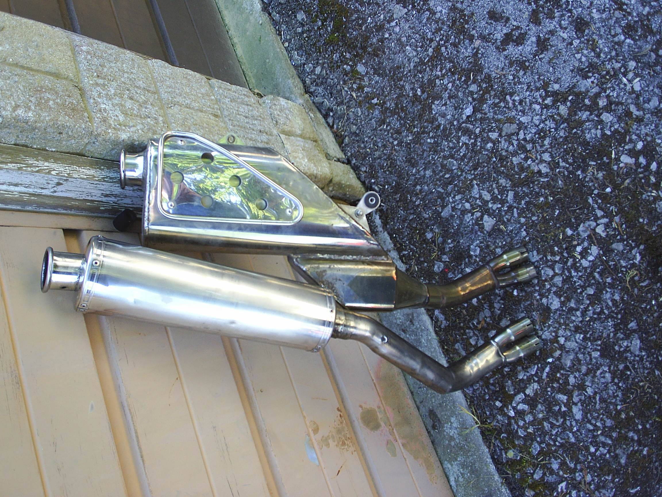

Postby breakwellmz » Mon Apr 20, 2020 2:28 pm
Talking of weight reduction, i took the standard Mastiff exhaust off today.... What a lump! 14 pounds! What will replace it is 6 pounds, and that is still a stainless system.
