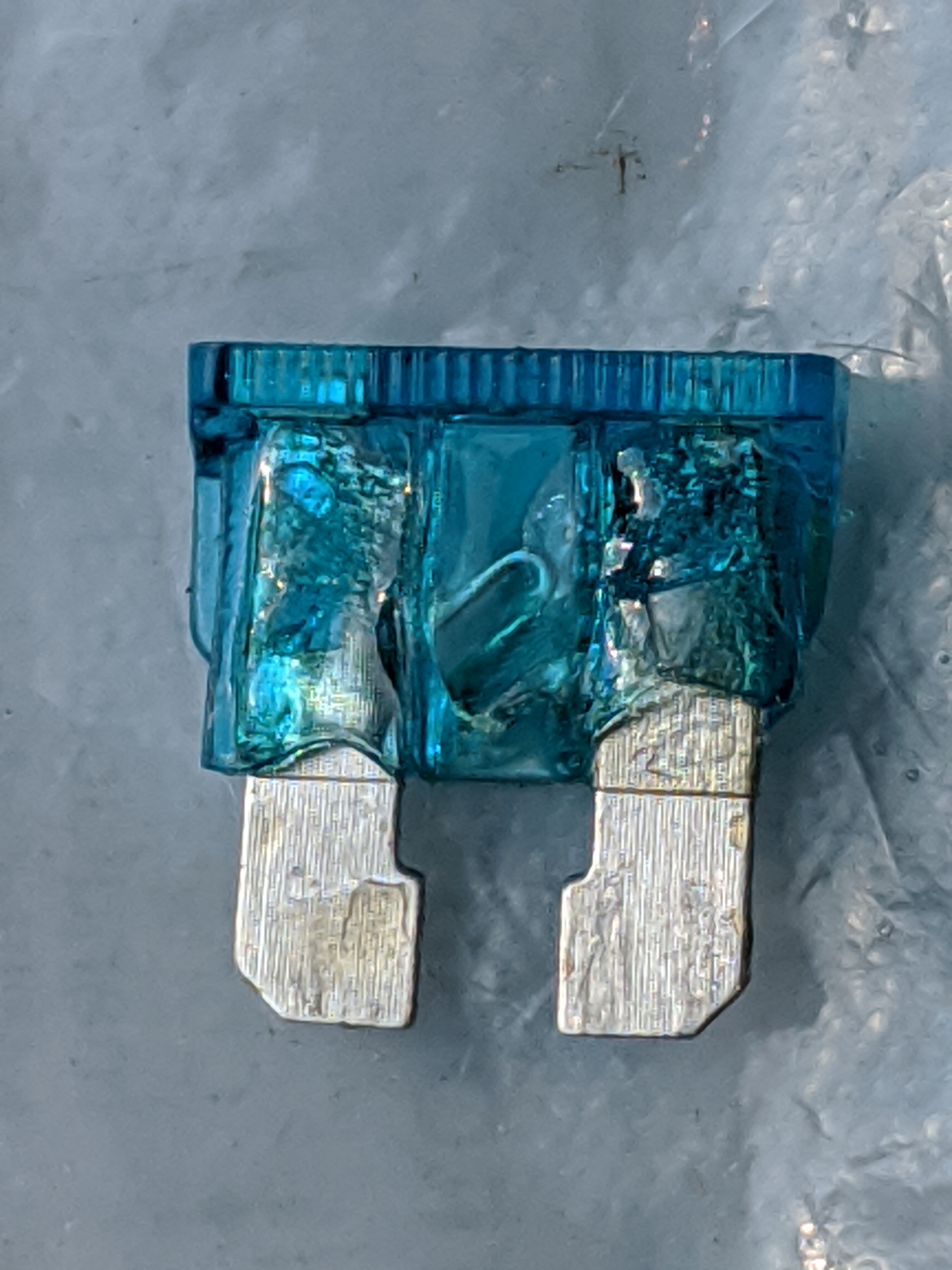

- (somewhere in this sequence of events, the 15 A fuse got melted (but fuse wire not broken) during one of the tests...
Pic:
Fuse wire is intact, but housing is somewhat melted

Except for that "melted" 15A, which had been replaced, all the three fuses (3, 7.5, 15A) were fine as well.

The plastic molten on your fuse might be caused by poor contact, giving resistivity at that contact which may, on the longer term, heat the fuse up. Poor contact causes resistivity and drop of voltage, when a current flows through it. See https://en.wikipedia.org/wiki/Ohm%27s_law on resistivity and on electrical power I²R see https://en.wikipedia.org/wiki/Power_(physics) or https://en.wikipedia.org/wiki/Watt.

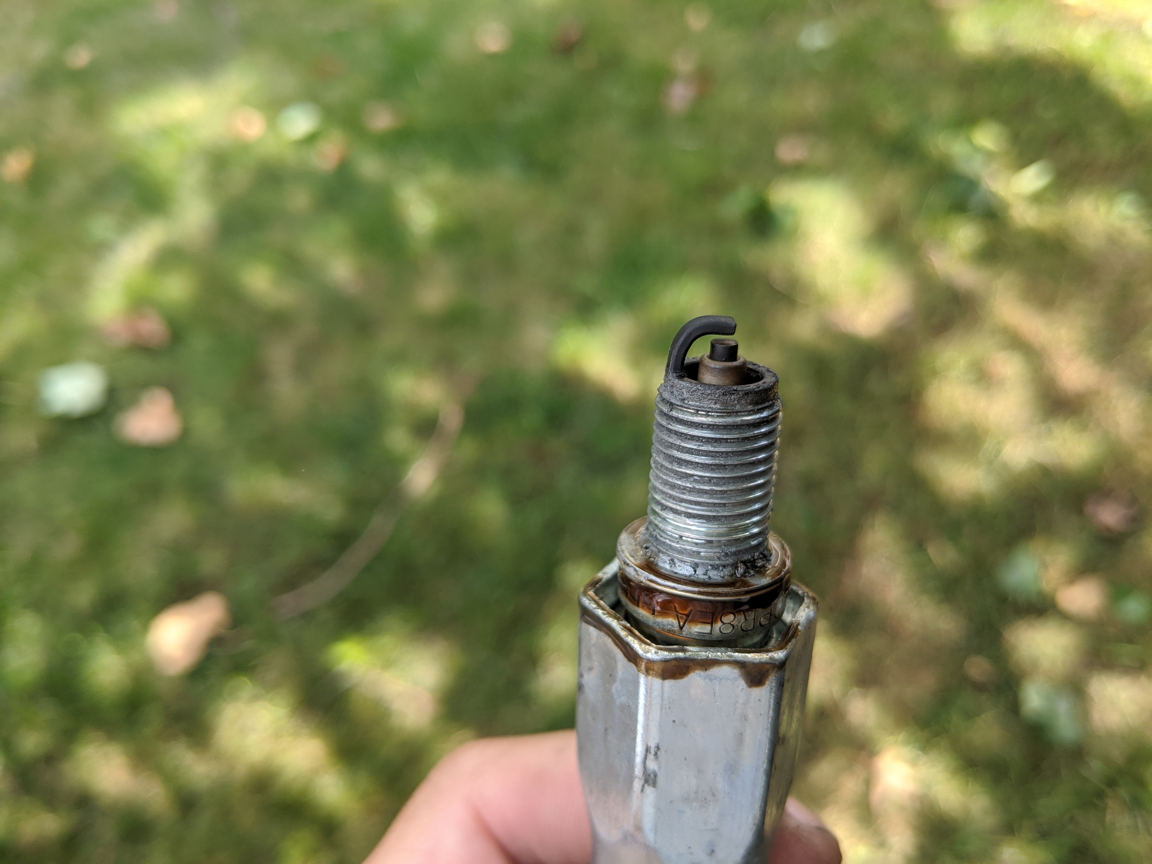

In any case... Yesterday, I try to check all the relays and the coil that @David mentioned. Everything I found was clean and lugs well connected.
Then I took out the spark plugs for inspection. it was quite clean, and the gap was good, though some oil on the threads:
So I wipe off the oil, and reinstalled the spark plug.
I thought what the heck, I'll try starting the bike. And guess what, it fired up and got started. Unlike in previous trials, when it might start but would die in secs, this time the engine just kept going as if normal. And I just took a test ride for a few minutes and it felt ok (more on this in the next msg).
Could that be it???
For the entire time, I'd thought that it was an electrical problem (recall that I'd installed a 5 Amp horn) that had somehow affected the ignition system. All indicators of the problem seemed to have pointed to a electrical issue, or so I'd thought: Engine losing power and eventually dying ; inability to turn the engine ; the sound of the engine being cranked over was that of a weak battery (or weak electricity transmission) ; a good battery was able to start the bike, but a less good one could not ; the engine would fizzle out and die after starting...
Could it actually be a spark plug / combustion issue ? I am glad I got the bike started (I still need to give it a good 10 mile run to be sure), but I don't understand it.
Any thoughts to help me understand this mystery?

Postby Puffs » Mon Jul 13, 2020 4:08 am
I see, you hooked up another battery via jump cables and then measured on the bike end of the jump cables. Yes, that explains the quickly varying voltage very well: it is due to losses over that jump start cable and it's connections.
When checking all the connections (and finding everything fine), you probably touched & moved some connection, thereby fixing an issue? The bike has done less than 5k miles, so it has been standing for a while. That mileage makes it very desirable...
Oil on the threads of the plug is not the cause. I often put some copper slip there, on these small plugs.
Good it now keeps running, but we may never be certain of the cause. One possibility is that the valves were too tight, particularly the exhaust. And then when it ran for a few seconds, that exhaust valve heated up (as they do), hence the stem expanded and the valve stopped closing properly. Then you loose compression and the thing stalls. (And if you were continue to ride it you might burn the valves and/or seats.) I suggested 'valves too tight' earlier because of the total absence of any valve noise in your earlier video. It is common to hear a bit of valve noise in a big single.
I suspect the bike has not been used for many years, 4.7k miles in 24 years is not what you would call 'intense use'. I don't know, maybe something was stuck? I think too that it's the valves you hear in your 2nd video. So whatever it was, it has now become unstuck.
Check the valves, do a full service. Then ride & enjoy the bike.
