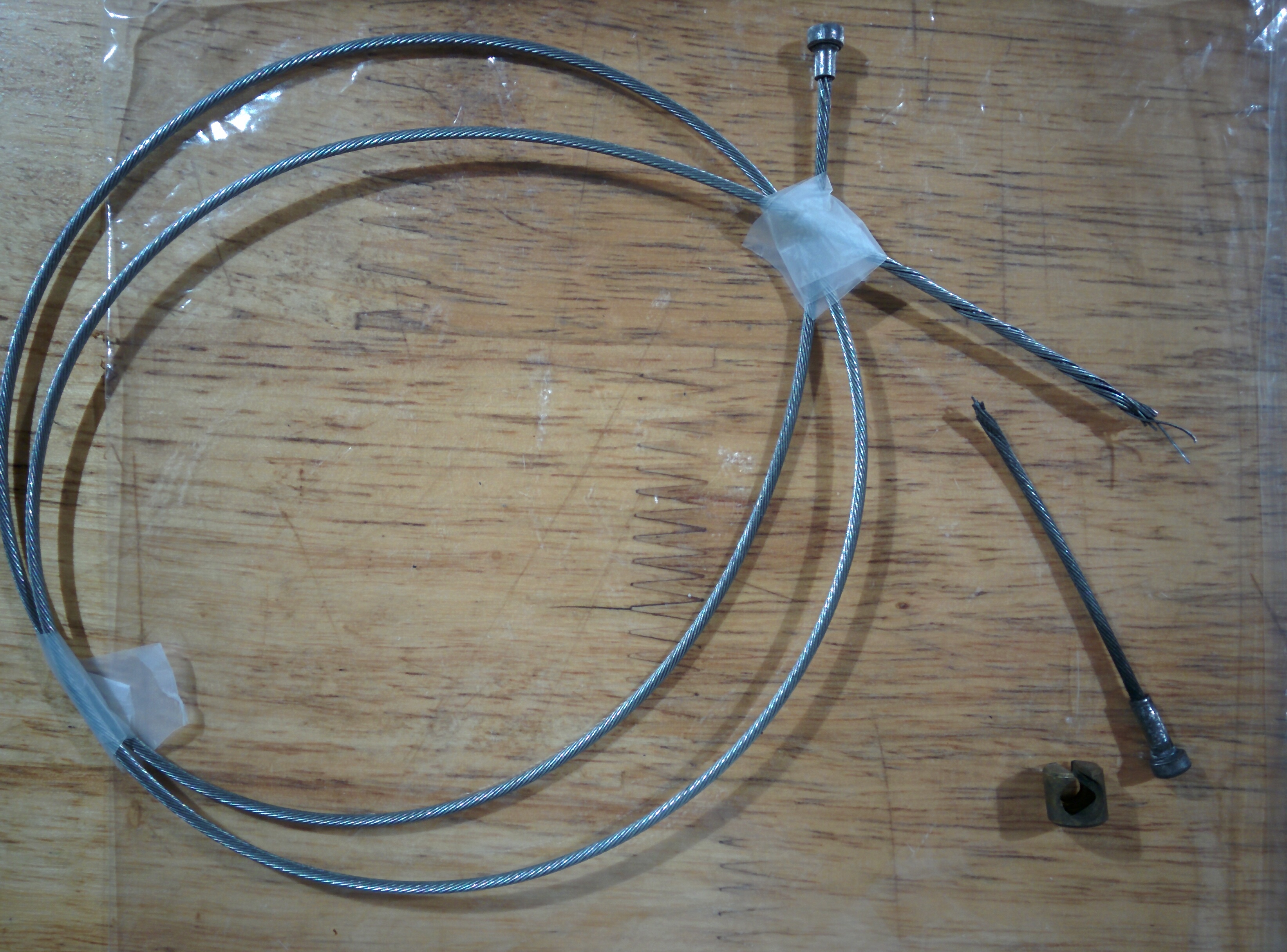

The clutch cable snapped while I was commuting home from work yesterday. Ended up getting stranded in the middle of Manhattan -- on Park Ave, no less! -- for like 5 hours waiting for the tow truck to come. I know, I know, that the bike still works without the clutch. I had tried, but it just seemed too dangerous and much of an obstruction of traffic in the big city.

The same thing happened to me on a 2002 Baghira with about 12000 miles. I used a replacement cable for a Yamaha 660 four wheeler. I do not remember which one. But I would recommend periodic replacement of the cable as a part of maintenance. When I examined the cable, it just pulled out, no damage. Would also carry that cable as a back-up on a long road trip.

Well, I'll be. Mine broke a few weeks prior. Still haven't gotten it fixed. I'm leery about getting the wrong item, because I suck at making product returns in a timely manner. My cable frayed and broke, almost flush with the ferule on lever end. My reading tells me this is almost completely preventable with proper and timely cable lubrication.

Any cable will wear out eventually. Mine broke right at the clutch perch, but not due to a lack of lubrication, it was rubbing part of the perch. My experience shows that lubricating cables only attracts dirt and shortens their lifespan. Use only dry lubricants, like Dri Slide, or nothing at all. ;)
