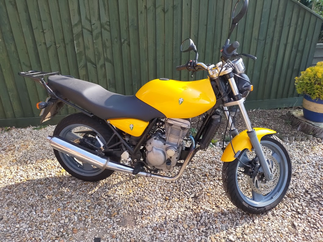

As an experiment we bought a Chinese DC cdi from eBay costing a whopping £9. If we had more patience we could have bought the same thing from China for about £6 - postage paid in both cases. We also had to buy the special connectors to the cdi to make a neater job another £3. And it works!. The cdi is adjustable for duration of advance and we had to reduce this to the minimum. Bike now starts easily and a short test run was done without issue. The only downside to this conversion is that the cdi does not provide a driver circuit for the tacho but this is a minor issue. No changes were needed to the bike's wiring and a genuine cdi could be plugged straight in. When I have sorted out a minor and unrelated electrical problem with the rear brake light switch, I will ride it to the MoT station as a longer road test. The bike itself is now being offered for sale if anyone is interested - see picture below.

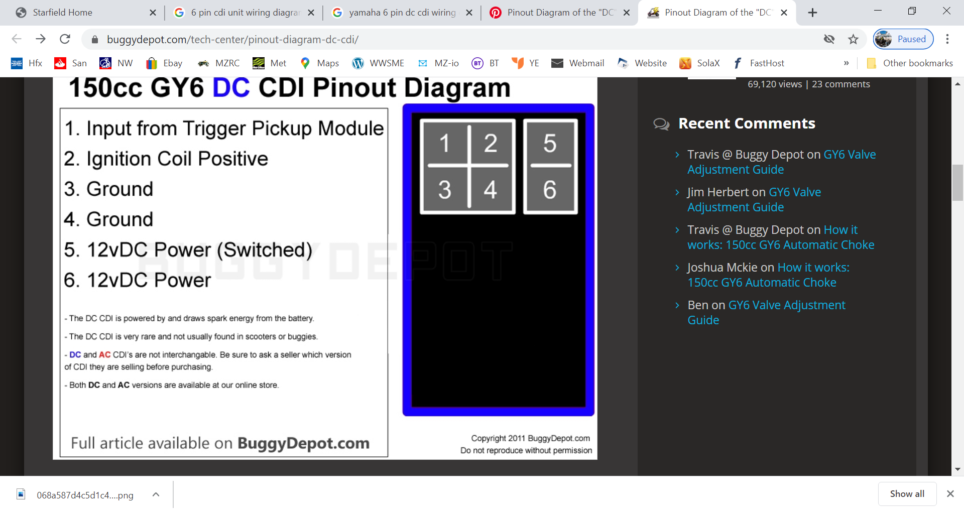

I have attached a picture of the cdi unit we fitted and another which shows the pin-outs. The MZ pickup has two wires and the Chinese cdi only requires one from the pickup so the black cable was connected to ground.
