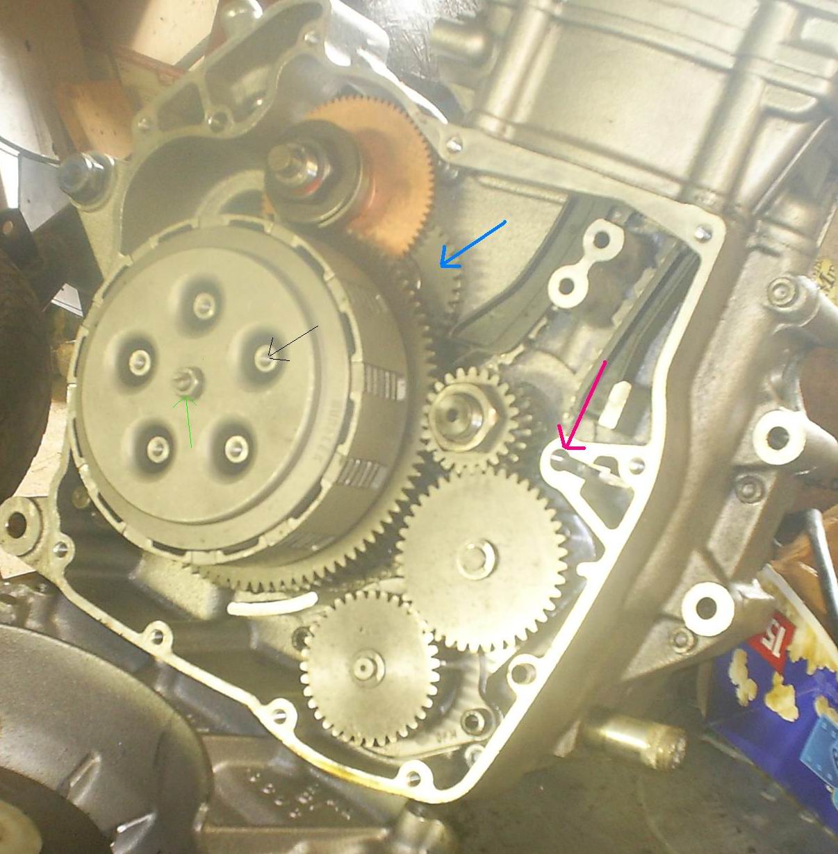

there is an adjustment on the cable and an adjustment on the basket in side
green arrow = adjustment
black arrow = clutch springs not in picture
RED ARROW oil pressure spring and ball bearing do not loose
make sure its in there
make sure you use a good side cover gasket as its thickness effects oil pressurw spring
i remove battery and lay bike on its side ----saves hunting for oil ball and spring.....
i would replace the whole set
blue = the location of the famous freewheel drum
the copper thing in front is a 2 way slip clutch it gets galled and does not slip when it should --breaking the freewheel
book says not field adjustable but i did after breaking 3 freewheel drums
details on adjustment on request
right side mz125
125right side514.JPG (164.26 KiB) Viewed 11694 times
