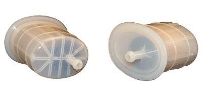

look at a wix fuel filter number 33067 its big and will work as a sediment bowl and keep water out of carb
but it is big on these bikes i think the plastic tanks make water from the humid air as temp changes
my traveller seems to be full of water all the time

i have the big wix filter on the 660 traveller need to get one for the rt
this filter is BIG left is input right is out

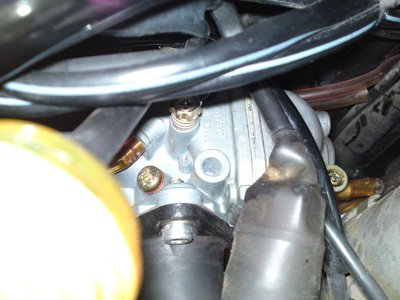

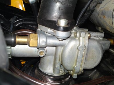

also, i wondered if i should just buy a replacement carburetor so i searched for MIKUNI VM24 as stated in the manual, but everything i find looks very much different from what i have on the bike.
this is what i find easily:
this is what i have:
from mz-faber, i gather that the part number is actually Mikuni VM24/499
i found Mikuni VM24/489 but that STILL looks different.
Dave, what experience do you have with the carb from RT ? do you know if its interchangeable with anything else i can get states side?
is the part the mechanic talking about really prone to etching and needing replacement?

hey dave, got the filter today. it actually looks bigger in pictures than in real life. length wise its actually a tad shorter than the stock, but definitely thicker.
the nozzles are surprisingly narrow though. i'll have to replace the hoses i have with something much smaller to be able to tighten the clamps around these.
