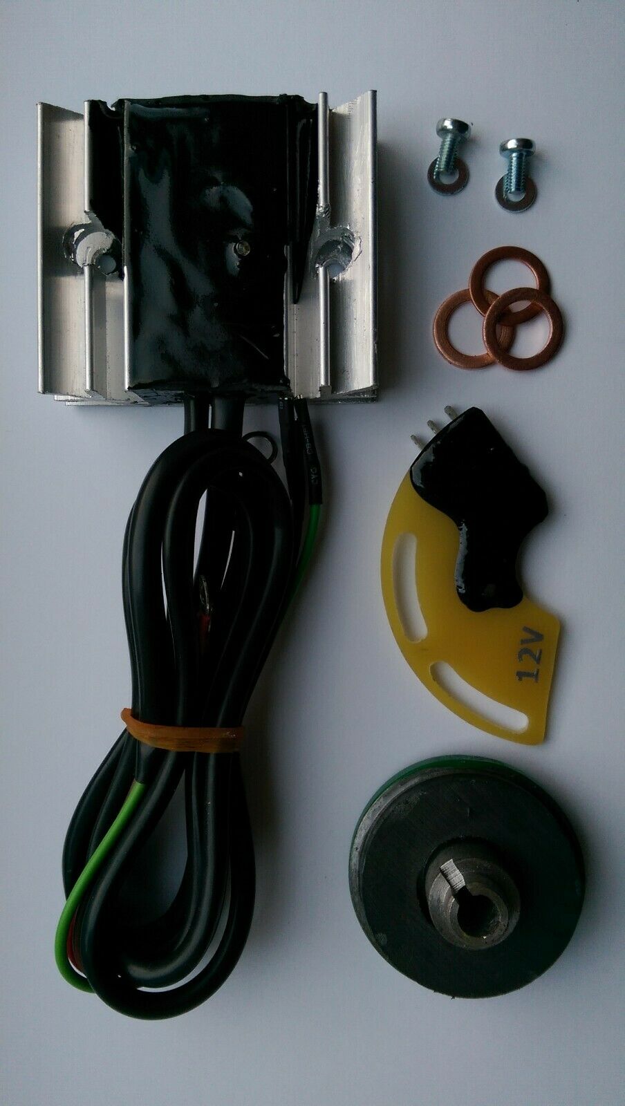

Hi got a kit ready to put on my ETZ 250.

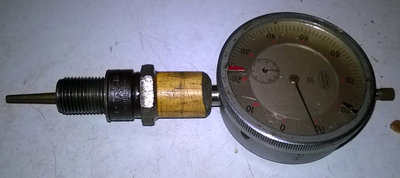

Looking for a dial gauge any recommendations please

Buy what you like/can afford. Setting ignition requires no special accuracy, for that any will do.
For fixing the gauge in the head, I set it in an old spark plug from which the ceramic internals were removed & replaced by some wood. Before I inherited that dial gauge, I just used a calliper.

Postby akirasan » Tue Feb 18, 2020 3:33 am
eBay item number:
233478873087
for the ignition £65
and got the dial gauge from burwins £16
very easy instructions fitted the wire through the loom hole on the engine so tidy and will not
be cut by the chain.
disconnect green wire from points and remove points and condenser.
fit new ignition plate where the points were and connect coloured coded wires.
remove green wire from coil and connect new wires .
get the correct tdc and move the new timing plate and a light comes on the unit when it sparks.
So easy with the dial gauge and it started 2nd kick as usual.
while my points were still like new decided to fit the new ignition to save working on the bike

Anyway, for completeness my dial gauge fixation:
Dial gauge in modified plug.jpg (18.85 KiB) Viewed 19934 times
I actually rarely set (or check) the timing, if you get the gap between the points right, the timing is right too. Just a bit of sandpaper to clean them is often enough.
