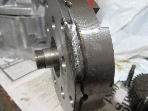

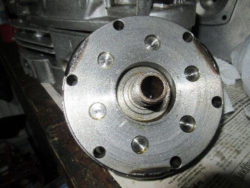

Postby mick » Thu Dec 08, 2022 4:01 am
Hi Folks.
I have a decision to make concerning the clutch on this engine as it has been modified by welding the clutch body to the toothed rim for the clutch, and
then the whole thing has then been faced off in the lathe to bring down any weld above the clutch body so the pressure plat sits flat. Does anybody see an advantage in doing this?
I see you can buy new old stock toothed rims can be bought but I cannot find any clutch body's online. I would also say that the balance would be affected to a degree.

Postby Blurredman » Thu Dec 08, 2022 4:06 am
Hi,
I have seen these welded clutches several times. I do believe they have been done by the factory on particularly the TS's - Not sure why some TS's have and some do not. After all my much earlier Trophy has the face detachable. You may or may not notice the missing nuts and bolts (and indeed holes!) that would otherwise attach the clutch face to the splined section like below...
I wonder if they just tried to experiment but then decided that it was easier for the consumer just to have the front face come off for replacement if necessary as opposed to having to replace the splined section as well and decided against the weld idea.
