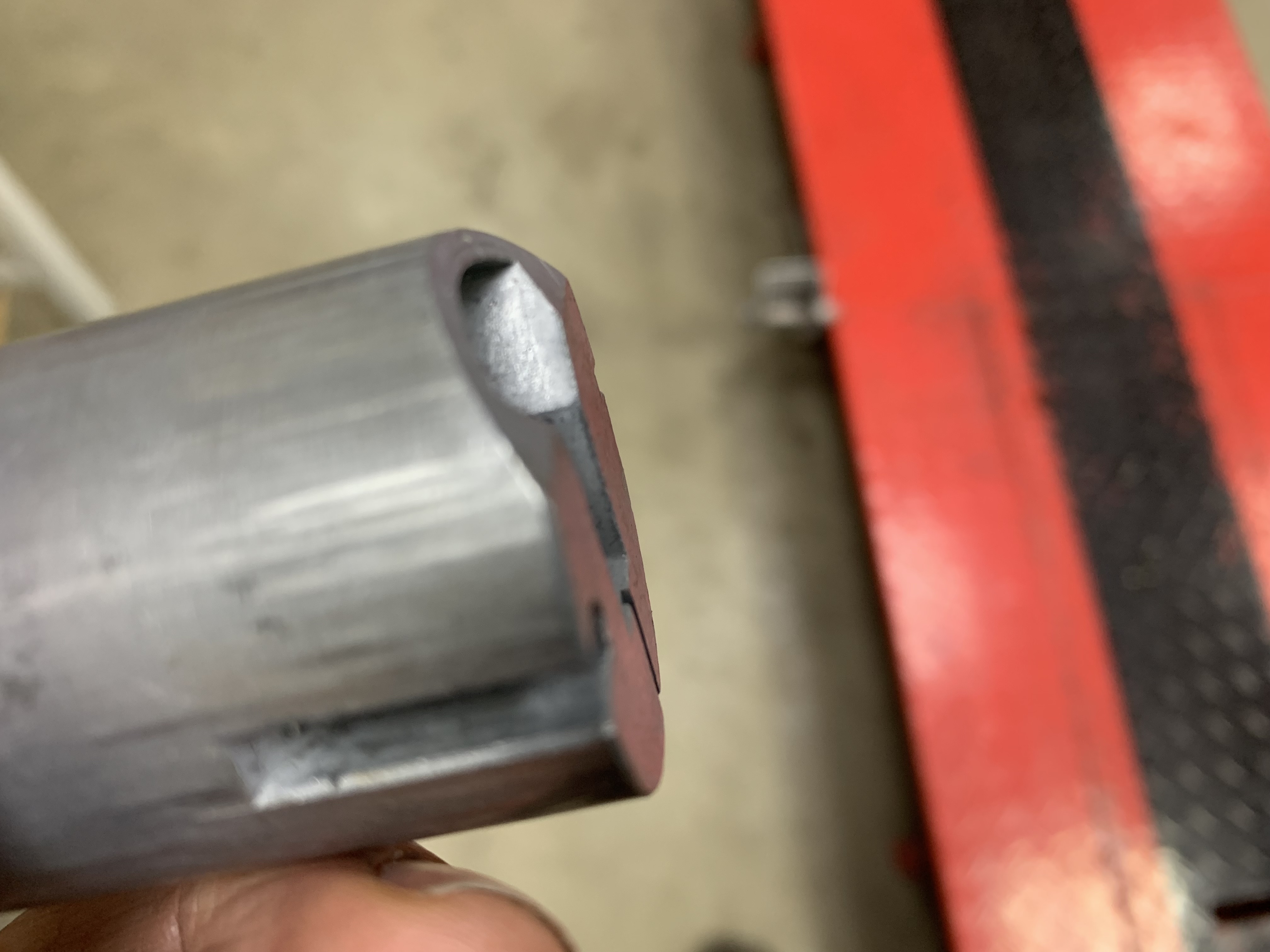

Postby TS250-1 » Mon Mar 13, 2023 9:54 am
Thanks very much for all that info and images.
My slide looks very different to yours as you see. Also, the depth of the chamfer on the base is 5mm. This is when measured in the same way you have in your image.
Does my slide look familiar at all?
Apologies for the multiple picture postings. I couldn't see how to load more than one at a time.
Pete.

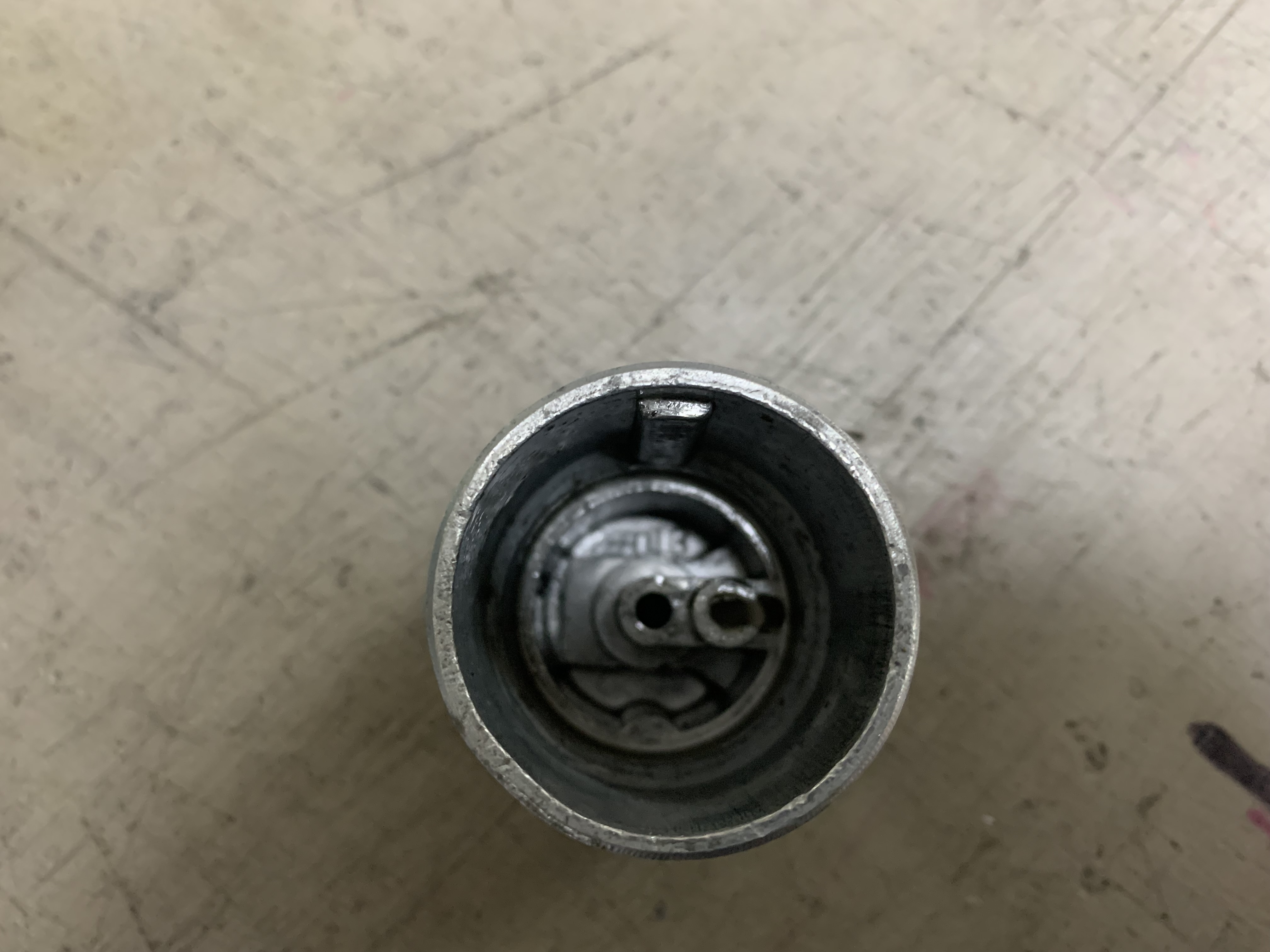

Postby TS250-1 » Mon Mar 13, 2023 9:55 am

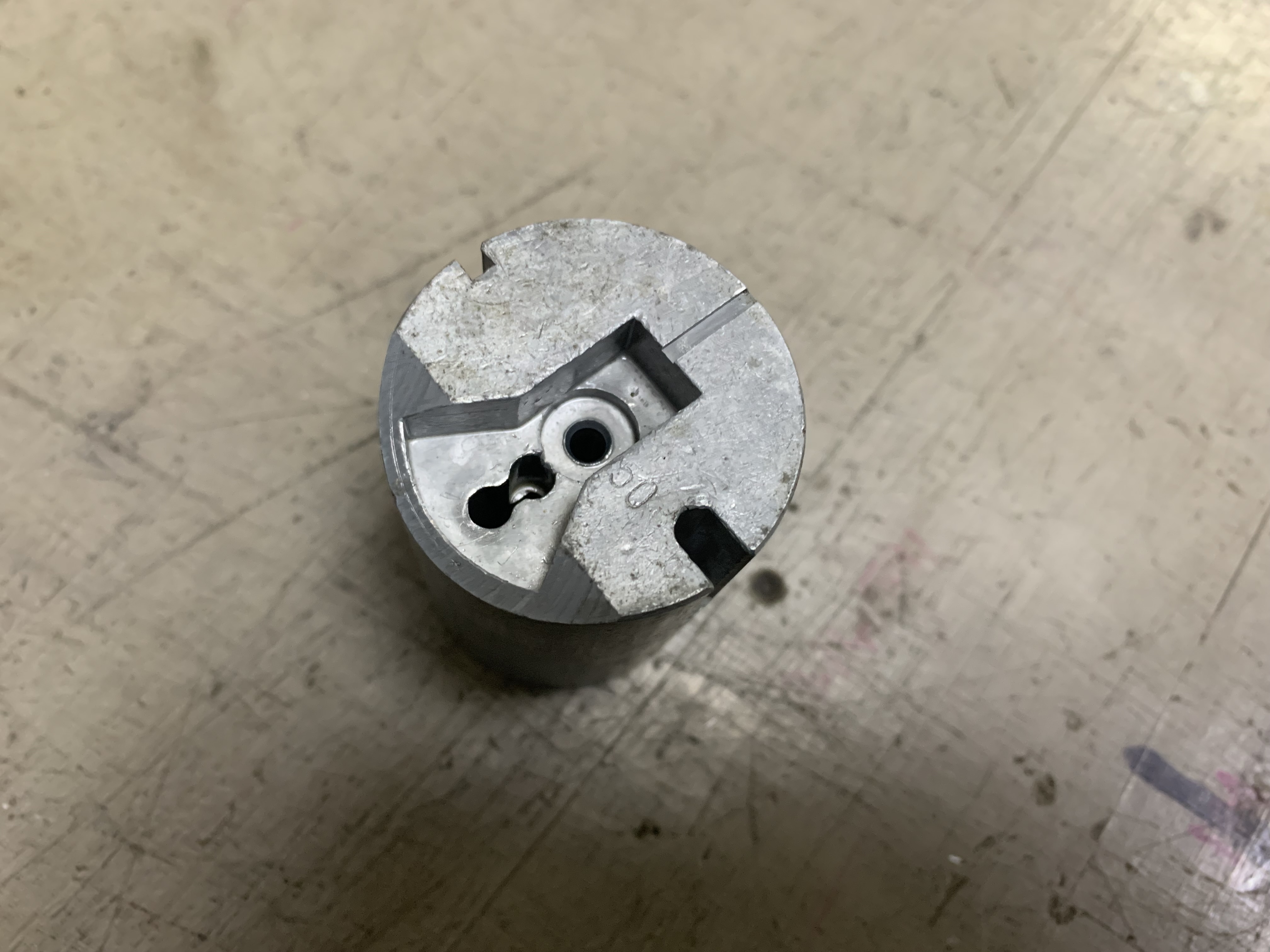

Postby TS250-1 » Mon Mar 13, 2023 9:56 am
