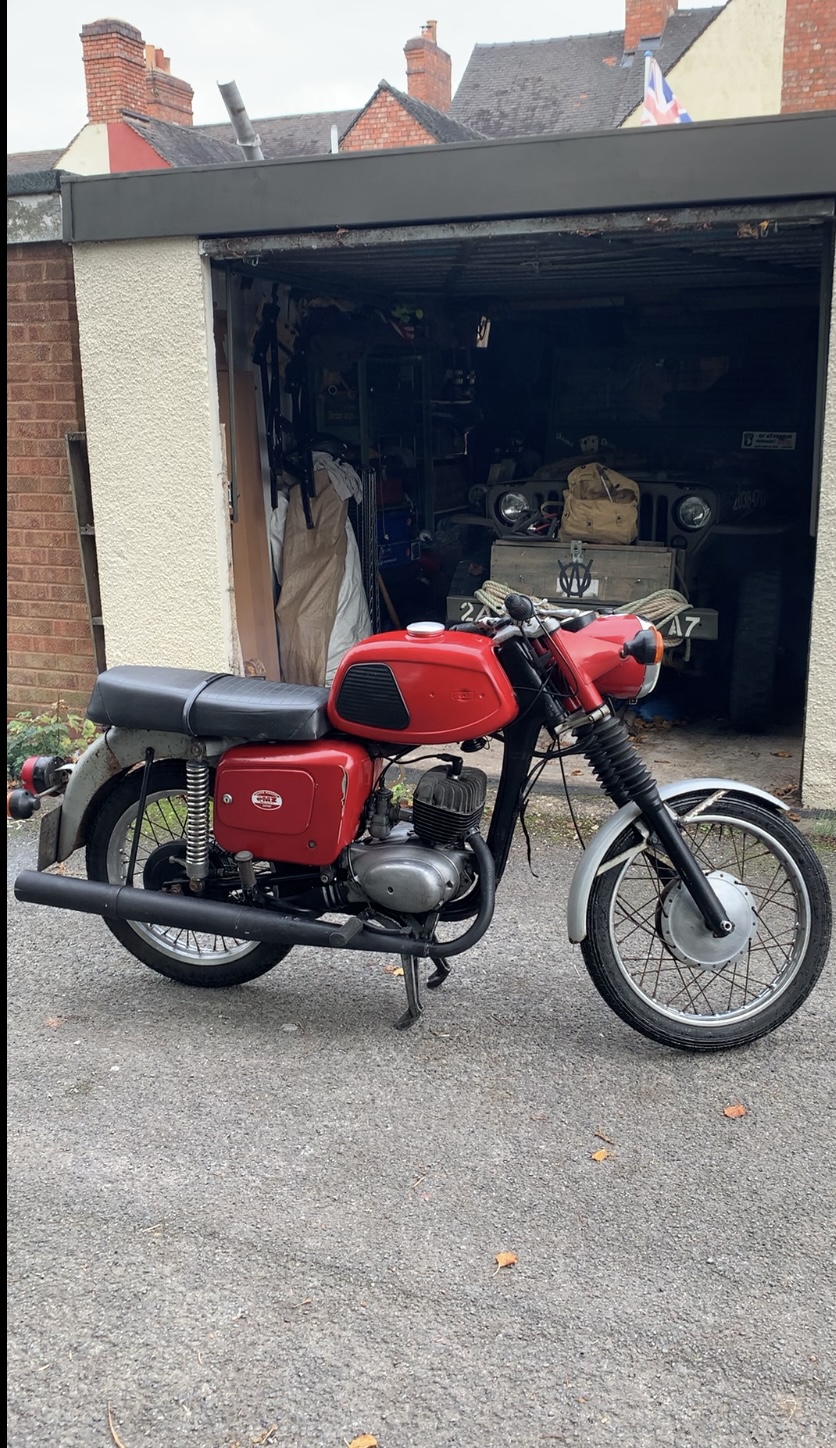

Postby AndyP66 » Wed Nov 24, 2021 7:50 am
Here is a picture of the bike. Overall in very good condition.
Thanks for all the advise lads. I haven’t changed the gearbox oil since I brought the bike so I will do that first. Then I will clean the exhaust which as you can see is in good condition.then I will look at the tank.

Postby Blurredman » Wed Nov 24, 2021 7:51 am
That looks in fine condition! It even has a Honda front brake drum (probably the whole wheel TBH).
