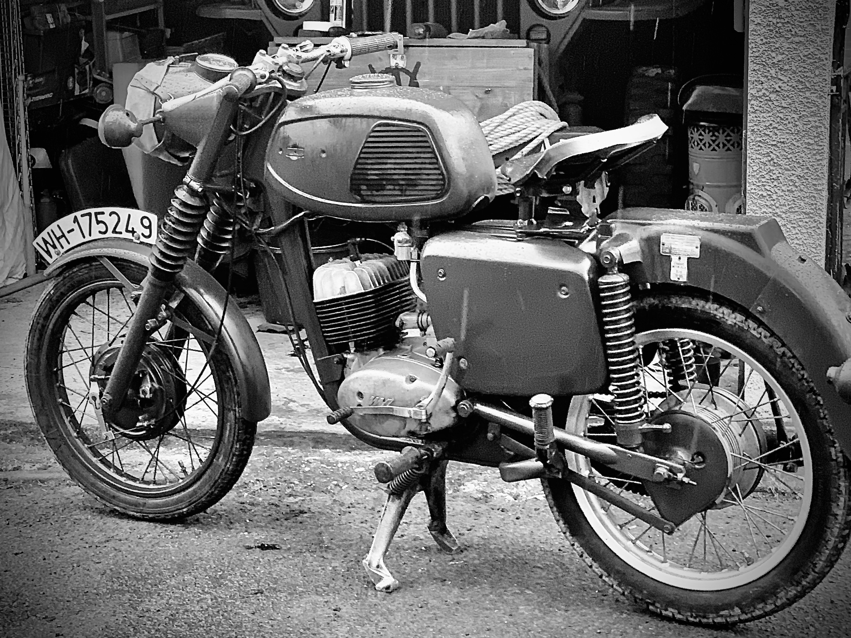

by Gerryman Ts125 » Wed Nov 24, 2021 2:58 pm
standard silver Nickel, TS exhaust. Maybe your has been painted. Should affect the performance. See you have a non Mz front hub. Is it Japanese. Maybe more shoe surface and a much better and thicker lever/cable size at the shoe end. Or is it a dual linked lever. As I cannot see it.

by AndyP66 » Wed Nov 24, 2021 3:12 pm
I understand the front wheel is a complete Honda one. I believe it does give better braking. I do have the original TS one which I will be selling if anyone needs one.
The exhaust was already painted black when I got the bike. I also think the handle bars are different too.
I will be honest and I know it may upset some people on here, yet the plan is to paint the bike WW2 German grey and make it look a little older than it is. I want to change the handle bars to a wider set if possible and change the seat to a single one, if that’s possible also. Then have a paneer rack for the back to go over the rear wheel arch.

by Gerryman Ts125 » Wed Nov 24, 2021 3:25 pm
Do as you please , I don't know if any Mz owners on this forum are purist's. ( I'm not) With a Mzs of any type, you just use what's handy or availble.
I have used lots of parts on my Mzs (don't have one now) that Mz never sold (mostly Japanese) So whatever you do should be suitable to you. As it's yours.

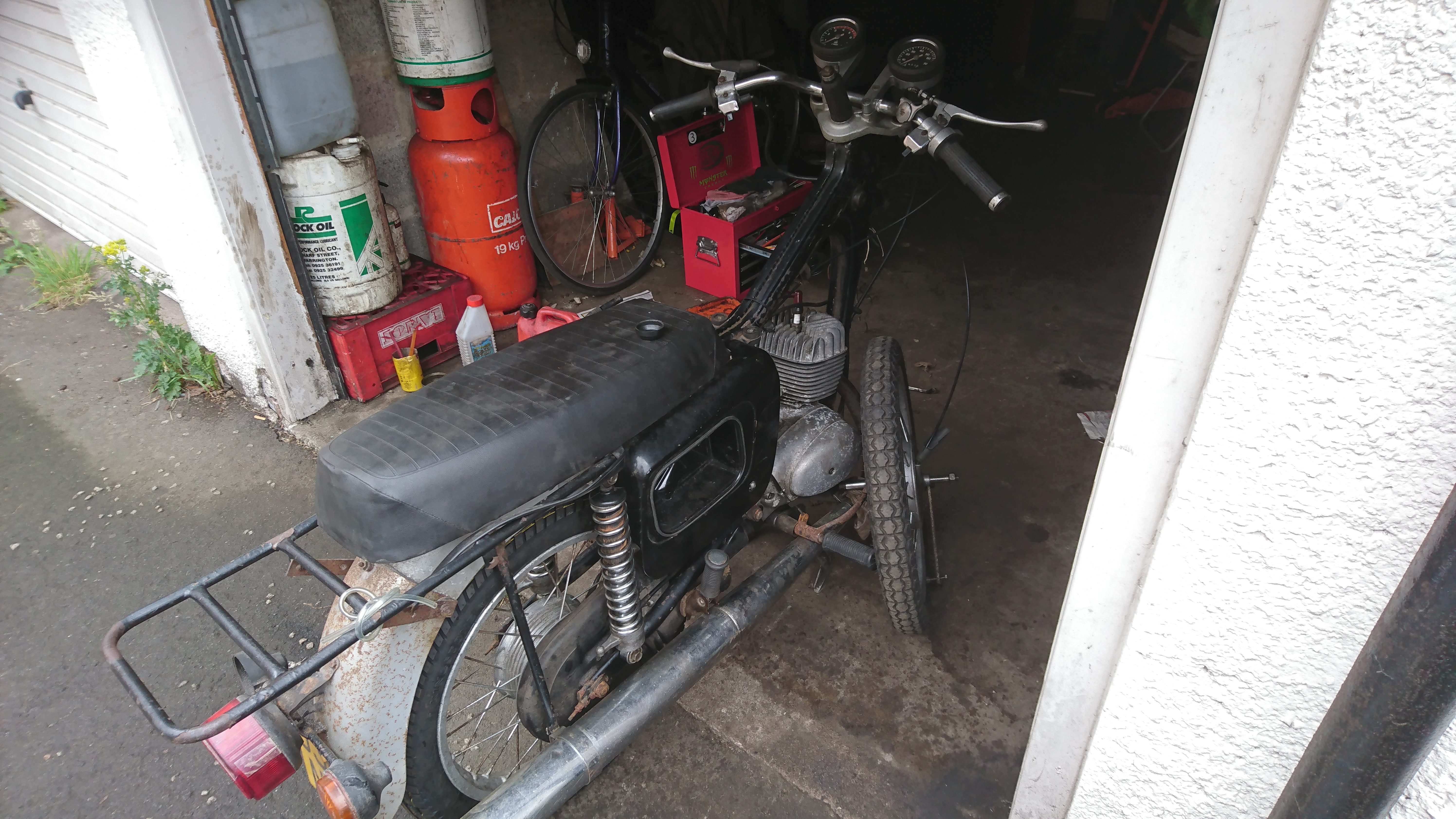

by AndyP66 » Sun Mar 27, 2022 3:50 pm
Firstly, the transformation is almost complete as you can see from the picture below.
But I do need to replace the clutch cable and possibly the throttle cable. Can anyone point me the right direction to purchase these.

by Gerryman Ts125 » Tue Mar 29, 2022 8:59 am
Clutch cables your on your own. They (TS 125 - 150 clutch cables) can be sourced on eboo or Amazonian.
As for throttle cables. I purchased a cheap cable off on eboo. It cost me £1:75 Inc p&p. I had to drill the original throttle housing (used a 6mm then 8mm drill to widen the slot the original cable went through) then tapped it. So I could take up the slack. The other end fitted straight into the carb and it worked grand. And I could adjust it at both ends. It was for a mini Moto.
