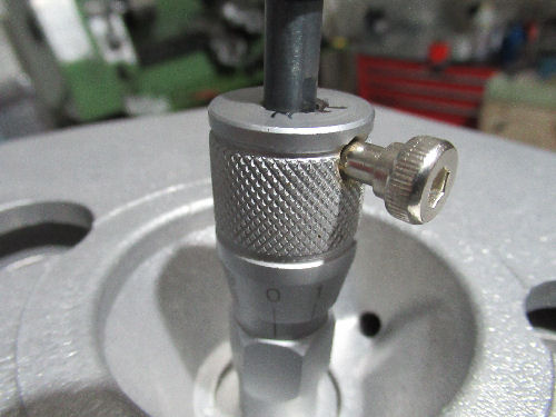

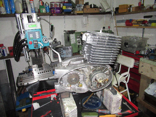

The engine is now together and I am just determining that the compression ratio is correct using the solder method and setting the timing. I have one of the micrometre type thingamabobs with the rod down the middle but I had to make a new rod as the original was to short and didn't touch the piston at all.
The rod I made has a flat milled along its length and is hardened silver steel ,so that the brass tipped grub screw can be nipped just hard enough to slide up as the piston goes over TDC and not drop back down, then nipped much tighter and the micrometre turned down the 2.5 - 3mm to stop the piston as usual. I think this will be ok as the rod should give a perfect TDS position.

Puffs wrote:Micrometer or a calliper? I guess the latter. Anyway, no comprende, señor, don't quite understand what you're describing - pic maybe?
Straight forward enough to me. What mick is describing is an adjustable piston stop.

Postby mick » Tue Feb 14, 2023 2:47 pm
That's right.
The micrometre head has a M14 plug thread with a plunger through the middle to reach down to the piston, so it can move up to find TDC. The problem with mine is that the rod did not reach down enough so I made my own and included a flat, then I hardened the rod as it is silver steel so the new brass tip grub screw (not shown) can slide without dropping metal swarf into the engine. If the rod is just nipped enough to stop it falling down as the piston goes over TDC it can be tightened more and the micrometre head turned down 3mm. When the piston is brought gently back up to the stop it should be spot on.
Hopefully !!
