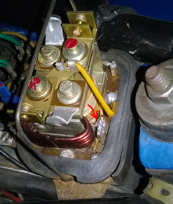

Measuring on the regulator (see Fig. 6.3 in the Haynes manual), I had 14.3V from the rectifier, on pole D+, while pole 51 (which connects to the battery, un-fused) reads the much lower battery voltage. After I took off the regulator's cap, and sure enough, that same connection again had free play:
Poor connection in ETZ regulator.jpg (48.79 KiB) Viewed 370 times
Measuring while pushing the wire into the connection gives 14.3V, also on pole 51.

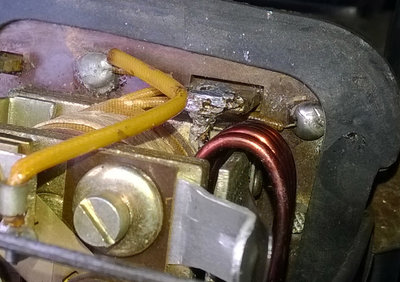

I had soldered this connection before, but I cannot solder it properly, as I cannot get it warm enough: the pole drains too much heat from my soldering iron. Last time I soldered it, it kept for the summer. Maybe if I take the regulator off the bike, shield parts & use a flame it could work, but I haven't done that. Shielding the rest properly from a flame seems difficult.
Instead, after isolating the battery, I wound some copper wire around the coil end, and knotted that to the pole. Thereafter covered the lot as good as I could with fresh solder. It does make an electrical connection, but it hasn't flowed well.
Poor connection in ETZ regulator - re-soldered.jpg (39.6 KiB) Viewed 370 times

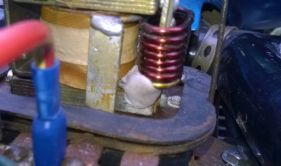

Anyway, I think the real problem is not in the soldering, but rather that the heavy coil is being fixated by that soldered connection. And that the coil vibrates. So I fixated the coil, at the other side, with some epoxy clay:
Poor connection in ETZ regulator - coil fixate.jpg (29.32 KiB) Viewed 370 times
Hope it keeps a bit longer now.

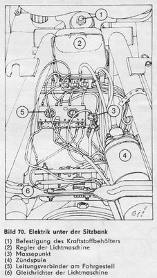

Maybe I attached the regulator the wrong way, to directly & to 'hard' to the frame, and thereby caused the vibration failure myself. I do not have any special parts for that attachment, and on the left side it is in rubber, but the right side is just screwed. I have no idea how it was originally.
Does anyone have a picture showing the original mounting method? This does not really show it.

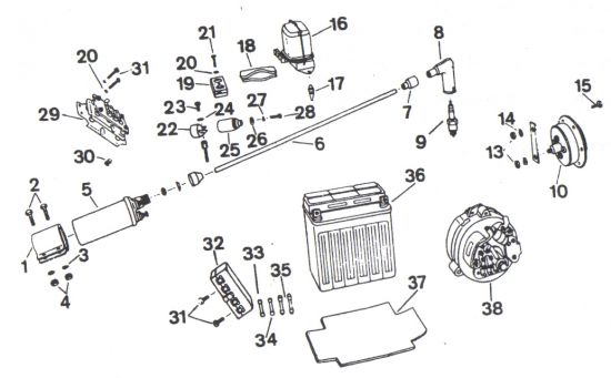

Postby dave47 » Fri Oct 11, 2019 3:50 am
It definitely shouldnt be rigidly mounted. I replaced mine with an electronic one years ago, but as far as I remember it was fixed on the right side with a rubber "shock absorber" similar to that at the bottom of the rectifier. At the left side it was in a foam rubber sleeve.
Edit: It is part no. 30-34.037 Fastening rubber for regulator cut-out.

Postby Puffs » Fri Oct 11, 2019 5:06 am
Thanks for putting me on track Dave!
While Guesi indicates that part for mounting the flasher relay, I can see how that would work. And I now also find his picture:
It's gizmo #17 & #18.
I resurrected this bike in the winter '17-'18 and indeed the remnants of #18 might have been there, but perished. That side now is in rubber, that's OK, but instead of #17 it has a bolt to the lip on the frame - to be updated.

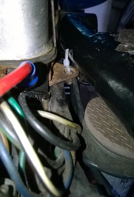

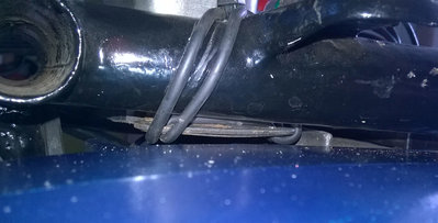

For the record, here's how the left side of the regulator is/was attached, seen from above:
LH regulator, from above.jpg (34.28 KiB) Viewed 370 times
A large 'O'-ring runs through those holes, on the top side of the regulator base, and is knotted together on top with a zip tie. From below it looks like this:
LH regulator.jpg (22.25 KiB) Viewed 370 times

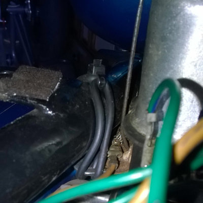

And on the RH side, as follows:
RH regulator + flasher relay.jpg (31.69 KiB) Viewed 370 times
I replaced the bolt I had before (see the lower RH corner in download/file.php?id=5325&mode=view ) by a little zip tie, and ran the 'O'-ring (which I use to flexibly hang the flasher relay) between the regulator base & the frame lug. Previously that side was hard.
Now the regulator is quite flexibly mounted. If I still get problems, I'll post them - but I suspect this solves it.
