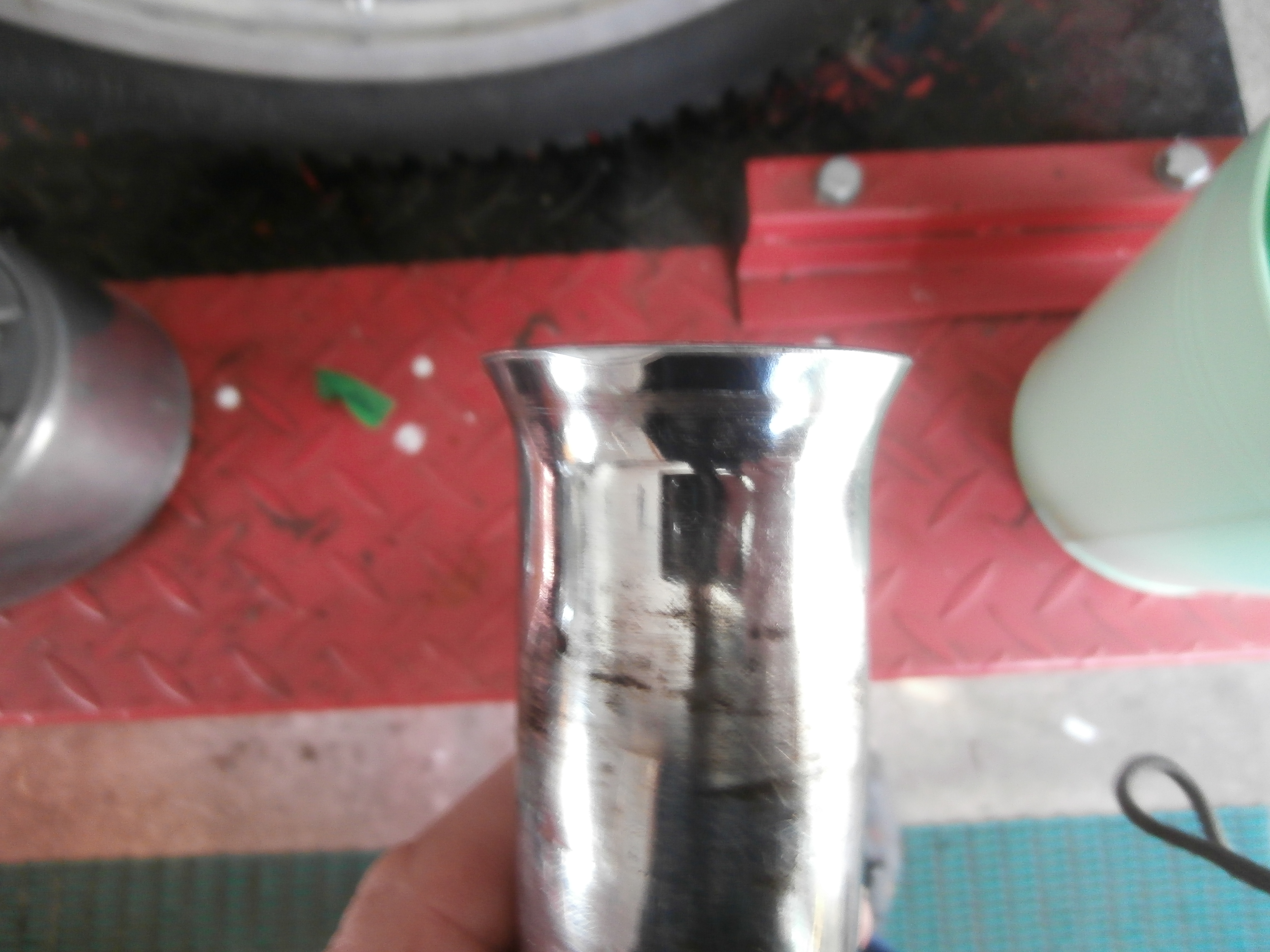

Postby Guesi » Tue Mar 22, 2022 12:05 am
If you could post a picture I could tell you if your collar is ETZ or TS.
Is the downpipe original or reproduction ?

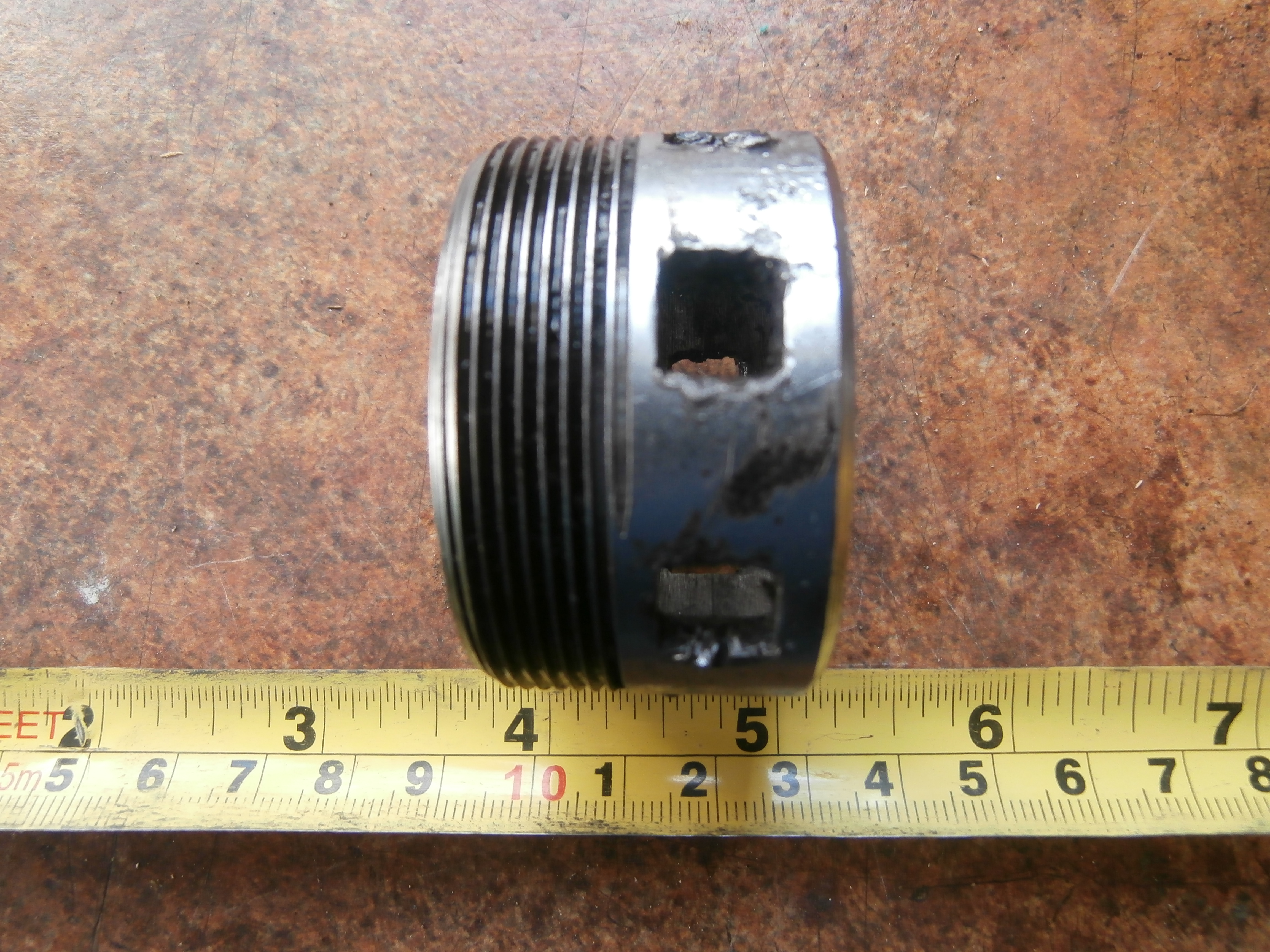

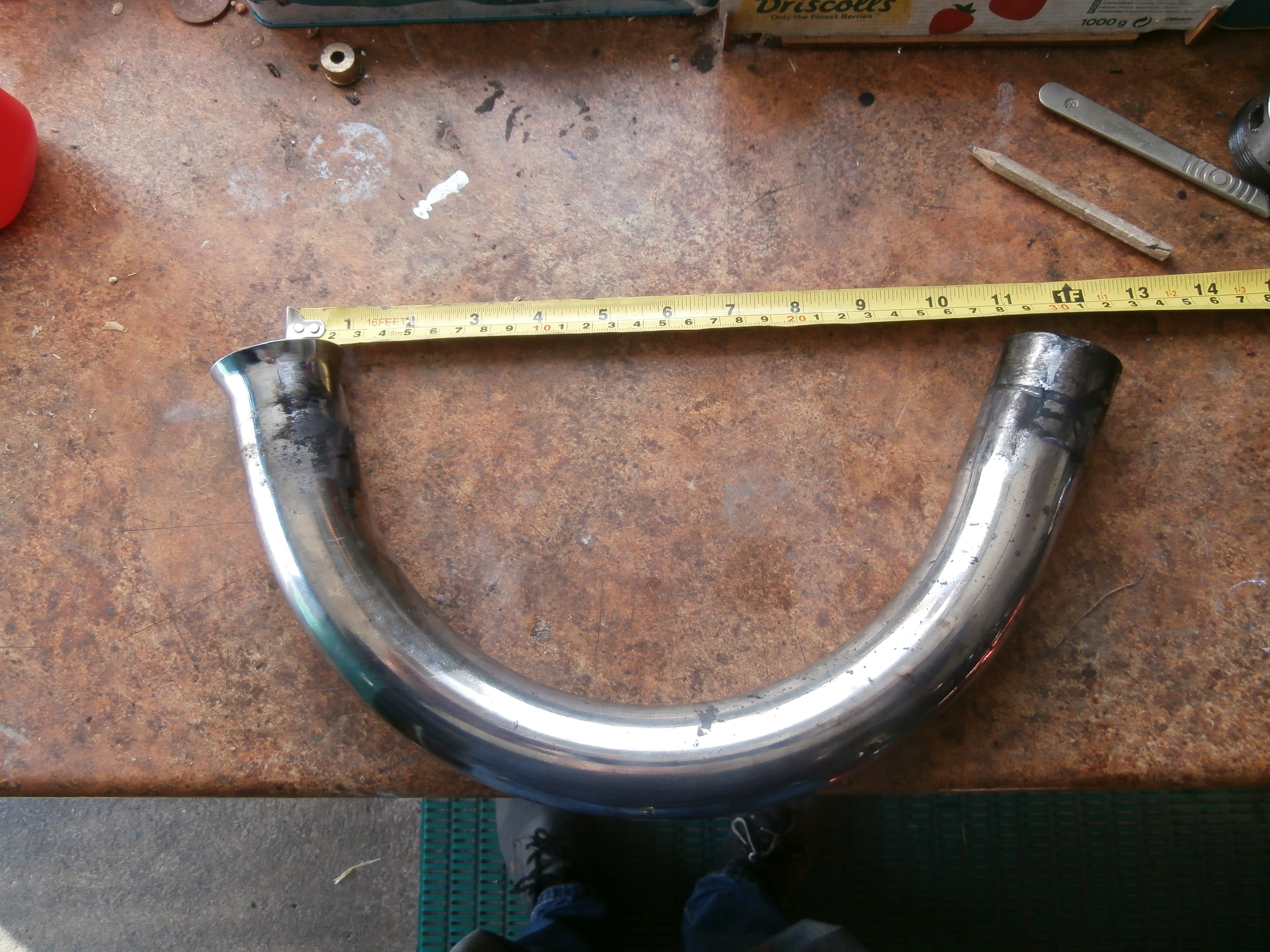

Postby Andy_C » Tue Mar 22, 2022 3:16 pm
Pictures.....

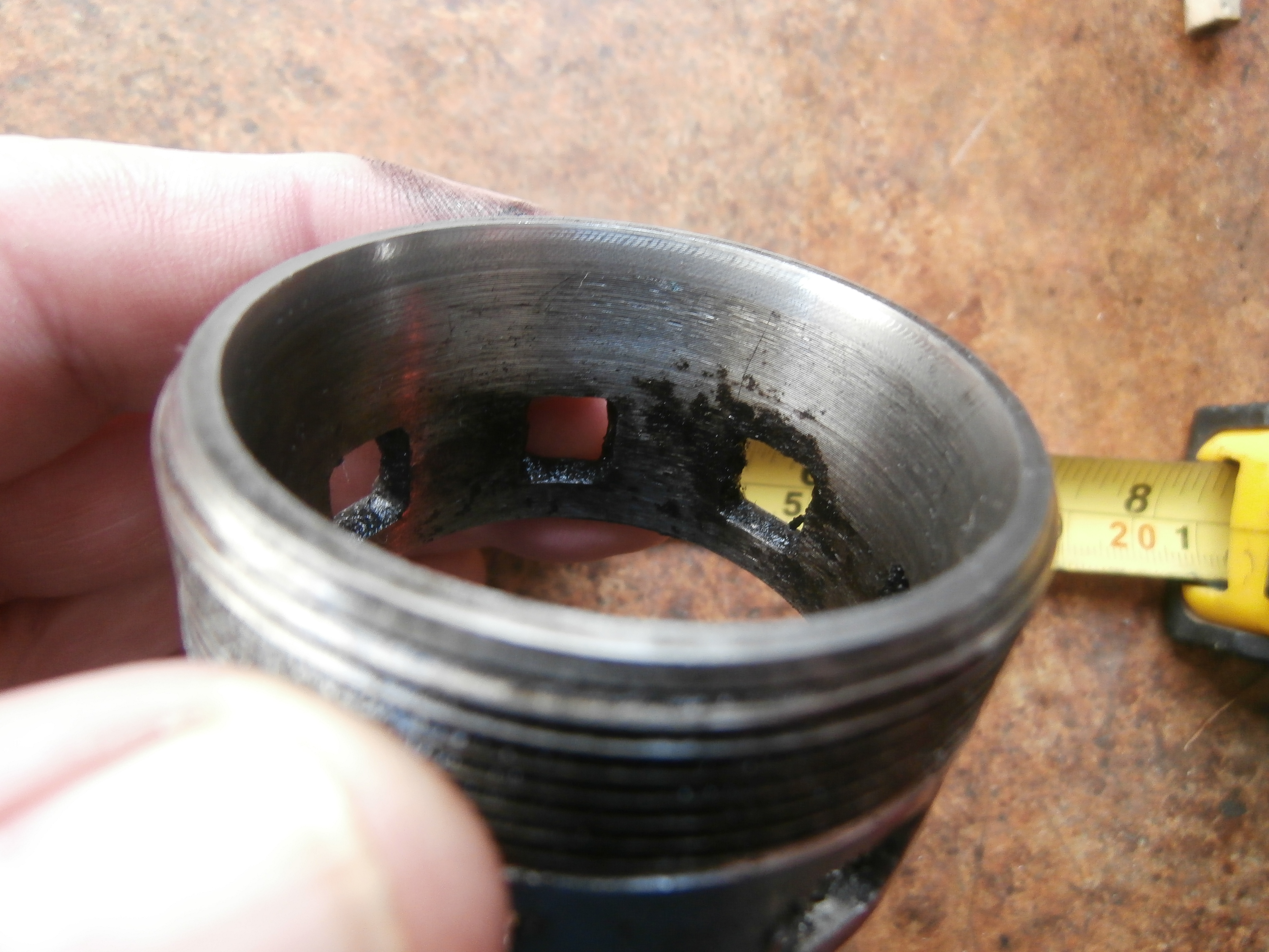

Postby Andy_C » Tue Mar 22, 2022 3:17 pm
And...

Postby Guesi » Tue Mar 22, 2022 3:38 pm
You have a TS 250 collar.
The ETz 250 is longer.

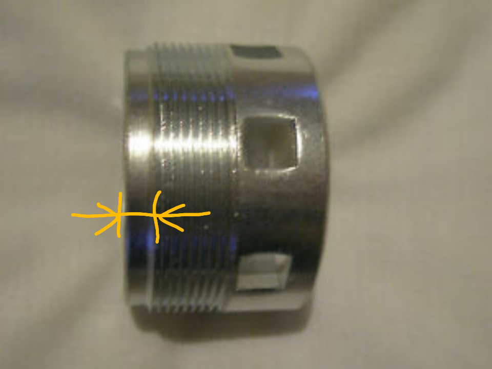

Postby Kruh » Wed Mar 23, 2022 4:34 am
That collar does not look right. There should be more material sticking out past the treads.
That one looks like its been shortened.
Or is this a difference between Ts 250 ans 250/1 collars?
On my TS/1 it looks like the one in this the picture:
