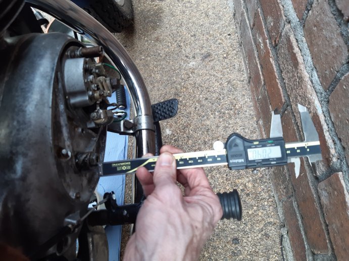

I have measured the travel of the actuator rod and it is just 1.2mm.
Does this sound enough?

I am seeing about 18mm of cable pull which sounds on a par with Puff's ETZ.
But I agree this doesn't translate into much motion at the clutch with just 1.2mm of throw.
It's almost like the lever is too long at the clutch end.

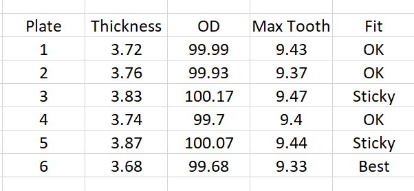

I have pulled the clutch plates and measured the thicknesses, and also tried to measure the OD and the length of the engagement teeth.
Then I tried each plate on its own to see how freely it moved in the basket.
The results were..............
There seems to be a correlation between the larger diameter OD and the sticking plates.
In addition I checked each tooth on the plates in the basket slots individually, and they seem OK.
However the other observation is that the sticking plates were much worse at the outer end of the basket.
All the plates were free to slide further into the basket, but some became tight as I pulled them out.
I think this suggests that the basket is very slightly conical, causing some plates to be tight towards the outer edge.
However the other obvious thing is that all the plates are above the thickness tolerance given by Puffs.
My options are to rebuild the clutch selecting their positions according to their OD, with the larger ones closer to the inside where things are a looser fit.
I may do this and re-observe the clutch motion to see it is is improved. This will cost me nothing but some time.
I guess another approach might be to file diameter of the sticking plates to make them a looser fit?
I expect I will end up renewing the plates anyway - but it would be nice to prove if everything else is OK or not.

Interesting outcome and conclusion. I would indeed try placing the larger discs where they are most free and go from there. 8)
