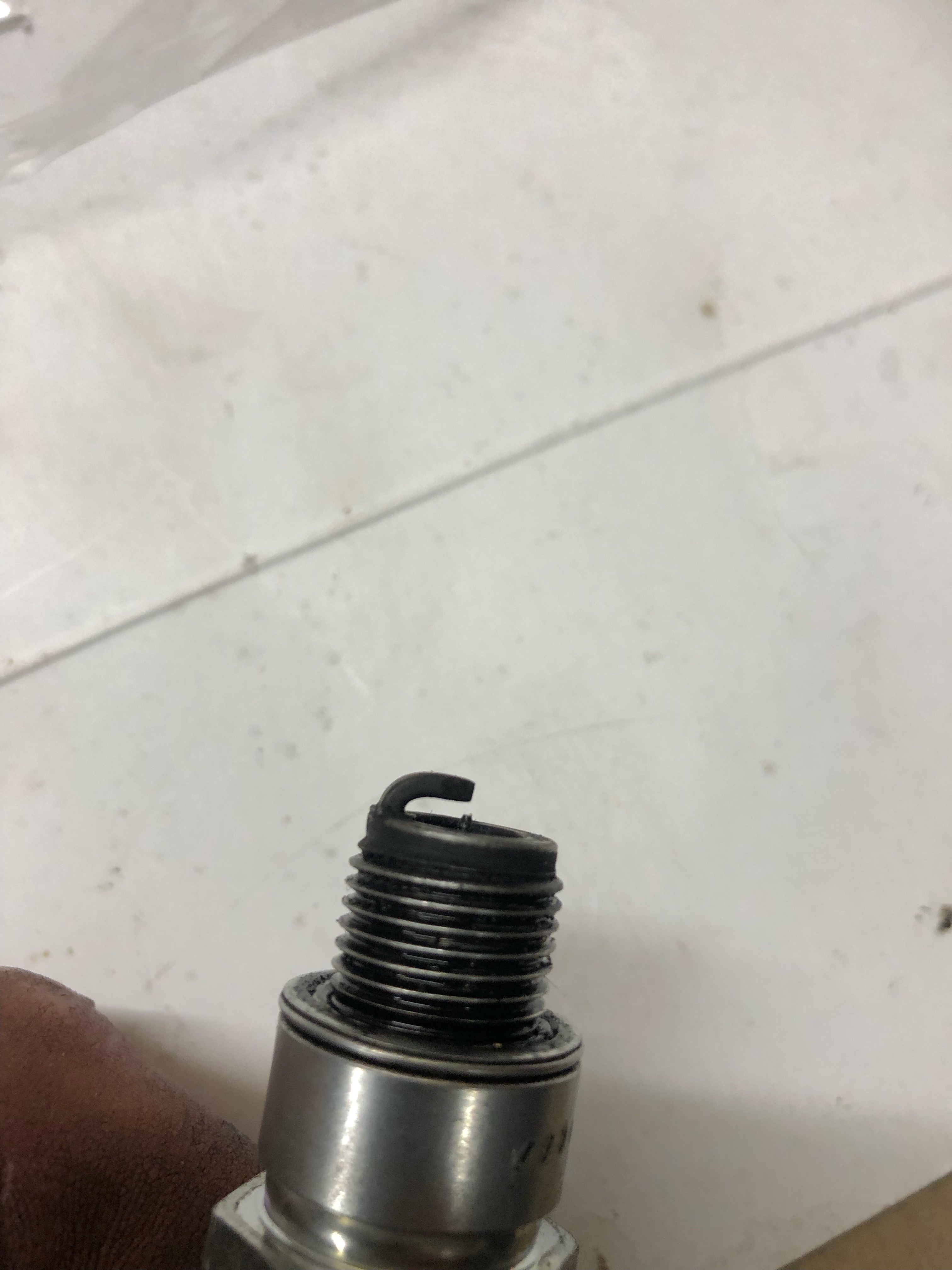

So pleased to have the electrics sorted;I thought test ride time and sort the fuelling issue; the bike would not start, went through the fuelling side and no problems, so pulled the plug to check for a spark. The plug has virtually no electrode and what was left of it looked like the end of a needle, I've never seen a plug like this before, obviously there was no spark either.
So I put another plug in and still no spark, checked the plug gap it's ok, checked points and they were tight so reset gap to spec, battery fully charged and still no spark. I guess condenser and coil to look at next but the state of the plug is a concern and what would cause it?
Engine has less than 200 miles on it since the previous owner had a full rebuild done by Burwins so should be all good.
So any ideas as to why no spark and what would cause the plug issue?

Duff plug, not unknown, I now use Brisk plugs from F2 in Wisbech.?

Just been to the bike shop for a new plug and yes indeed they confirmed that plug is meant to be like that, every days a school day. Anyway got a couple of new standard plugs fitted one and still no spark. I have a spark at the points but not the plug so guessing coil or condenser to look at next, the new plug is a BR8H so has a resistor, I have a spare lead and cap ill try next.

The fitting of an iridium plug might suggest the previous owner had starting issues, as it is superior to the standard plug. Its probably worth refitting if its the correct heat range, 7 or 8 ngk. I have one in my etz.

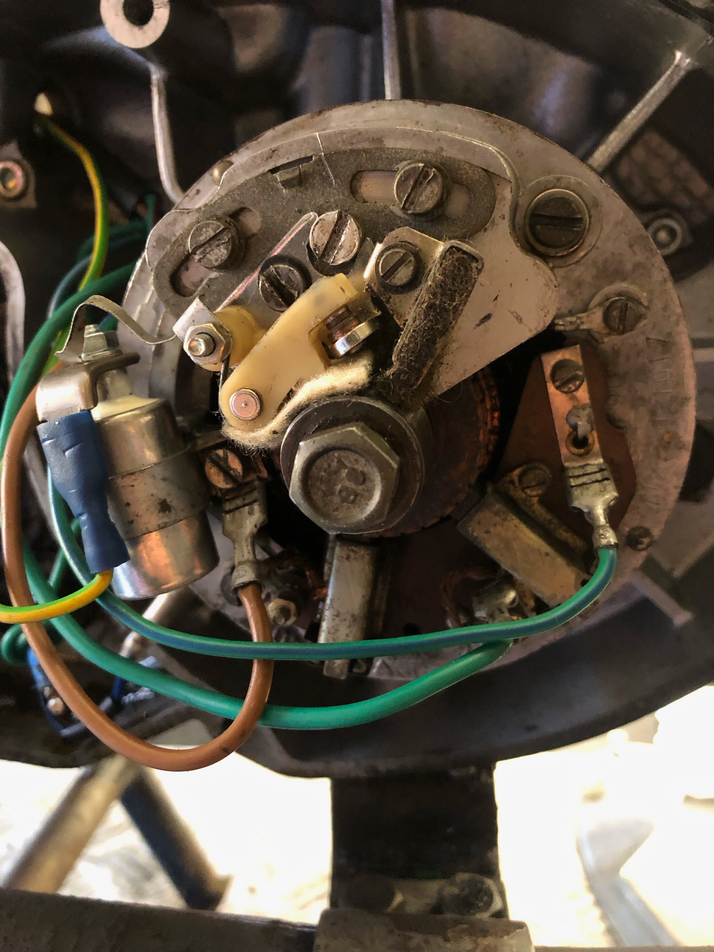

Postby ScotBob » Tue Nov 29, 2022 9:39 am
Hi All,
This is doing my head in: So Far;
Timing and points set ok, small spark at the points when opened manually, points good with no pitting
New Coil
New condenser
New Spark Plug
New Cap and HT lead
Battery fully charged
Continuity on all cables from points and generator to their respective connections and onwards as per the wiring diagram
6 volts at the coil from the ignition switch
All wiring and components check out and working as they should
BUT STILL NO SPARK!!!!!
So guessing it didn't need any of the new bits as they've made no difference, it has to be something simple, so what am I missing? I did get one spark after fitting new bits but that was it, one spark then no more! so thinking possibly a loose connection somewhere but can't find any and as mentioned continuity is good on all wiring. What am I missing here?
Anything look wrong with this pic?
Any suggestions greatly appreciated.
ScotBob
Posts: 73

Postby ScotBob » Tue Nov 29, 2022 12:03 pm
Yes points wire should be green but for some reason previous owner has replaced it with a new wire. The existing wire is still there with connectors. Looks like it was changed with a new wire to wire in a Gammatronix Spark Assist that had different connectors. The spark assist is still in situ but not wired in.
ScotBob
