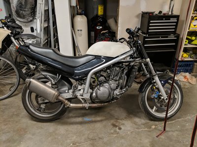

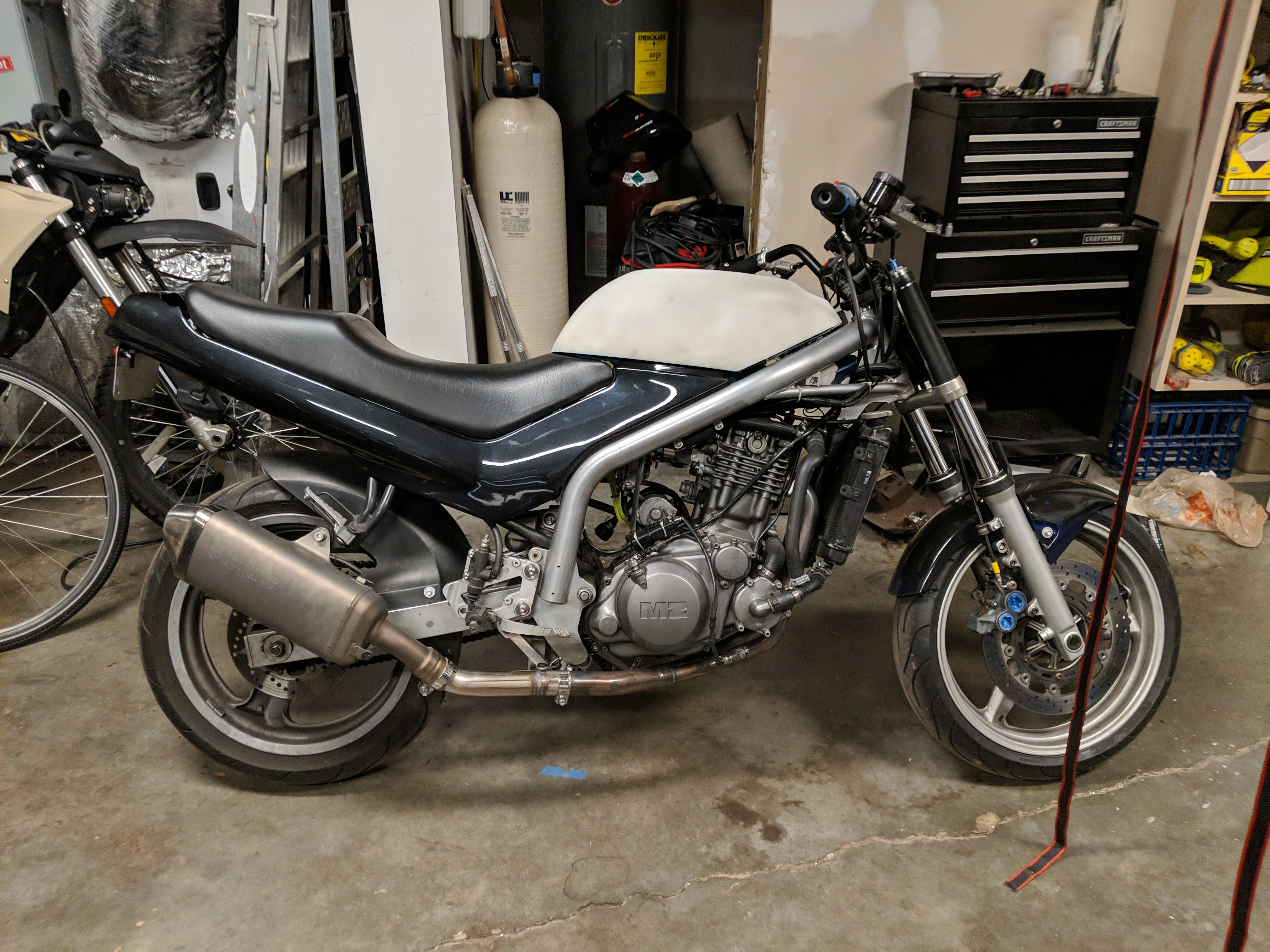

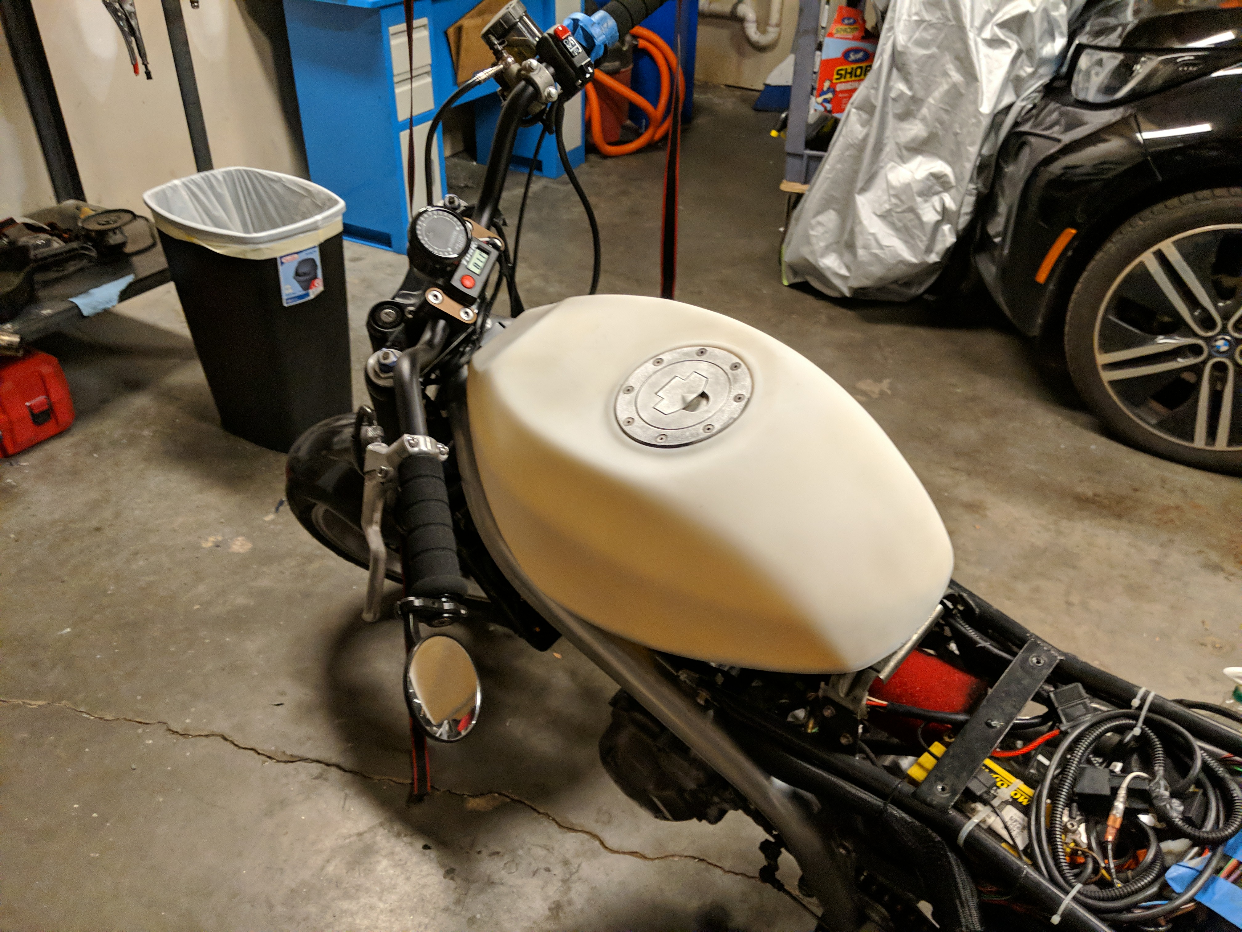

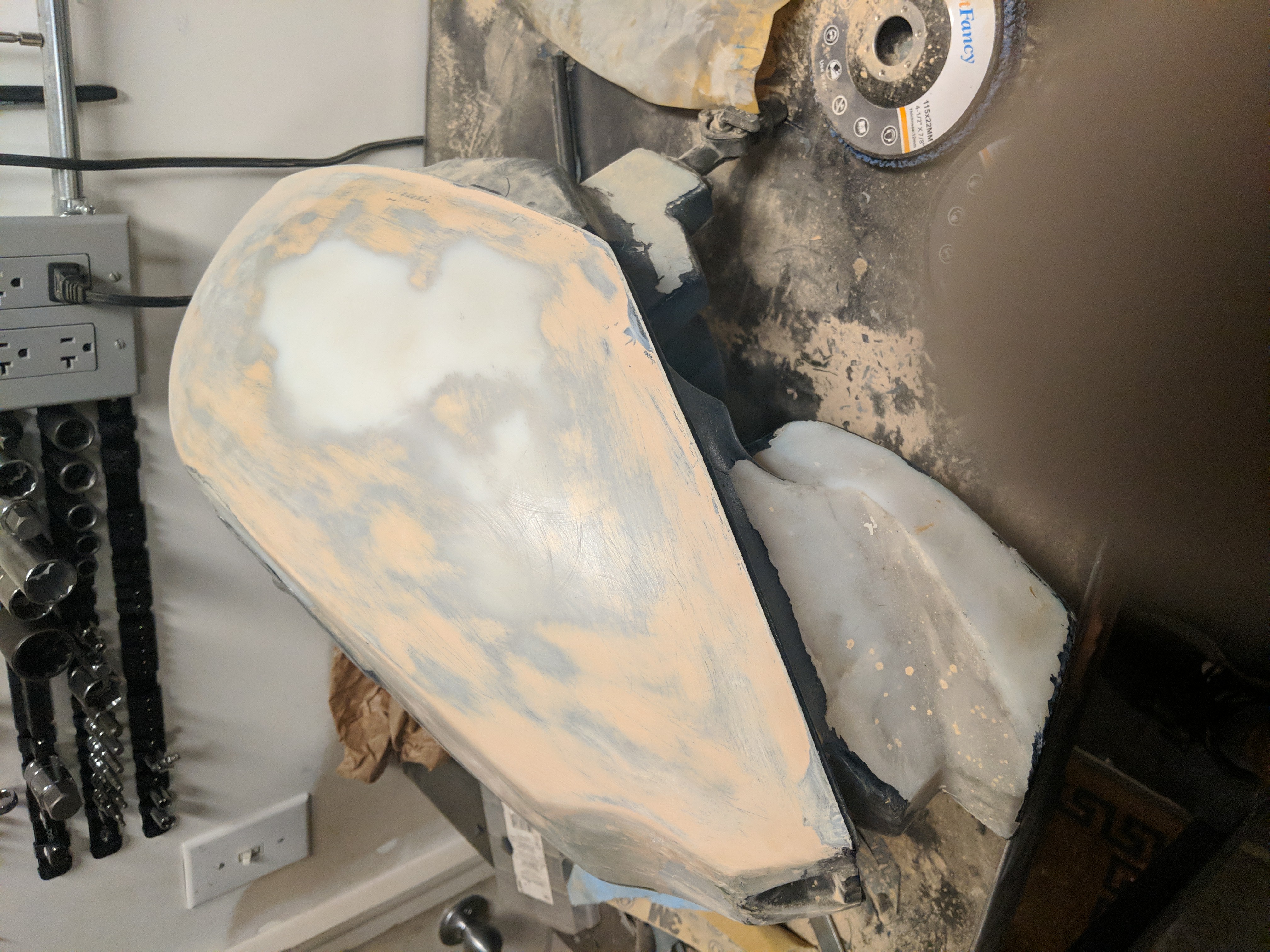

I have been doing some cosmetic stuff the last couple of days. Been stripping the paint off the tank and wet sanding it. I think the natural plastic is going to look great. Also, drained of fuel this tank is SO light. Its fantastic. And made by Acerbis actually.

... and you can more easily see how much fuel you have.
Over the years Acerbis made a name for quality. But avoid parking it out in the sunshine, as UV oxidises plastics.

Postby jpmsteadi » Thu Sep 10, 2020 6:31 am
Puffs wrote:... and you can more easily see how much fuel you have.
Yup! I got really used to being able to see how much fuel is in my DR650 with the natural plastic tank. And all my bikes live in the garage. If it does yellow some in the sun can just restore it again (to a certain extent)

Postby breakwellmz » Sat Sep 12, 2020 2:02 am
I didn`t realise Skorpions had plastic tanks. It must be some impressive paint used at the factory to get the finish they had. I quite like the look you`ve achieved by removing the paint though and that you can see the fuel level.
