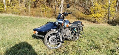

Postby breakwellmz » Mon Nov 16, 2020 5:26 am
Nice outfit front end. Adds rigidity and reduces trail, very neat -

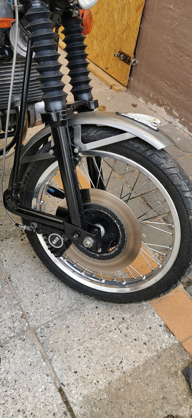

Postby breakwellmz » Mon Nov 16, 2020 8:06 am
Hence the title.
Yes, less trail is needed on an outfit.

Postby Puffs » Mon Nov 16, 2020 11:07 am
Thank you for your kind explanation. Yes, I see why that sideways pull makes you want 0 trail. So commonly you see swingarms in combination with a sidecar:
So that's a normal shock absorber inside a swingarm, not telescopic forks with a brace added and a special swingarm contraption with 2 hinge points added. Anyway, it's your show.
David, I'd be slightly surprised if your 1960's BMW R50S has front like that, this would be more common: Image
Conventional, not telescopic with a brace.
To each his own.
